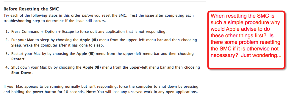

I noticed your signature type notes in your reply... I clicked on the reset your SMC and learned something else. Thanks. By the way, take a look at my screen shot and give me an opinion if you have one. Thanks for your time.

Resetting the SMC is not a cure-all. Sometimes just rebooting helps. My guess is that they are just trying to go in a logical progression.
