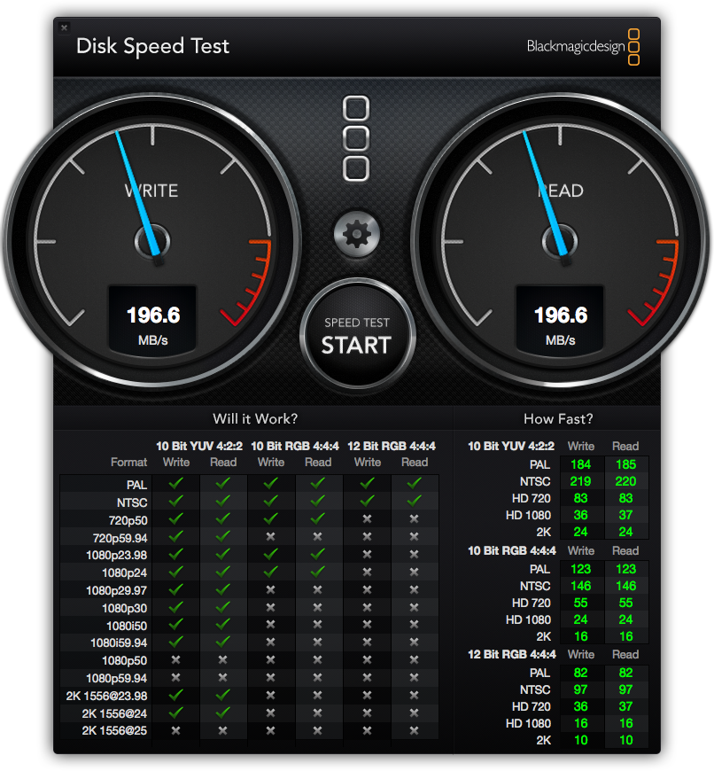

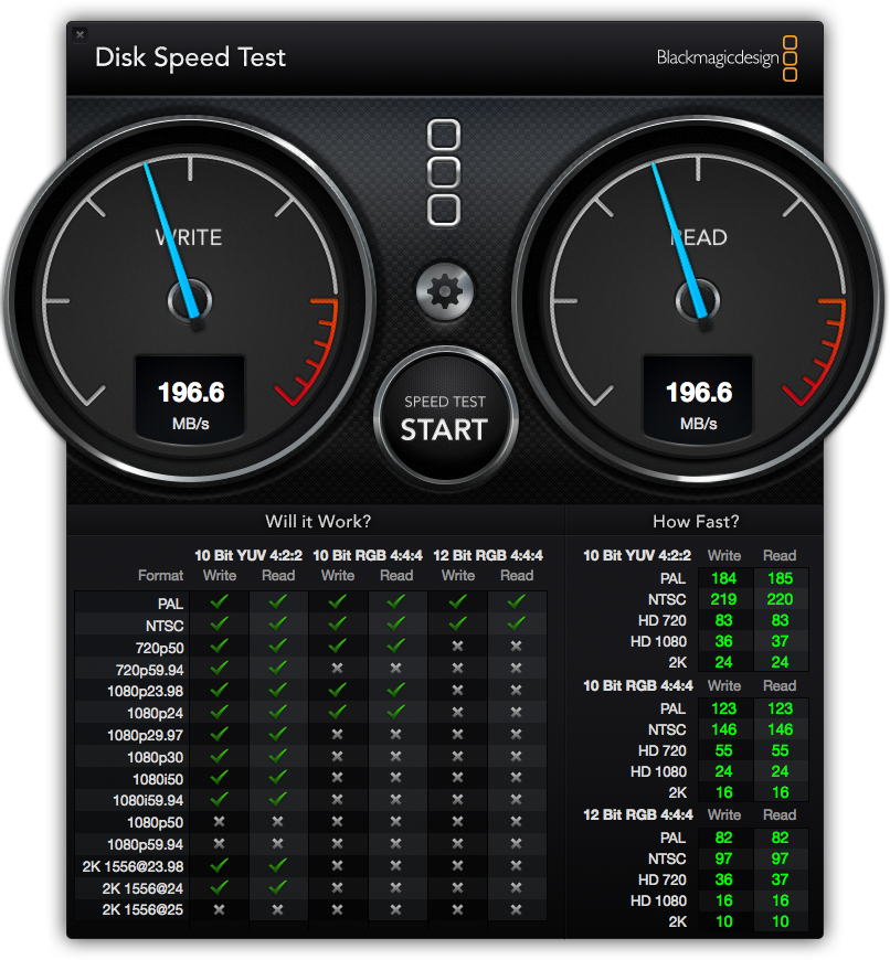

I've used Black Magic to confirm speeds, but just using the drive browsing through files, it feels very sluggish. I've reconnected it with Firewire and browsing through the same folders went much smoother.
I'm at work right now, but when I get home I'll post the screenshots I took from Black Magic.
As promised here's the black magic test with eSata:
An here's the test with a Firewire 800 connection:
The results are almost identical. Sadly I can't test the disk anymore with a PC because I sold it last year. My mind is made up, the hub goes back to LaCie.
test the hub with a faster drive. that is not the correct drive to test that hub.. do you have access to a faster drive?
I have to agree. If you want to see faster performance, you could try setting up RAID-0 with the drives. IN RAID-1, you won;t be seeing any better performance.
