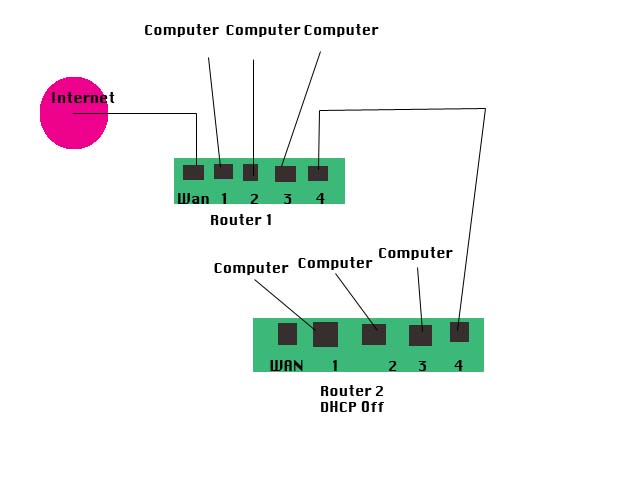

If you daisy chain 2 routers, you need to configure the second router to not do DHCP or firewall or anything, in otherwords, don't be a router.
Otherwise, it will interfere with accessing websites and DNS servers, and if it creates a second subnet within your house, it will interfer with printer sharing and filesharing between your Moms machine and the others.

Since you have 2 routers you could do this
Use the first router as usual and then connect the second router to the first router and turn off DHCP on the second router.

Well here is a diagram (I was bored)
