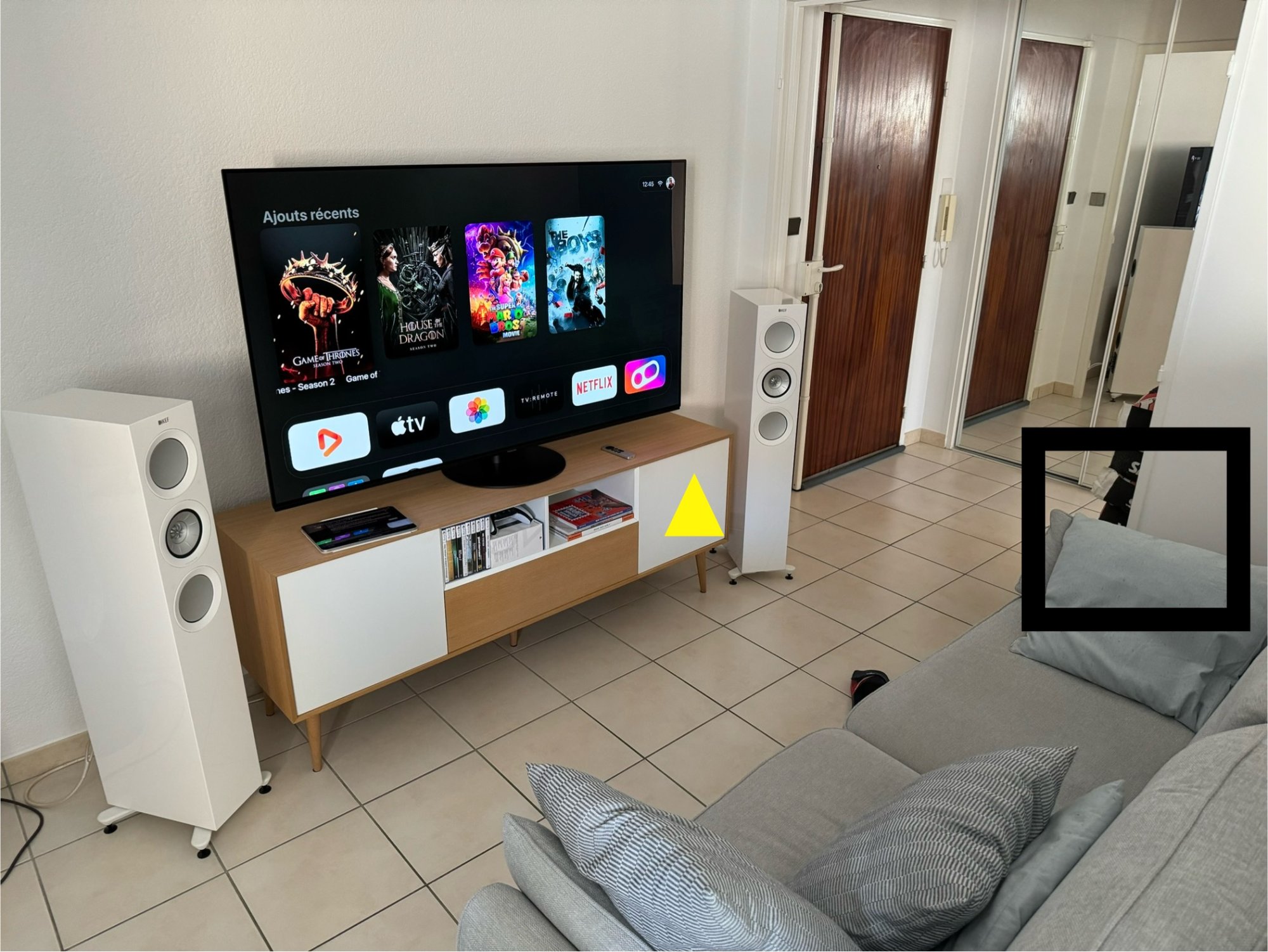

The router is next to the sofa, next to the optic fiber connection point. The sofa is in front of the TV. I need to move to optic fiber connection point next to the TV to have the router under the TV, where all elem of my setup are: TV, PS5, amplifier, Mac mini & Apple TV 4K.
I can connect the Apple TV via Ethernet but the cable will be in the middle of the room.
See the picture. Yellow triangle is mini & Apple TV and black rectangle is router, hidden under the sofa.

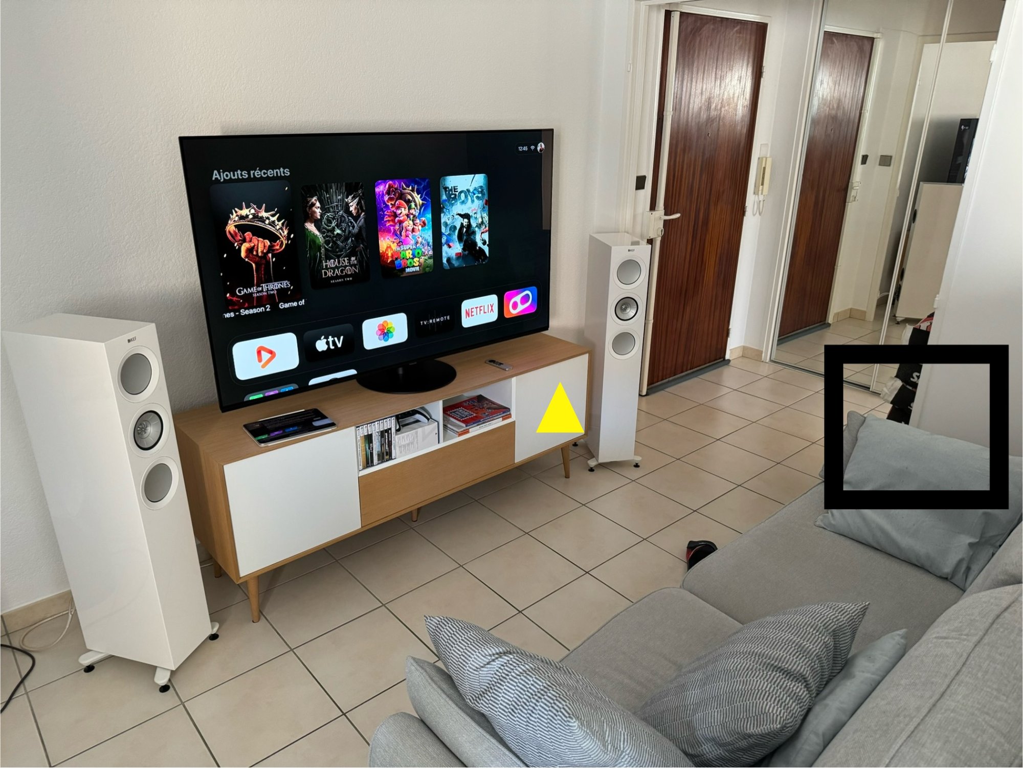

Apologies for the confusion. I’ll clarify.
I use a Mac mini to download Torrent files. I use an Apple TV with Infuse Pro to stream the files. I can use the Mac mini (both are connected to the TV) but it’s more convenient with Infuse Pro. I use Share folder on the Mac and SMB auto on Infuse Pro.
For larger files (30GB+, 4K HDR or DV content), there are lags and buffering icon.

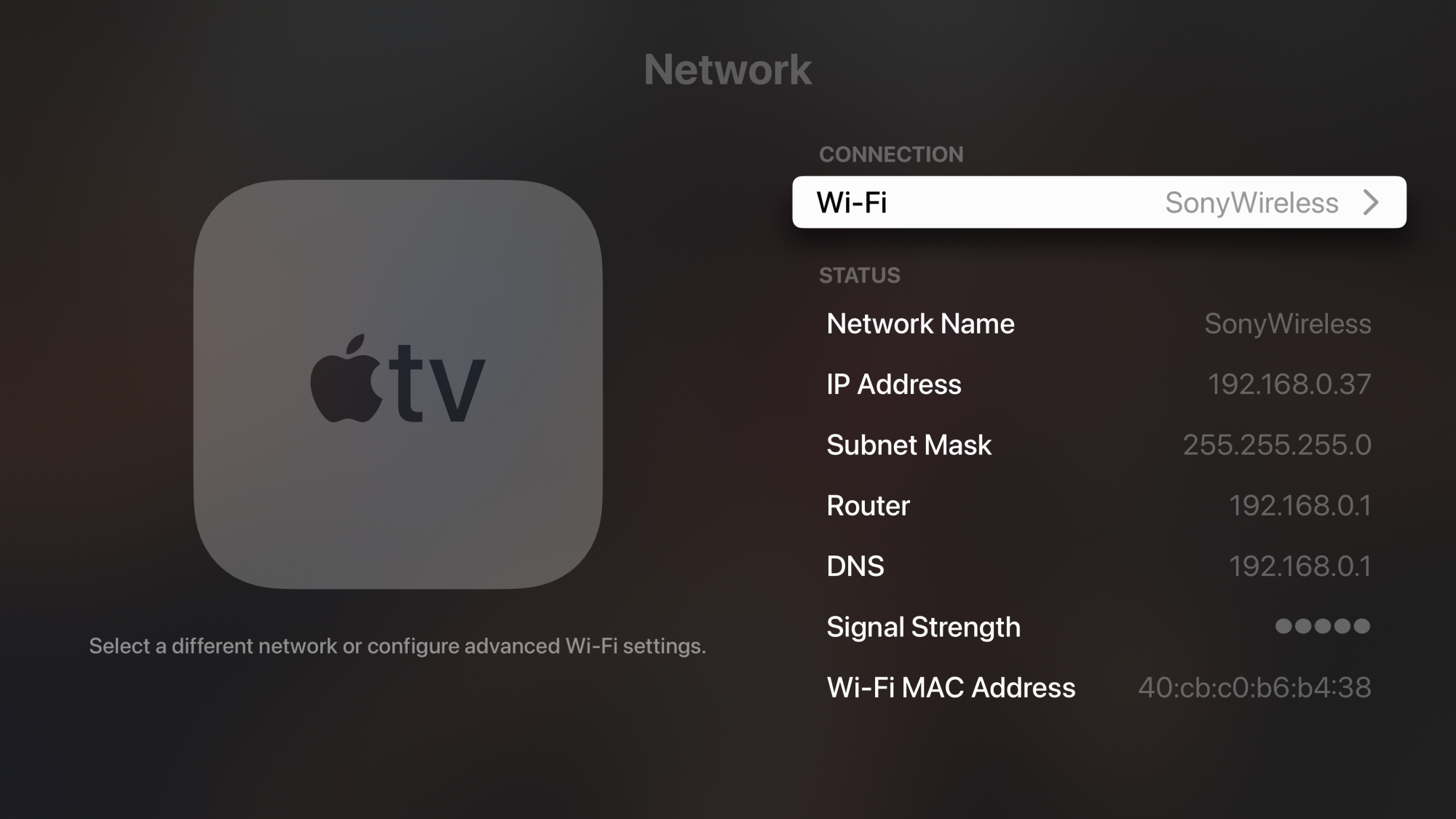

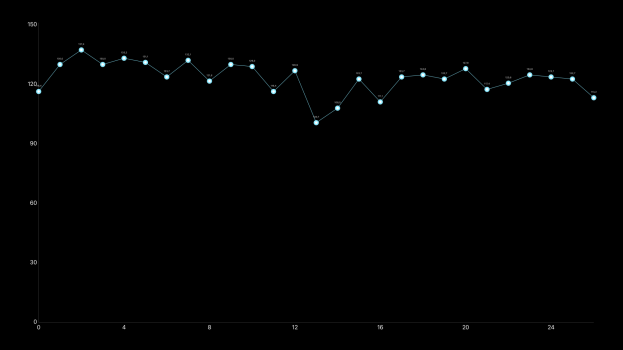

Also, there must be something wrong with your WiFi router, if the speeds you attain at such a short distance are so low.
On my aTV 4K 1st gen (2017), Infuse consistently achieves over 100Mbps. My router is the white tower Apple Airport Time Capsule (802.11ac):

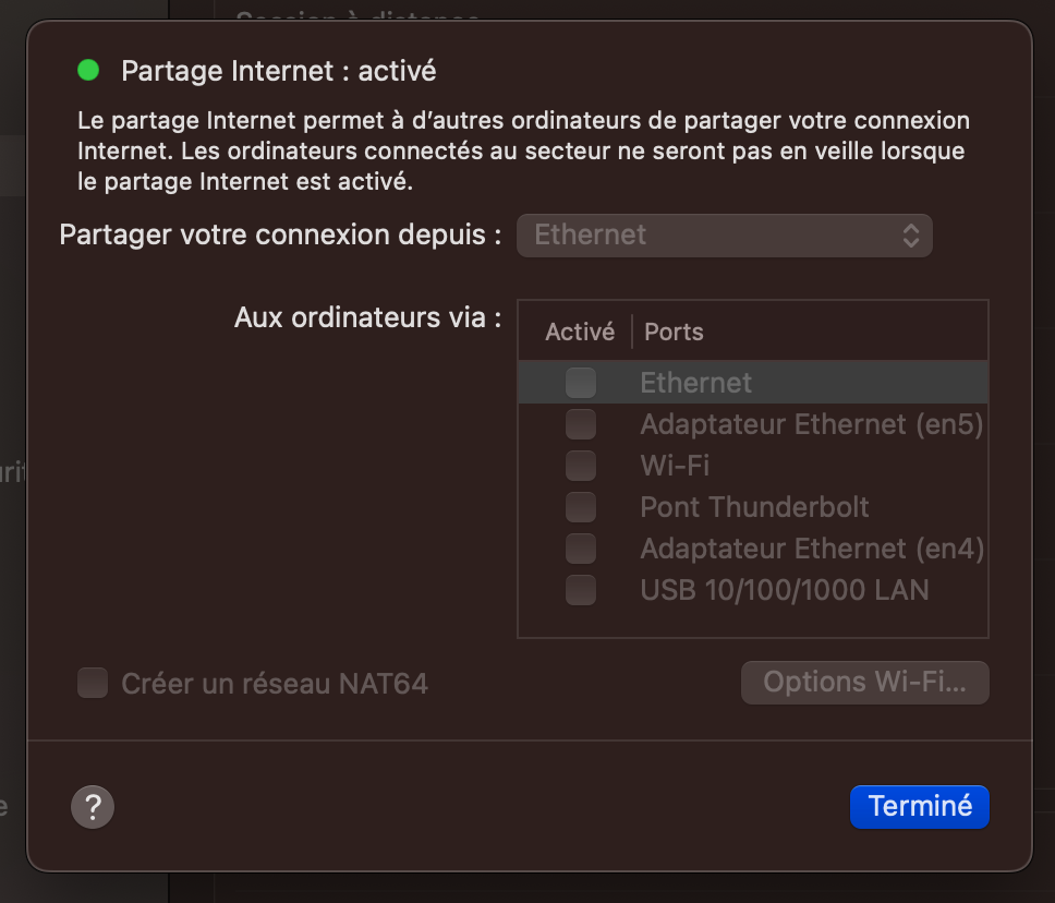

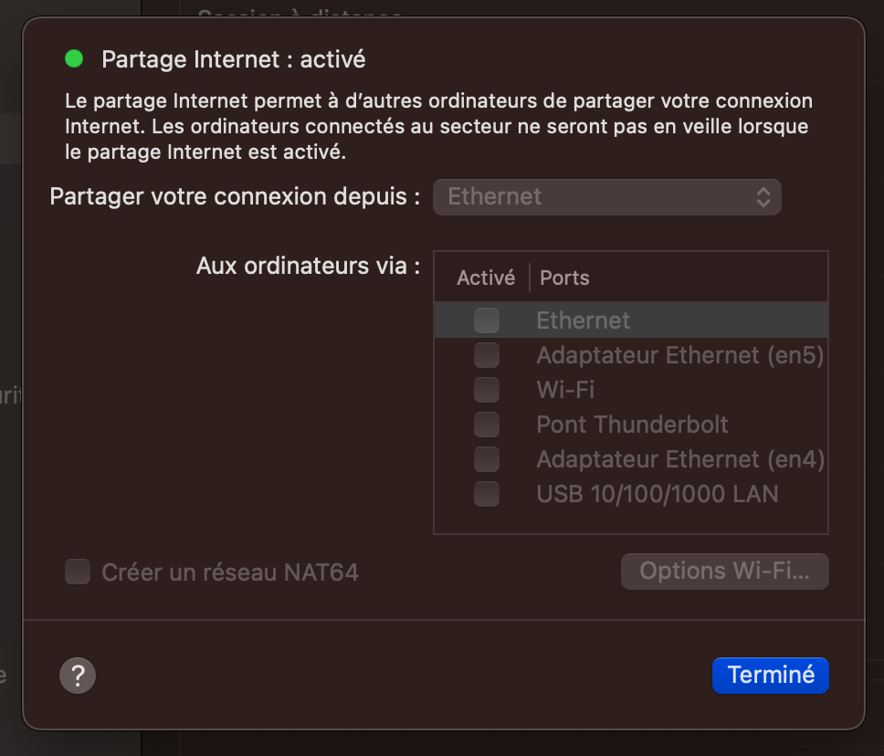

Thanks for the suggestion. The options are not available, is there a reason?

Thanks for the suggestion. The options are not available, is there a reason?View attachment 2396997
The connection you want to share is the Wifi connection (again, assuming the Mac Mini connects by Wifi to the Router) - »Partager voter connection depuis« -> click on "Ethernet" and select the Wifi connection. Then tick the »Activé«-checkbox for "Ethernet" in the list for »Aux ordinateurs via:« .
You seem to have an additional ethernet adapter (en5/en4) on the Mini. If the Apple TV is connected to any of these you can share the actual Etherner-connection by just checking the checkbox besides e.g. »Adaptateur Ethernet (en5)«. But maybe these just from some experimenting you did before(?)

The options are grey out. I can’t activate them. I am also surprised to see the adaptater (en5 and en4). No idea what it is.
I have only one thing connected to my Mac mini: a Rotel amplifier via USB. And the Apple TV connected via Ethernet to the mini. If I remove the Ethernet cable, options are still grey out.
EDIT: actually, to remove the grey out options, I needed to click first on the little i for information and then activate the internet sharing.
