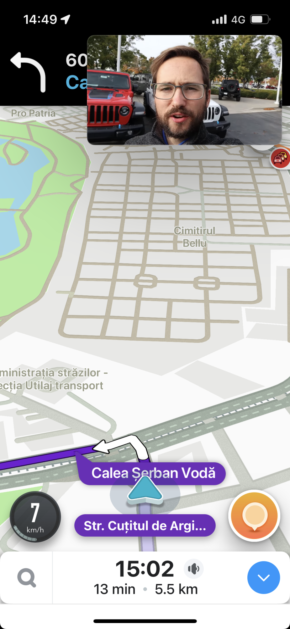

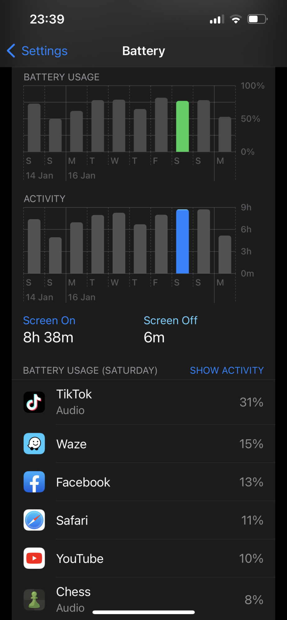

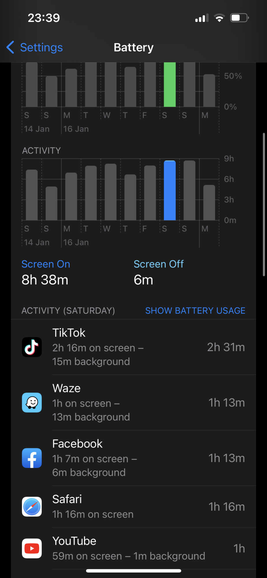

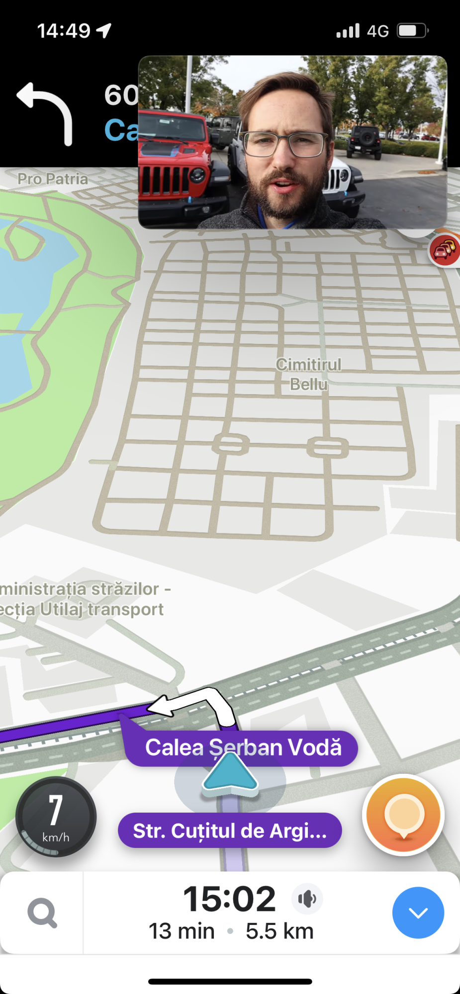

I remebered a few says ago about this trend and wanted to give it a try. So while i was using waze i started a PiP YouTube video and run it twice. So for about 30 minutes. After 15 minutes it was still cold. After 30 minutes i could feel it getting a bit warm near the top left side of the phone. I'm not an expert, but i dont think the issue is with YouTube or with the iPhone 14. I think the issue is in the iOS 16.
My device is iPhone 13 pro with iOS 15
