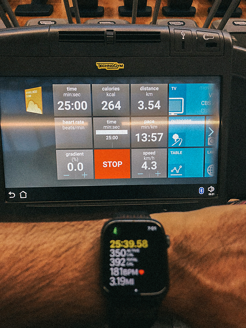

Day 2:
TechnoGYM: 264 Calories & Distance 3.54km (2.19 Miles)
AW4: 350 Calories & Distance 3.19 Miles (5.13 km)
Different between TechoGYM & AW4 86 Calories & Distance 1 Mile
Heart rate: 181BPM I'm within maximum heart rate zone for my age.
I'm not sure which method is far more accurate TechnoGYM or AW4 😕 1 mile extra that's big different!
Outdoor walking from home to GYM and GYM to home - 0.7 Miles which I've checked with the google map - they're correct distance, Indoor distance is wrong figure somewhat i guess maybe the next update 'watchOS 5.01' might fix issue?
My treadmill is old & clearly my S3 is more accurate (I know because I know my runs from outdoor), much more accurate.. like 2 km. more accurate. 😱
(And OS5 is also a bit more accurate than OS4)

yes, I think this technoGYM treadmill might be older model (need update firmware 😛) - "indoor distance" that's really baffled to me 😀😛😕🙂
Please do share the photo, so we all can share information to see how accurate it can be...
Interestingly I would’ve thought a treadmill would always be able to show the correct distance travelled, but I could be very wrong on this?
Body weight put on friction on a running area, obviously that could put extra pressure to the roller/motor which might slow down in few years of usage - maybe i could be wrong that too 😛

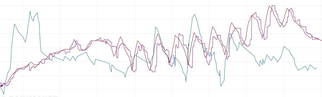

Comparison of HR on intervals.
Purple: Apple Watch Series 4 - Wrist HR
Rust: Garmin Forerunner 920XT - Chest Strap
Green: Garmin Fenix 5X Plus - Wrist HR
Very impressed with the Apple Watch Series 4 which is consistent with the Forerunner 920XT Chest Strap
The Garmin Fenix 5X Plus consistent with my previous experience with wrist HR - not too accurate.
Information: Incline treadmill, intervals 15 sec high intensity, 45 sec rest
All 3 uploaded to MapMyFitness web site. TCX files exported, then imported to DC Rainmaker Analyzer
ADDED: AW 4 Left Wrist, Fenix 5X Plus Right Wrist

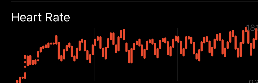

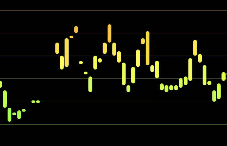

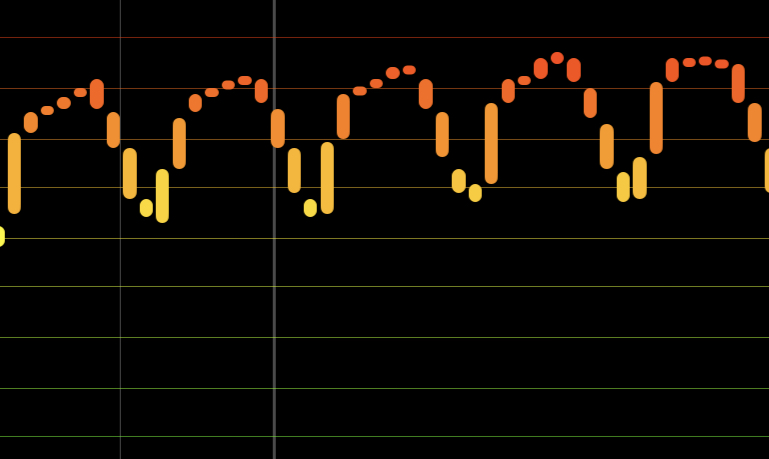

Here are 2 similar HIIT workouts - one with S4 and the other a wahoo chest strap.

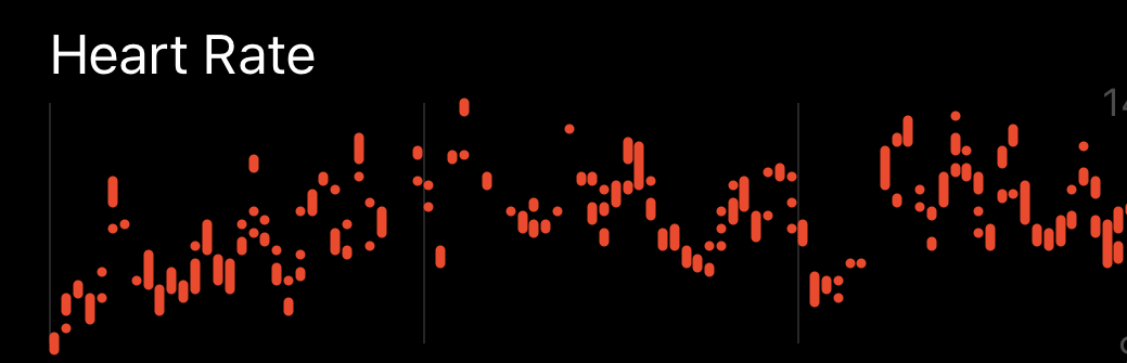

What does it mean when it shows these long vertical lines in the 2nd chart as compared to dots/small vertical lines?

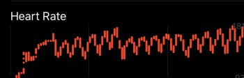

I think it’s a scale issue. Here’s another example showing the difficulties of picking up the HR

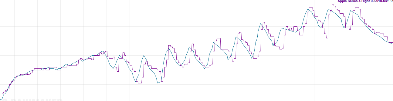

Exact same protocol as before, but AW 4 on Right Wrist. Fenix 5X Plus Left Wrist but all over the place so graph only shows AW 4 and Forerunner 920XT Chest Strap.
Changing wrists with the AW 4 led to no change. Excellent consistency with the chest strap. On both workouts, the chest strap HR is slightly quicker (ramp up slightly sooner). Could be due to differences between chest and wrist measurements and/or any damping algorithms used by Apple to provide more stable measurements. For intervals based on time, where HR analysis used mostly post-exercise, I would say any differences are unimportant. For interval training where intervals are brief and based on HR rather than time, the slight delay could be an issue.
I have compared wrist measurements with chest strap using Garmin Fenix 5X, 5X Plus, Forerunner 935, and Suunto Spartan Wrist HR in addition to the Apple Watch Series 3 and 4. None of the others besides the Apple Watch Series 4 came even close to the chest strap measurements.
Green: Garmin Forerunner 920XT - Chest Strap
