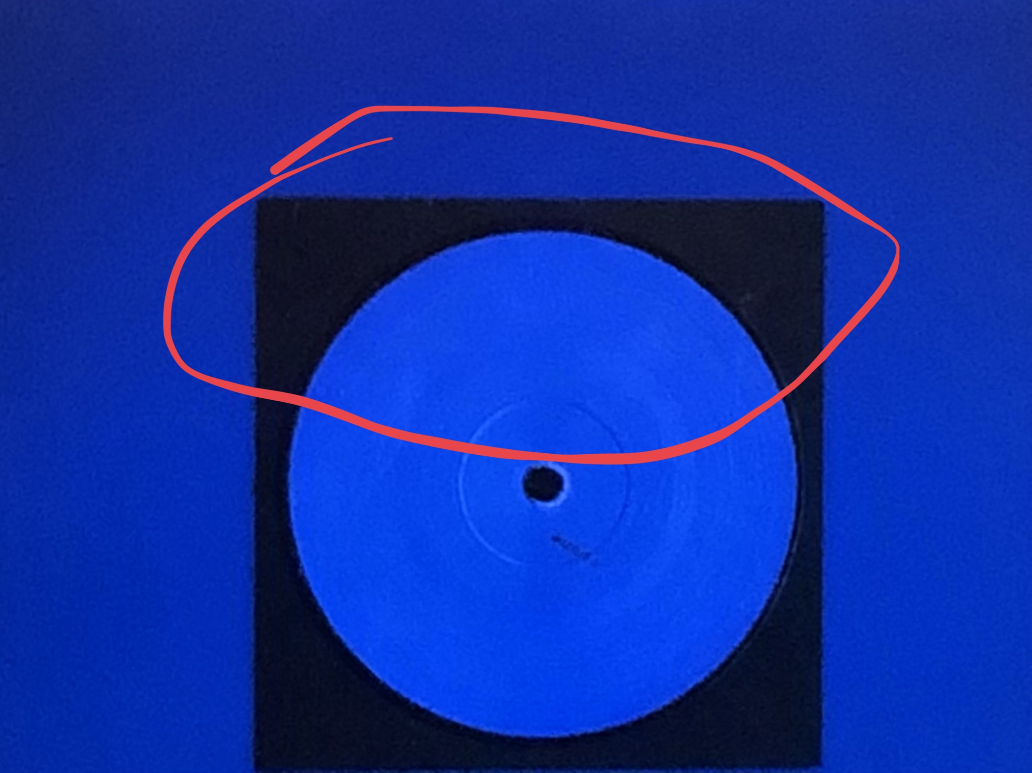

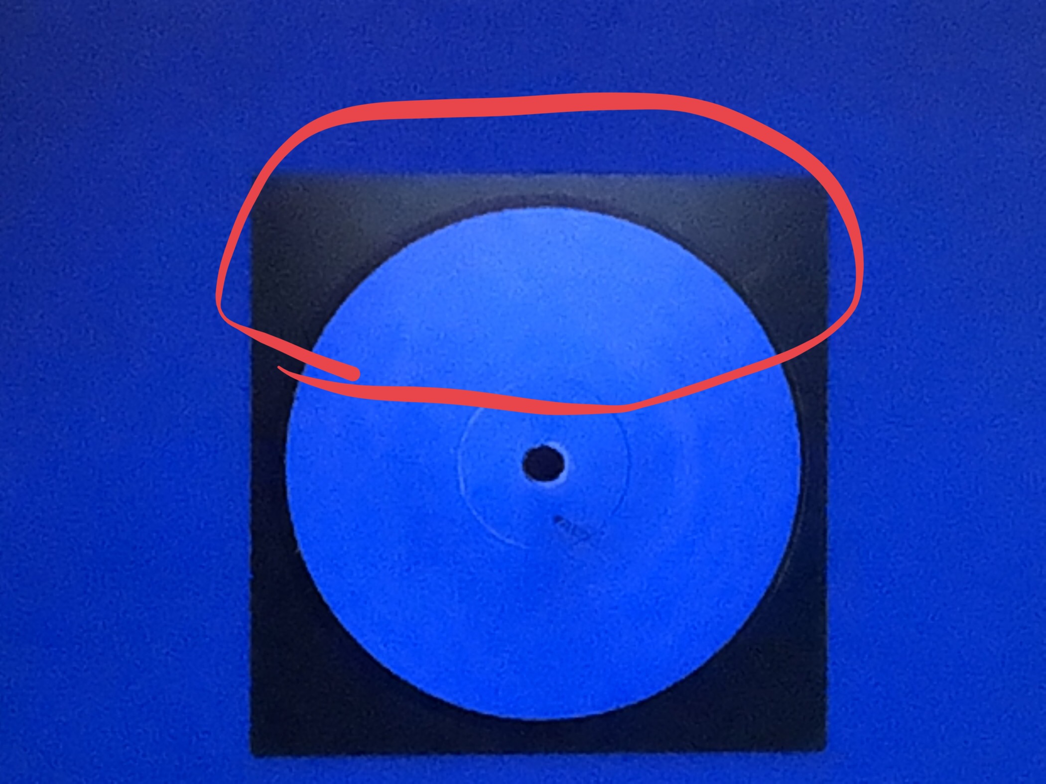

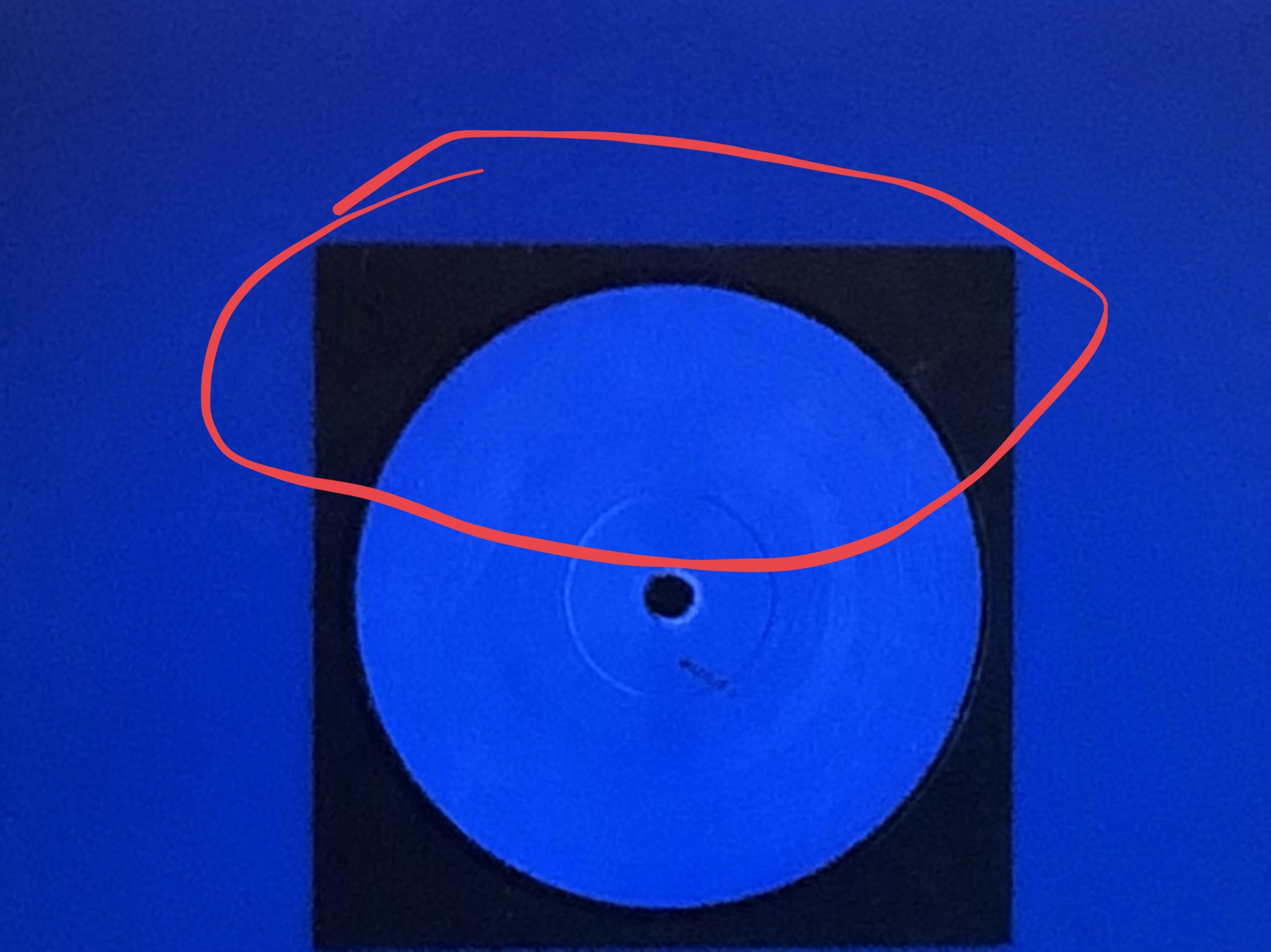

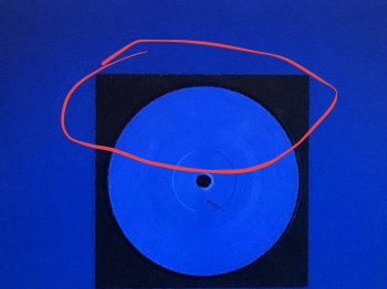

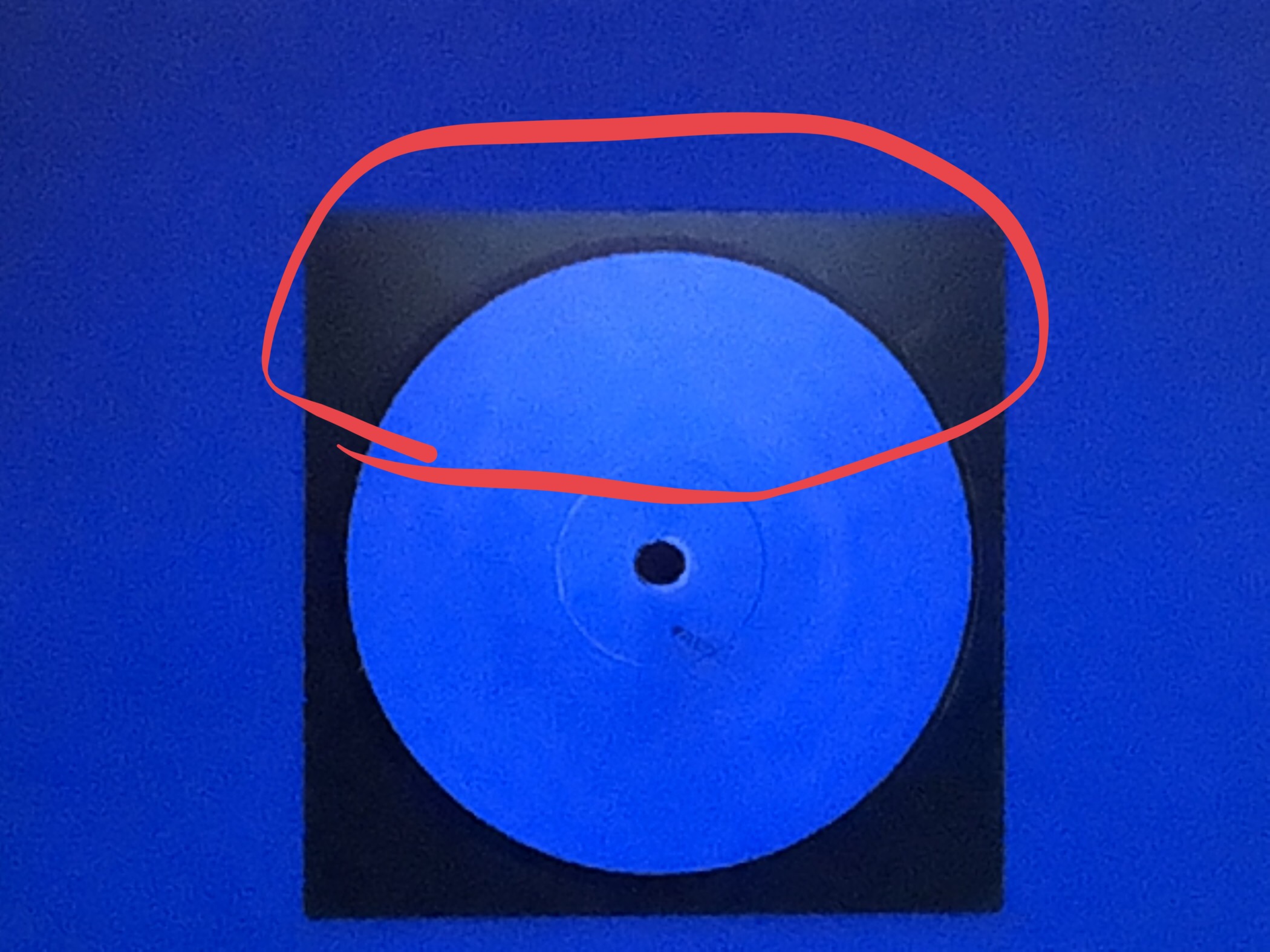

since beta 2 my album art cover is 'pulsating'...just like the sleep indicator on older unibody macbook's (the white LED light)
it happens with every song and i don't fancy it. 🙂
curious if it's a feature or a bug...

In case you haven’t already tried: disabling Dolby atmos in settings has solved a lot of my problems (some still remain but not as bad)
