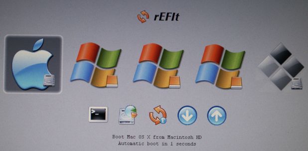

There I had only two icons appearing that were the "Boot Mac OS" and the "Boot Legacy OS from HD" icon. So I chose the latter. Again, the BIOS-like screen flashed up, this time with the matching HDD information, the screen flashes again and then it ends with a "NTLDR is missing - Press Ctrl+Alt+Del to restart" message.

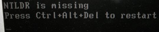

I also have to sort out the "NTLDR is missing" problem.

The "NTLDR is missing" error can mean a myriad of things, but without the ExpressCards drivers loaded XP isn't going to start.

So back again to what I observed: actually I think what rEFIt shows (the right icon titled "Boot Legacy OS from HD" in the image I provided) is not the hard drive itself but the ExpressCard being attached to the MBP.
What makes me believe this is the fact that the same icon was also there when the ExpressCard was attached, but the external HDD was hooked up with the USB cable.
I neglected clicking this icon to see what happens, i.e. if it also shows the SI BIOS screen.
I guess I will do so just to make sure my observations are right, though I am pretty sure it was not the lack of sleep that led to what I saw (actually the screenshots should prove this).

I now can definitely confirm that the "Boot Legacy OS from HD" icon that shows up in rEFIt is from the ExpressCard. I first attempted to boot the upmentioned XP on the USB stick (which failed with the same Legacy OS error message as usually when trying to boot from USB). There already, in the rEFIt menu, the "Boot Legacy OS from HD" icon was also present.
Then I detached the USB stick and hookep up back the hard drive with the XP installations. I rebooted into rEFIt again and the icon was still present alongside the other icons from the hard disk.
I have to stress that ONLY the ExpressCard itself was attached to the MBP in both cases, no hard drive connected to it!
So, this time I chose to click on that icon to see what happens (I know that clicking on one of the XP hard disk partition results in the very same error message anyway) and here is what happened:
the SiliconImage BIOS screen showed up, as we already experienced, then comes an error message saying "No bootable device -- insert boot disk and press any key" which is plainly logic, because there was no drive attached to the ExpressCard.

Here are some more pictures I took with several setups (USB Stick connected, Vista DVD inserted).
Note that the "Boot Legacy OS from HD" icon is always present!

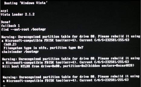

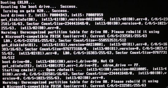

I used rEFIt to choose to boot Vista and this time I got another error message during start up, caused by the Vista boot loader which detected that my HFS+ partitions weren't recognized and supported correctly by Windows. Luckily it continued booting and went right into the Vista desktop, this time without crashing - finally!
So the problems which remain have to do with this Vista boot loader which now always wants me to choose if I want to boot my previously installed Windows XP or Vista. Unfortunately choosing to boot XP causes an ntldr is missing error, though I can still run it through VMWare Fusion (yes, right on my BootCamp partition).
My question is if and how I can get rid of this nasty bootmanager, because it only causes error messages (it seems to be good for nothing)! Even when I am not fast enough (i.e. two seconds) it automatically chooses Vista to boot (which is, of course, resulting in another error message when I want to boot my XP partition under VMWare).
Can I use EasyBCD for this purpose or do I have to remove it under Windows XP? What is needed to be done so that both Operating Systems will still be bootable after all?

BTW, I have also uploaded the screenshots of the error messages I get during boot-up. It must be due to the HFS+ partition(s). I read that one can get rid of these errors by rebuilding the MBR, though.

As I said, I already tried all of the newer and older bios's from SI's website.
I tested this in my friends 17" 2.33 C2D MBP (non Santa Rosa) and it works fine. It's definitely related to the new SR MBP's.
