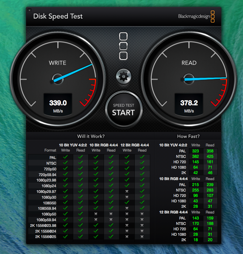

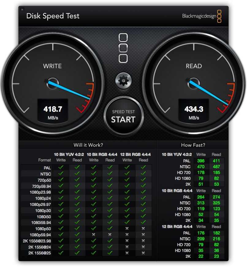

I put a Samsung 840 pro in 2 setups - USB3 and TB - and USB3 was faster but not by much (1st pic) - 420ish vs 370ish.
USB3 was a $15 Inateck enclosure recommended by someone on the forum.
TB setup was using the $100 Seagate TB adapter.

USB faster than TB?
That's an interesting result. I tried my 840 EVO in the OWC USB 3.0 enclosure, via a cheap USB to SATA adapter, and via internal Sata 6Gbps on my Mac Mini.
I don't have the BlackMagic results to hand, but it was roughly:
1) comfortably over 500MB/s read & write via internal SATA
2) About 460MB/s read and 390MB/s write in the OWC USB enclosure
3) About 380MB/s read & 340 MB/s write with the $10 USB3->SATA adapter.
I originally got the OWC USB 3.0 enclosure because I had read good things about its performance, and there weren't any simple and affordable Thunderbolt enclosures without an included disk.
The cheap adapter is OK for the money, and it would be a reasonable option for a very small backup solution using a naked SSD (much lighter than the metal OWC enclosure which is enormous for a 2.5" disk!)
Your results made me think I have made the right decision with the OWC. It's surprisingly good, and maybe I would actually get *worse* results with a Thunderbolt enclosure.
I guess it all depends on the controller chips.
But throughput isn't the whole story. I'm not sure whether Thunderbolt has better latency figures or taxes the CPU less than USB 3, so real world results may be different, particularly is running an OS from the external drive rather than just using for backup.
be careful drawing too many conclusions from one benchmark. as you noted, "real-world" performance may vary, but the bigger thing is that the blackmagic test isn't regarded as the best indicator of performance, though it is easy to use.
it surely is possible to have a poorly-designed TB enclosure and a great USB enclosure, or vice versa. if TB isn't at least on-par with USB3 i think it may be suggestive of a bigger issue at hand.

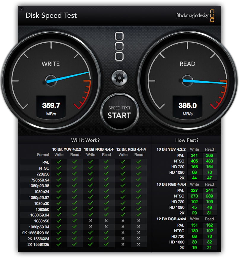

I have a Pegasus2 R4 for my main storage drives. For a flexible external TB drive that I can use at will with any bare drive, from regular hard drives to SSDs, I use the Thunderbolt adapter meant for seagate drives. I picked one up for $130 at BestBuy and are now more expensive on Amazon.
The drives have an exposed connector which is actually not a propriety connector but rather standard SATA connector that you can put any SATA drive directly on it. I use an inexpensive short SATA extension cable from Amazon to make it very easy to use even old heavy drives without tension. An SSD can directly stand up on it. I can use it for anything, including booting Windows from a migrated Bootcamp partition with Winclone. I needed the flexibility to access my massive collection of SATA drive archives.
The setup is not the prettiest since it uses bare drives, but if you want to used it for any drive you may have, it is the easiest. Works well for me.
The Disk Speed Test is to a Samsung 840 EVO 1 TB drive Fat32 partition.

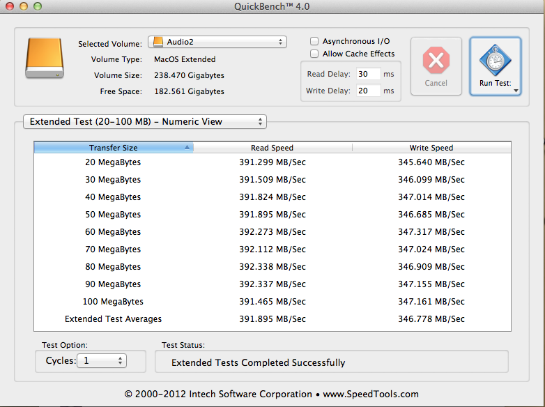

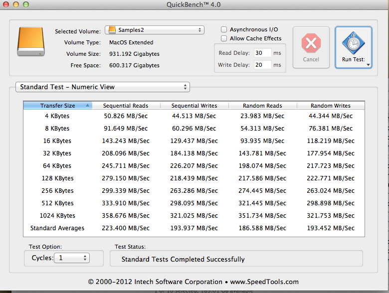

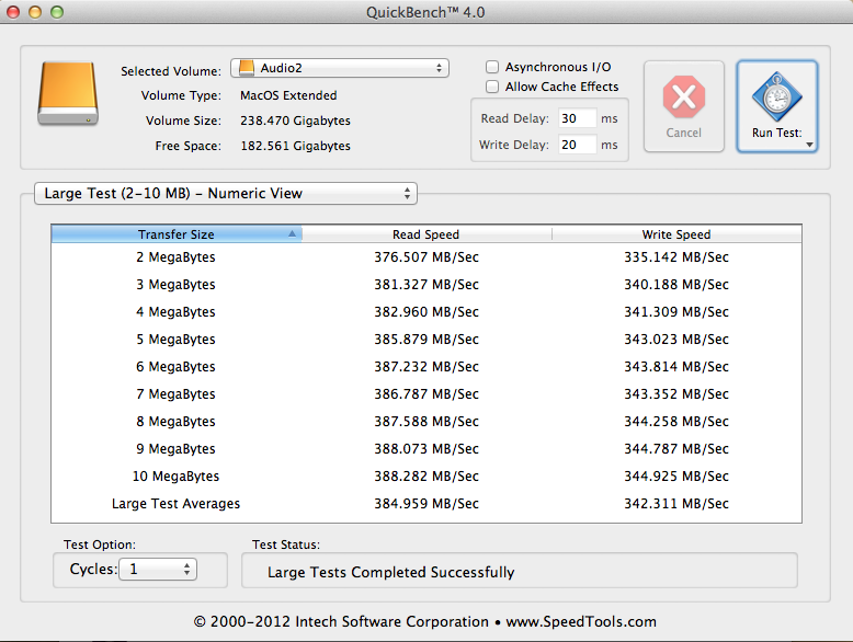

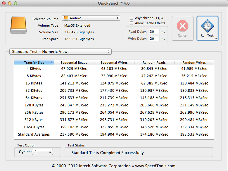

Almost the same as "Rad", I purchased this Thunderbolt sled/adapter
It works with any SSD and you're not left having to sell a smaller SSD that you don't need.
I used this adapter with a Samsung 840 Pro SSD to run Windows 8.1 externally on my nMP.

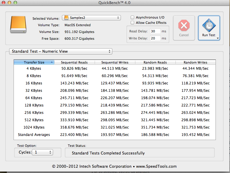

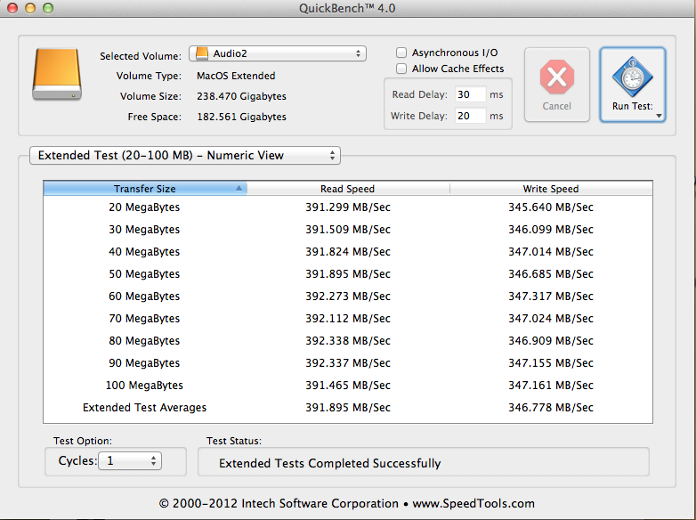

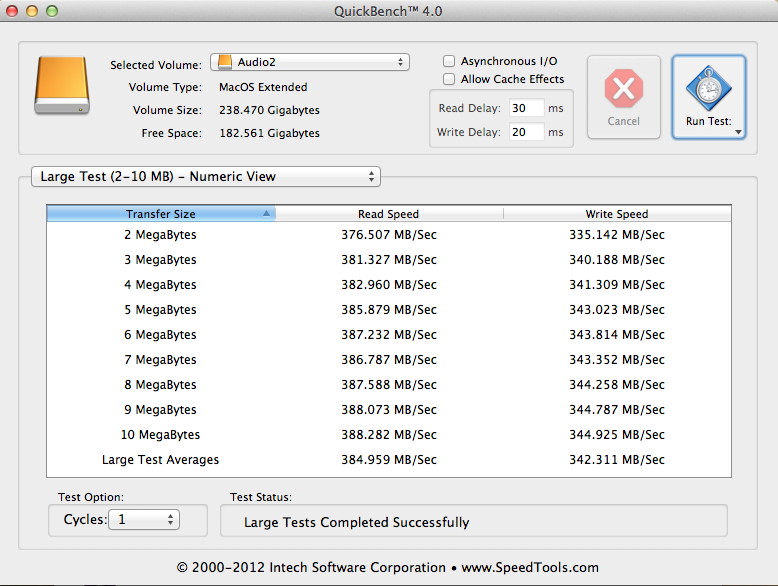

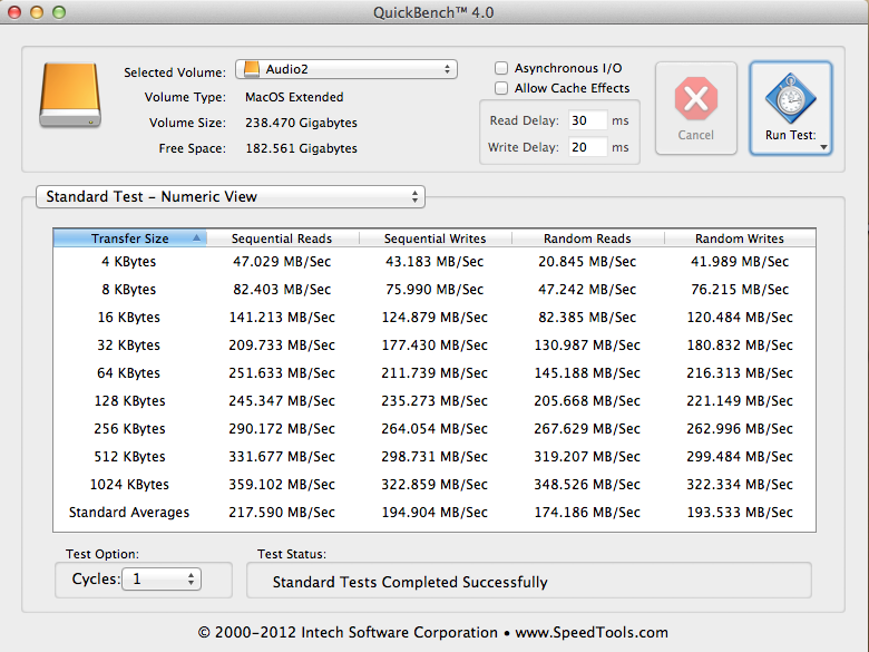

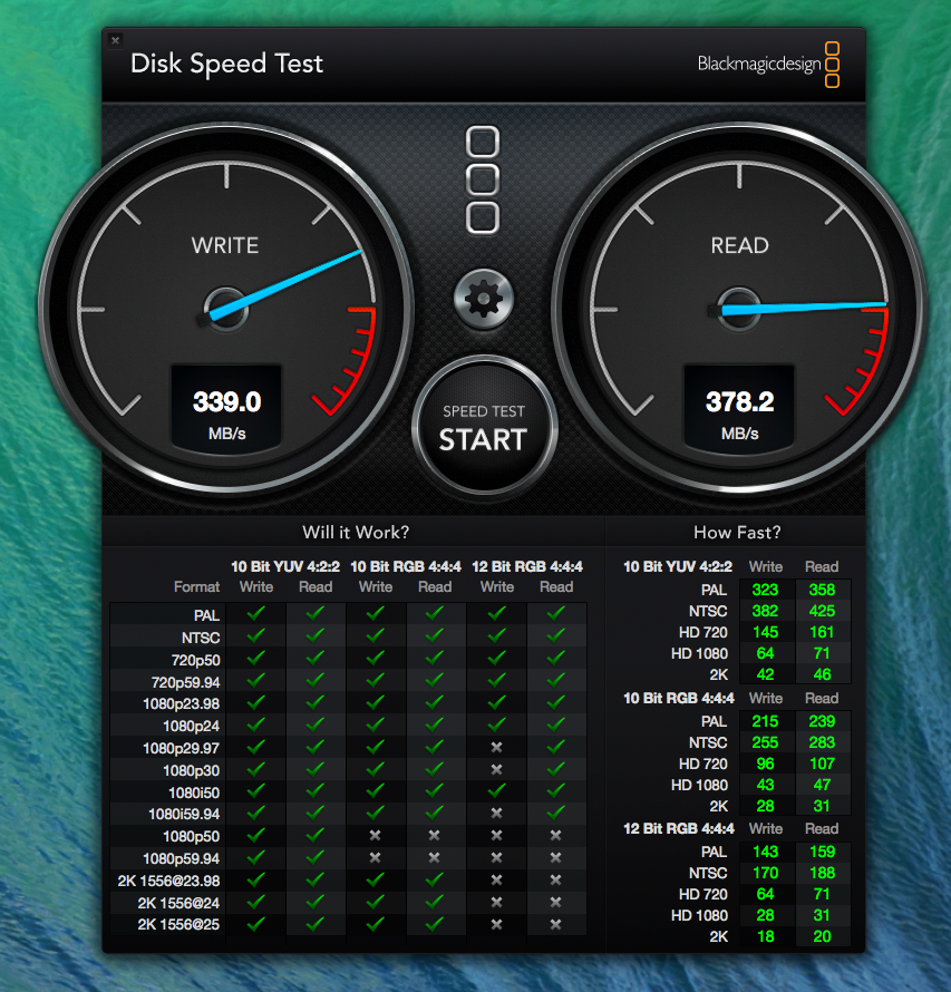

Blackmagic Multidock
Samsung 512G 840 pro (391MB/s 347MB/s - R/W files over 10Meg)
(1TB EVO is about the same)
