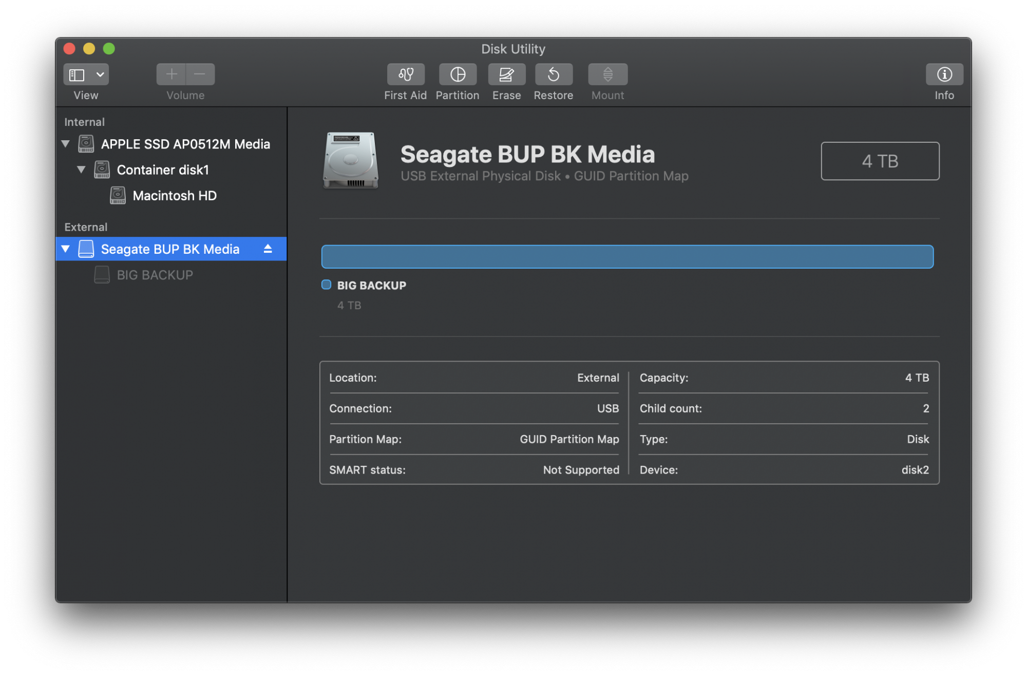

I use a Seagate External HDD to back my files. I wanted to back up today. First, I backed-up some files from my Mac mini. It went OK. Then I ejected it and plugged it to my MacBook Pro to backup some files.
It was very slow: like creating a folder took ages. I ejected it and disconnected it.
I plugged it again and on the Finder he doesn't appear anymore.
I went to disk utiity but it is grey.
Is it dead? Any recommendations how I can make it work again?
