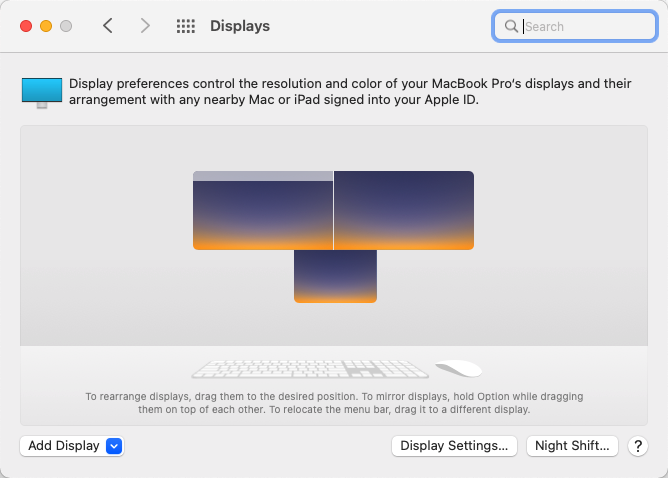

14" MBP / 10/16/16. Dual DIY 21.5" 4K iMac displays connected to an OWC TB3 dual DisplayPort adapter connected to an OWC TB4 dock.
When I first got both these displays going, I found it was swapping their positions every time it woke from sleep. I swapped the ports they were plugged into on my OWC adapter, and the behavior stopped. I won't be shocked if it reoccurs at some point, but it's been solid for a couple weeks now. FWIW, I seldom unplug my MacBook, and I half expect it might get confused again next time I take it somewhere.
I think the advice of "be sure to plug in your monitors from left to right" + thinking about the order in which macOS sees your various ports and adapters is somewhat helpful here.

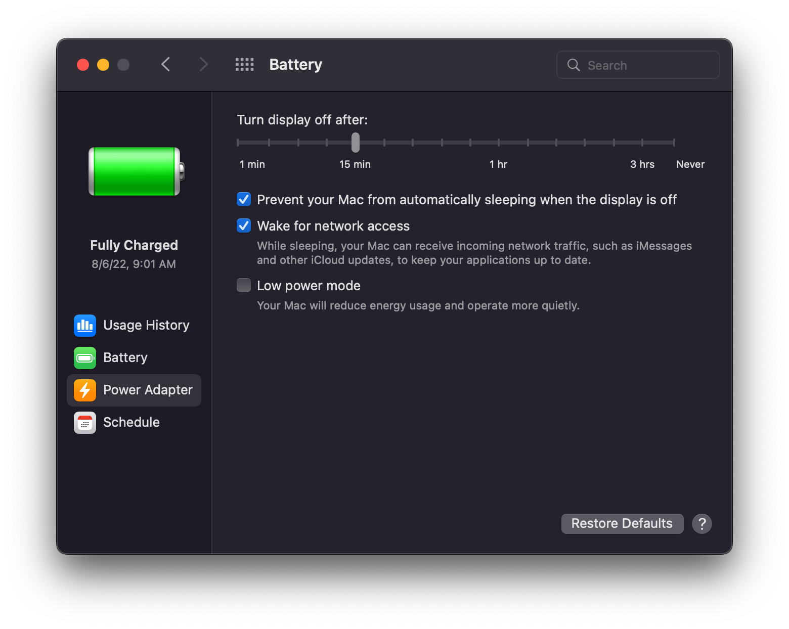

I have my MBP set to "prevent from going to sleep" and I turned off the schedule to have it sleep overnight. For me, it was only swapping displays on reboot or waking from truly sleeping (not just the displays sleeping). So, while I'll still have to deal with it on reboots, it should minimize how impactful it is. I may also shorten how long before the displays turn off and use the "Amphetamine" app during the day to keep them active if I'm reading something without interacting.

This is happening to me every day. Two external monitors of same type (HP), plugged into docking station. If
I am running 14" MBP with two external displays and the monitors will not keep their position to the left/right every time I wake from sleep or plug back in. The monitors are arranged above my MacBook Pro (see below), with the monitor on the left connected via a USB-C dock and hte monitor on the right via HDMI.
After waking the computer, the monitor on my left will be on the right and vice versa so I have to go into the display settings and drag-and-drop them back into place.
The only thing I can think of is that each monitor is the same brand/model and perhaps that is causing an issue. I'm not sure if this is an OS Monterey or hardware issue. I've tried ensuring I plug-in the computer in the same order or make different monitors (including the MBP display) as the 'primary' monitor, but nothing seems to work. I have not tested using a different USB C dock solution or ocnnected directly to the left monitor via a USB-C-to-HDMI adapter in case the dock is causing the issue, but that doesn't really make sense to me.
Is there a way to perhaps adjust the names or behavior of the displays to trick the OS into remembering one should always be on the left?
My exteneral displays - same model.
I appreciate any insight or help!
Same! I have two external monitors of same model, plugged into docking station. Whenever I power off and power machine back on, it reverses the position of the monitors. I find that if i move the power cord back and forth between the two positions on the laptop, it eventually sets the monitors to the right position without me having to go into the settings. Super annoying though.
I had this problem on a 2019 Macbook Pro and it remained, unchanged when I upgraded to a Macbook Pro 2022 - both using identical twin monitors. In both MBPros there is no problem when used on another setup of two dissimilar external monitors.
I seem to have solved this problem for me - I have now had no random swapping of monitors during the last 20 or so wakes from sleep. I think the problem may have been associated with both monitors having the same (default) name - with (1) and (2) appended. I did this sequence:
1) I unplugged the right monitor and used switch SwitchResx to change the name of the left monitor to "Left"
2) I unplugged the left monitor, replugged the right monitor and changed its name to "Right"
3) I replugged the right monitor
The two monitors now have different names and everything works fine - the different names could be confirmed by eg looking at Display Preferences or "About this Mac"
Strangely, after about 10 mins the name of the Left Monitor changed to "Right" so both monitors now have the same name. I've repeated this process with the same outcome - but nevertheless it has solved the problem. This is what it looks like now:
Reactions: lasyos
So I don't know if this is going to help or not, but I was able to identify a short path to "fix" this.
I installed homebrew and then installed the DisplayPlacer utility using Terminal.
Homebrew: /bin/bash -c "$(curl -fsSL https://raw.githubusercontent.com/Homebrew/install/HEAD/install.sh)"
DisplayPlacer: brew tap jakehilborn/jakehilborn && brew install displayplacer
Once DisplayPlacer is installed arrange your monitors how you want them open Terminal and run the command: displayplacer list
This will give you an output that looks like this.
"id:37D8832A-2D66-02CA-B9F7-8F30A301B230 res:1728x1117 hz:120 color_depth:8 scaling😱n origin🙁0,0) degree:0" "id:8EDCC4C2-9BB1-461F-B96F-EC0BE9D304BA res:1920x1080 hz:75 color_depth:8 scaling😱ff origin🙁1728,0) degree:0" "id😀AF6A076-DBDC-4A36-8F82-471F341127F8 res:1920x1080 hz:75 color_depth:8 scaling😱ff origin🙁3648,0) degree:0"
In Automator write a shell script workflow using this output.
Mine looks like this:
/opt/homebrew/bin/displayplacer "id:37D8832A-2D66-02CA-B9F7-8F30A301B230 res:1728x1117 hz:120 color_depth:8 scaling😱n origin🙁0,0) degree:0" "id:8EDCC4C2-9BB1-461F-B96F-EC0BE9D304BA res:1920x1080 hz:75 color_depth:8 scaling😱ff origin🙁1728,0) degree:0" "id😀AF6A076-DBDC-4A36-8F82-471F341127F8 res:1920x1080 hz:75 color_depth:8 scaling😱ff origin🙁3648,0) degree:0"
I found this part "/opt/homebrew/bin/displayplacer" by running in Terminal: which displayplacer
Once saved you can open the workflow with Shortcuts. This creates a shortcut program that can be pinned to the menu bar for easy access.
When the monitors rearrange themselves, run the shortcut and it should at least alleviate some of the basic frustration.
Please ignore the emojis.
