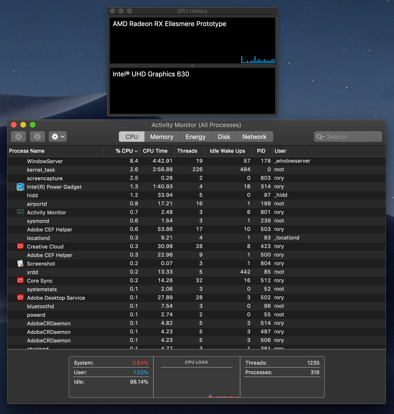

If you go with an external GPU, you may find it helpful to pull up Activity Monitor's GPU History window occasionally. It's ⌘4. The top half of the window in the photo shows activity for an AMD RX 590 (called, for some reason, Ellesmere Prototype).

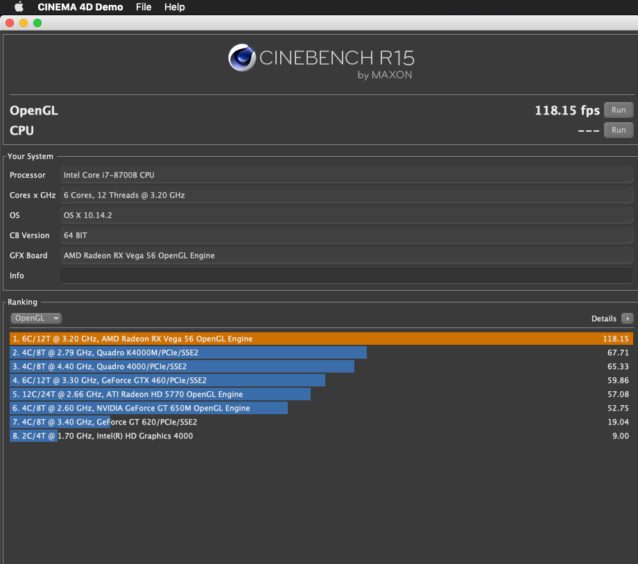

Cinebench R15 OpenGL Benchmark Results, RX 590 vs RX Vega 56
Computer: 2018 Mac mini, i7/8GB/512GB
GPU enclosure: Asus XG Station Pro
Monitor: Asus ProArt 32" 3840x2160 (PA32UC)
First Screenshot: RX 590 (Sapphire Nitro+, Special Edition). Mojave identifies this GPU as HD Ellesmere Prototype.
Second Screenshot: RX Vega 56 (Asus AREZ Strix, OC Edition). AREZ Strix is the new name for the ROG Strix series.

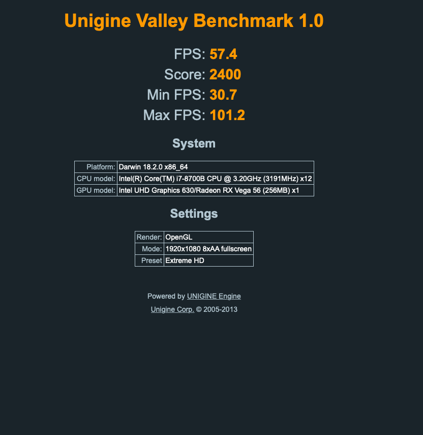

[doublepost=1544649313][/doublepost]Unigine Valley Benchmark Results, RX 590 vs RX Vega 56 (Test 1 of 4)
Unigine Valley Setting for Test 1: Extreme HD Preset, 1920x1080, 8x Anti-aliasing, Full Screen
First Screenshot: RX 590 (Sapphire Nitro+, Special Edition). Unigine Valley identifies this GPU as Radeon Polaris.
More benchmarks to come...

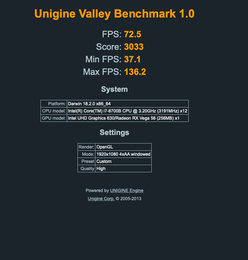

Unigine Valley Benchmark Results, RX 590 vs RX Vega 56 (Test 2 of 4)
Unigine Valley Setting for Test 2: High Quality, 1920x1080 Window, 4x Anti-aliasing

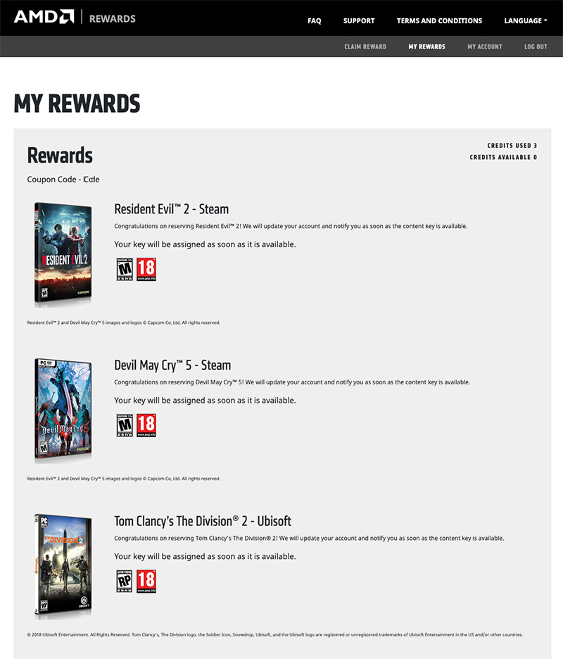

These are the games that you get if you purchase certain AMD GPUs at the moment. Resident Evil 2 comes out in January, the other two in March. They sell for US$60 each. However, as far as I know, they will not be playable on the Mac Operating System.
To claim the games, you need a code from the retailer that sold you the GPU. In my case, the vendor sent me the code by e-mail one or two days after I made the purchase.
As I discovered, when you input the code on AMD's rewards site, AMD will honour the code only if its site is able to detect the new GPU in your system. This means that the GPU has to be installed in your enclosure and connected to your computer.

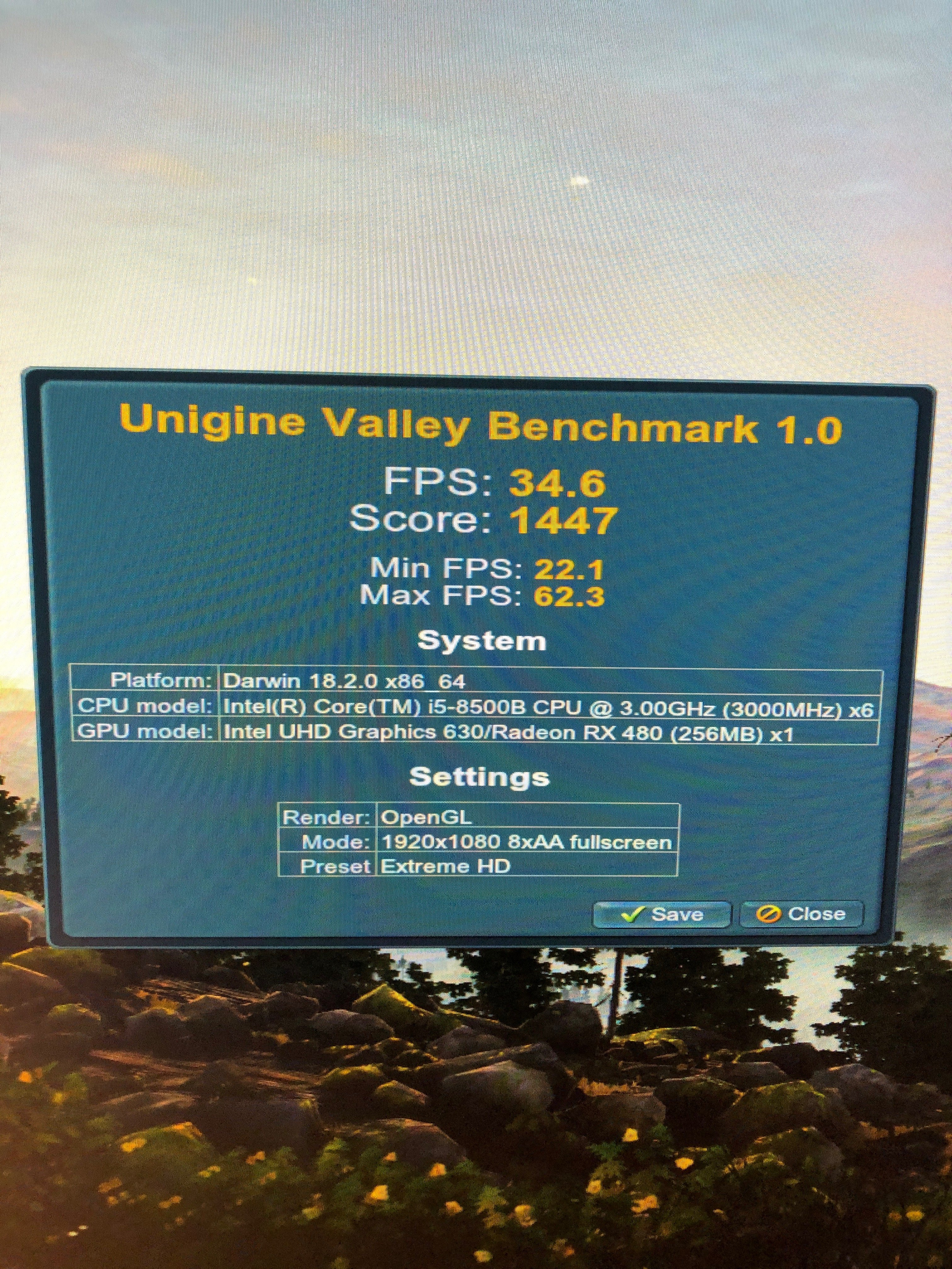

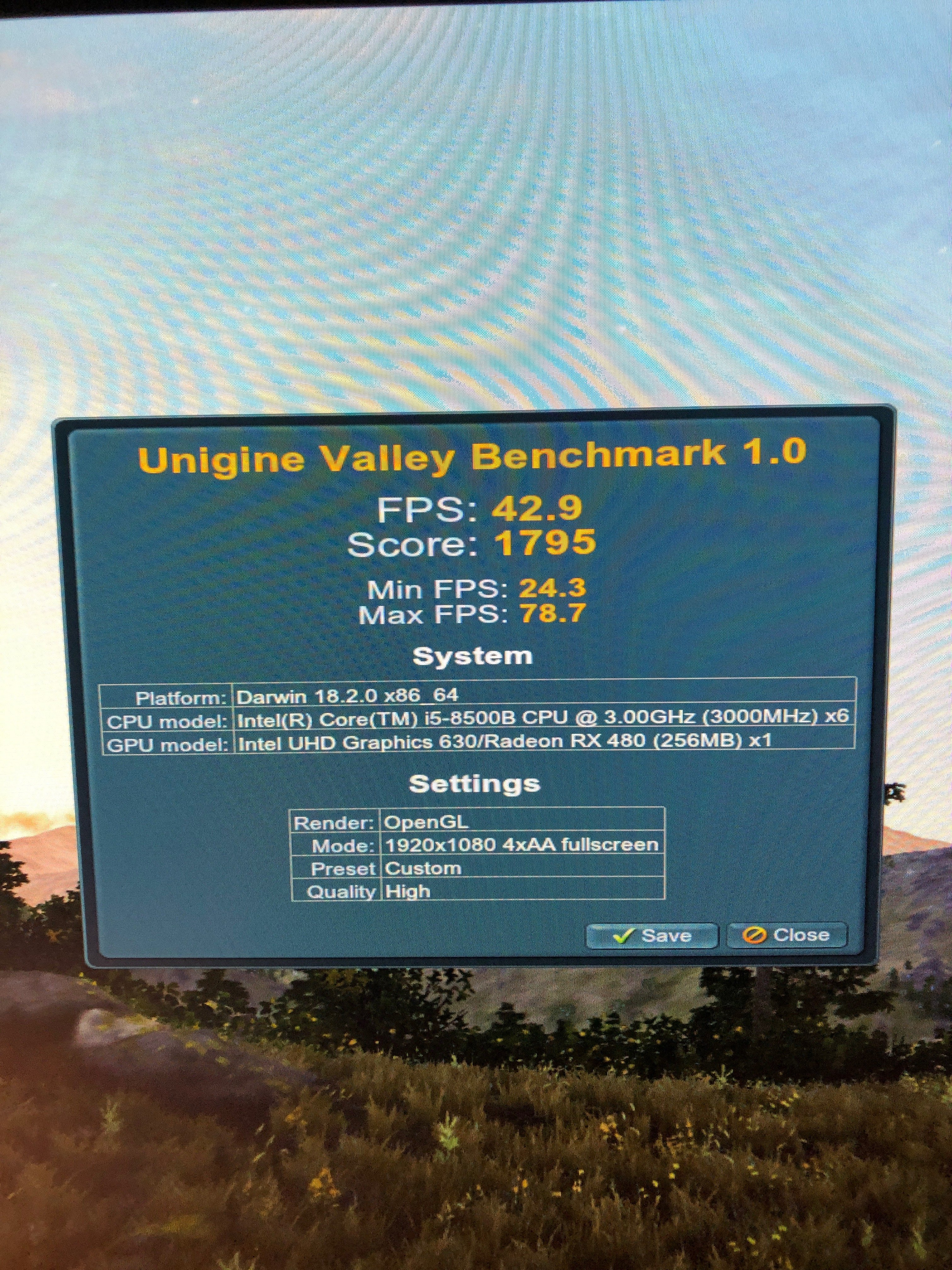

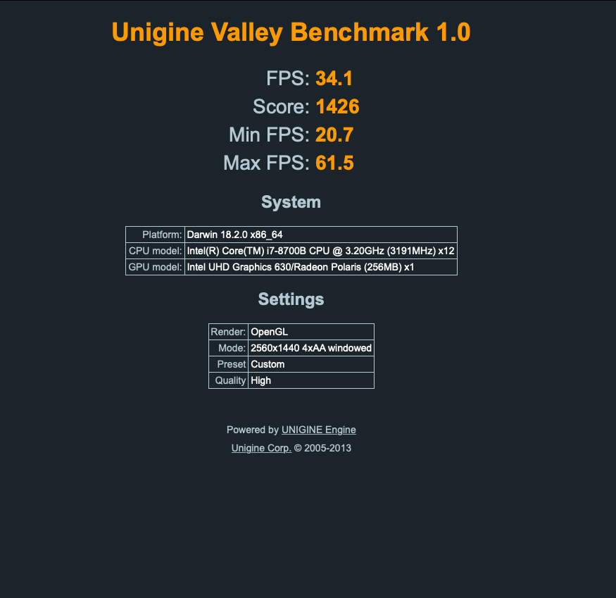

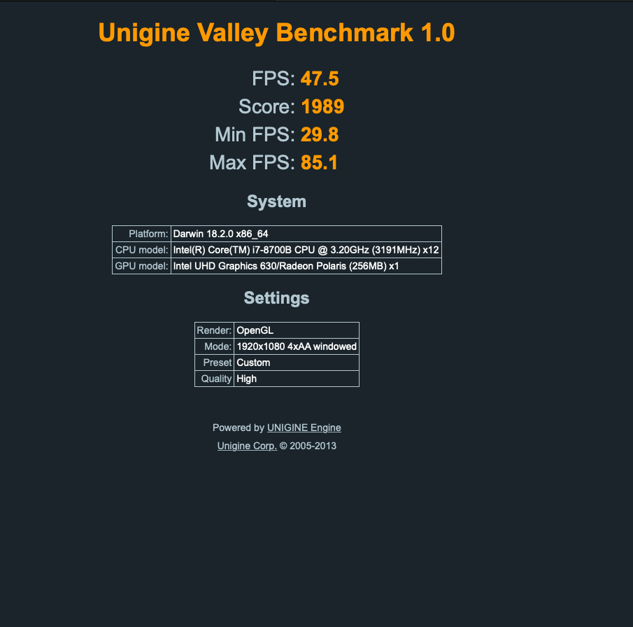

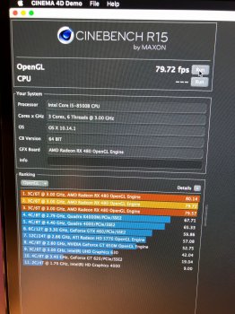

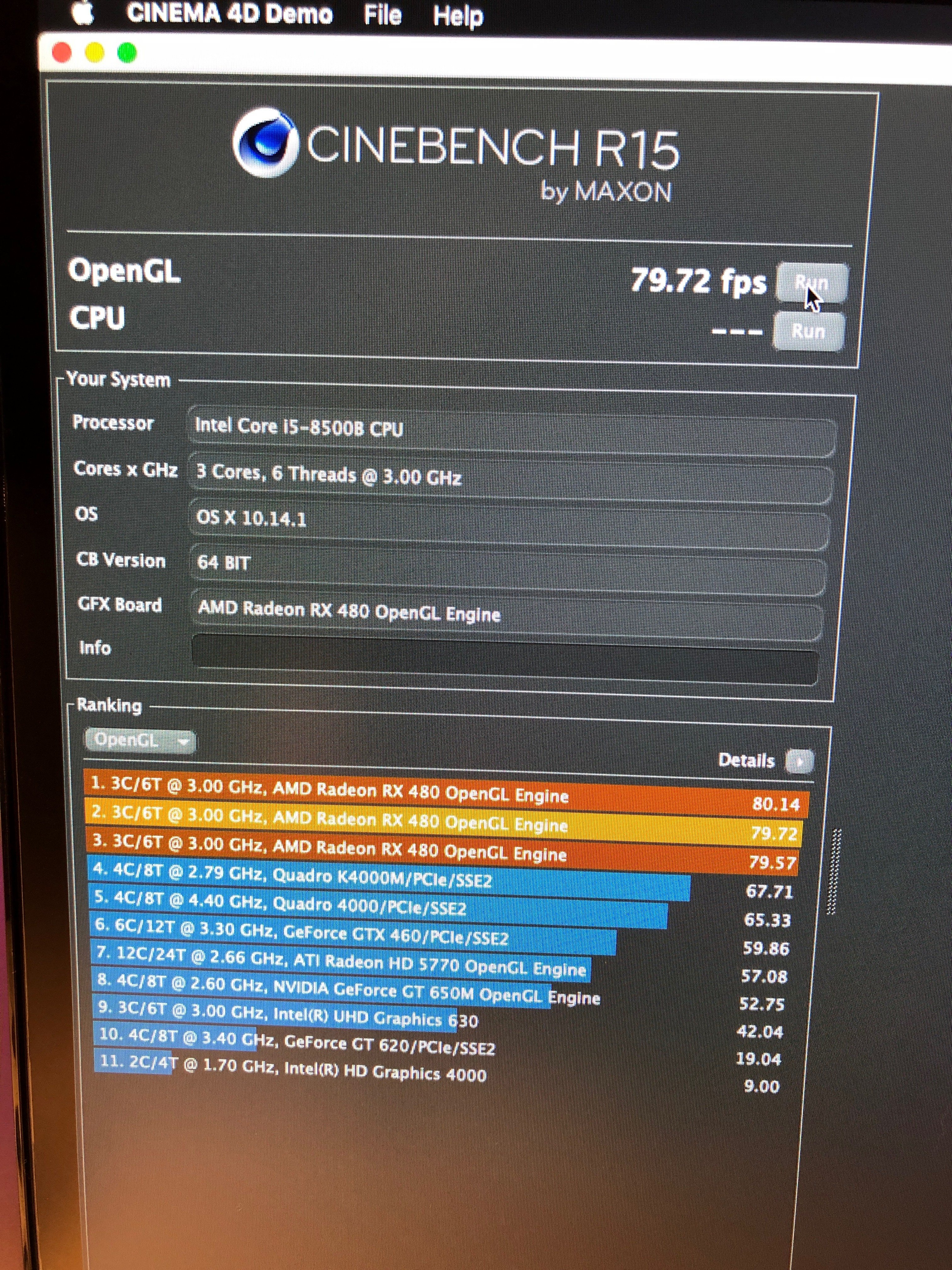

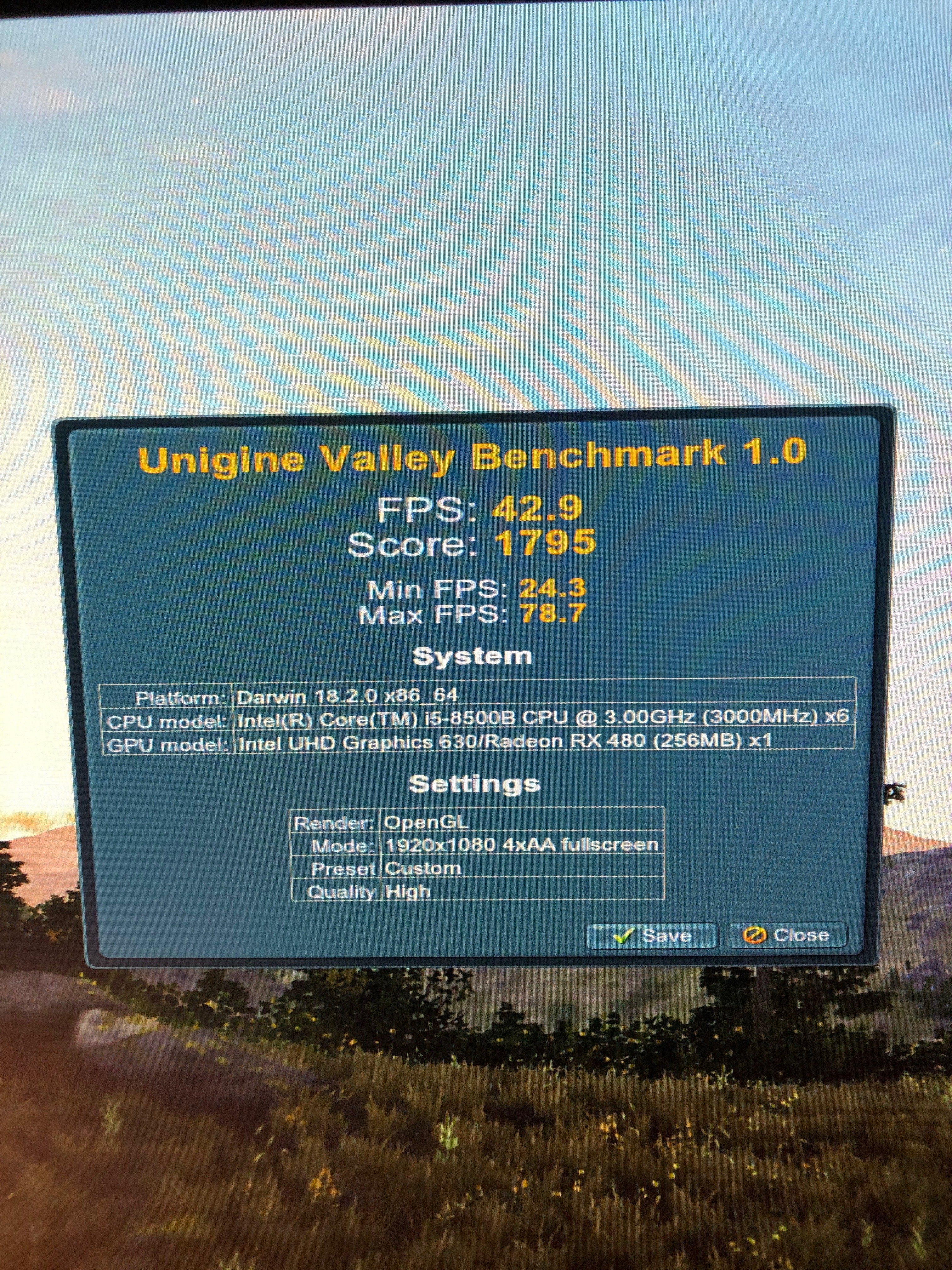

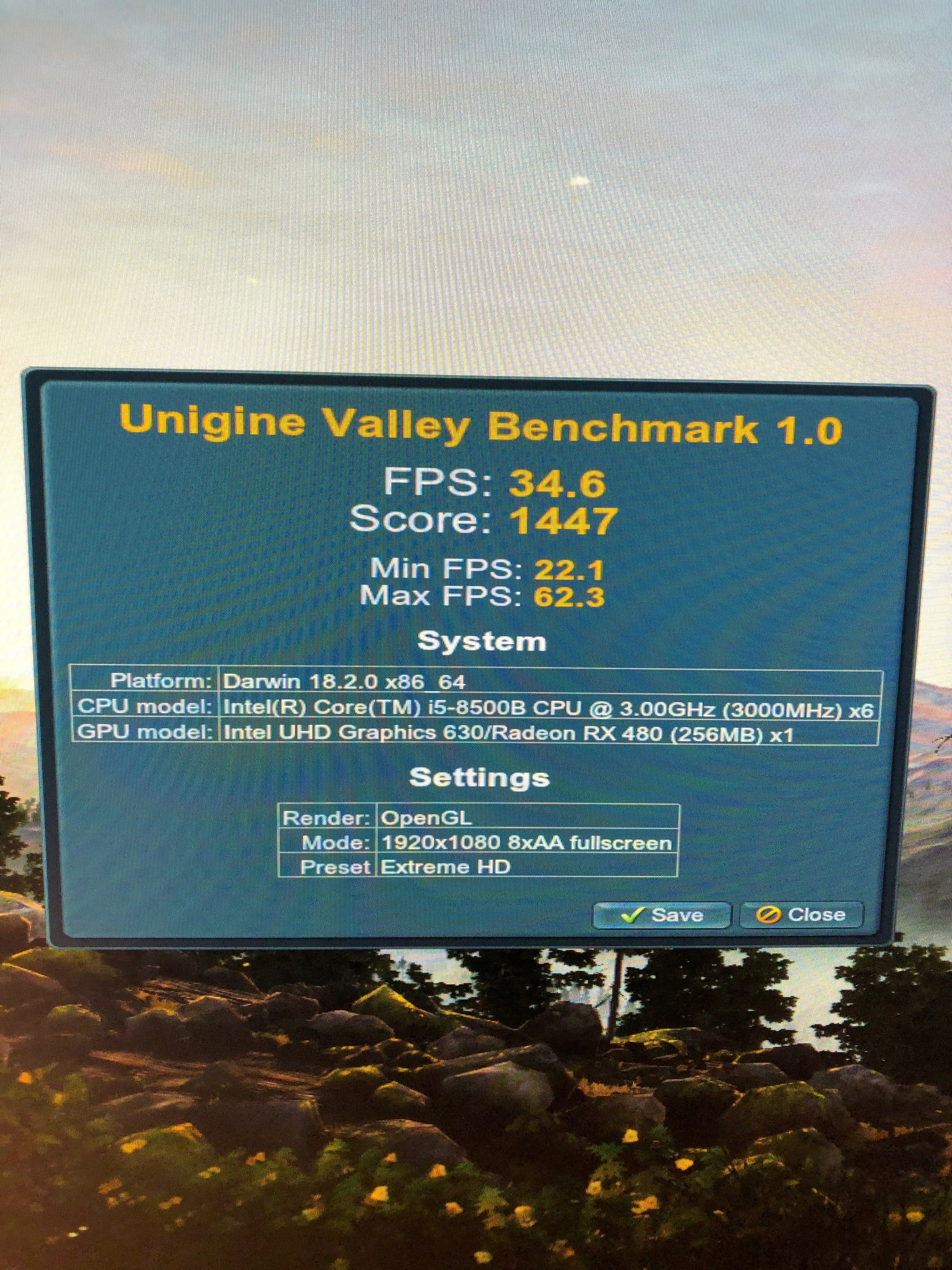

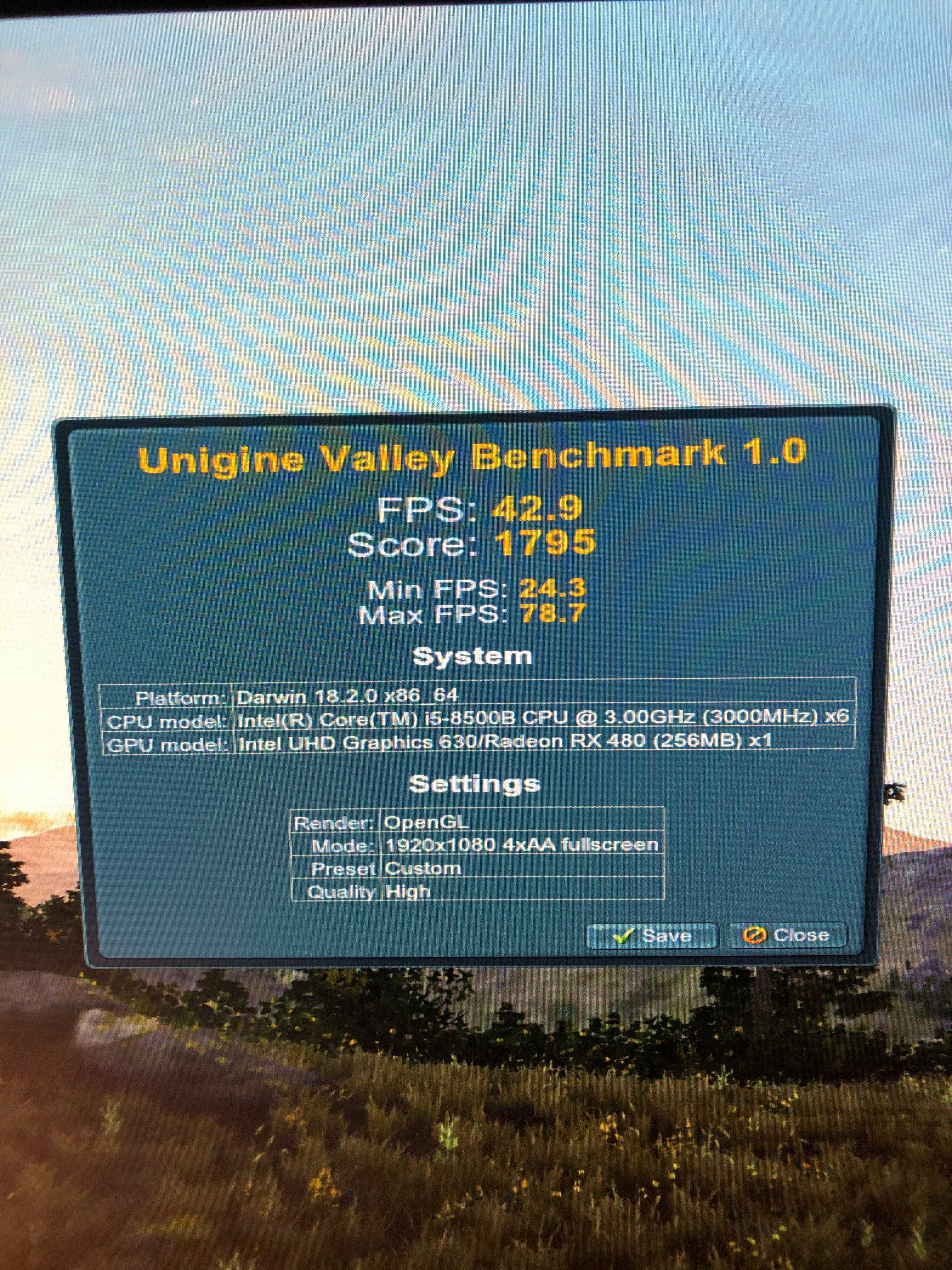

This post made me want to test out my 2018 Mac Mini with eGPU setup. I have the i5/16gb/256gb model, with an Akitio Node TB3 eGPU, equipped with an older RX 480 (4gb) card. When the eGPU is on (and working), I got the following results with the settings as follows:
Keep in mind I have a 21:9 1080p monitor, but that selection isn't available in Unigine Valley. Don't know if that matters.
Great, first benchmark for an RX 480. It would be interesting to see what you get in Unigine Valley if you set the preset to Extreme HD. That's the starting point for the benchmarks that are being used here. It will set up highest quality, 1920x1080, 8x anti-aliasing, full screen.
It would also be great to see a benchmark for Cinebench.

I tried to mimic your last post regarding settings for Ungine Valley... if that's not acceptable, I just ran the Extreme HD settings:
Again, this is NOT my monitor's resolution... I am running a 21:9 monitor, not a 16:9.
Cinebench soon to follow...
EDIT: Just ran Cinebench...
As you can see, I've gotten slightly higher numbers from previous tests with the exact same setup, but this is a good representation of what to expect.
Keep in mind, this is an i5 with 16GB of RAM.

Hi tpivette89,
Your Unigine Valley Extreme HD and Cinebench results for the RX 480 suggest that people aren't far off when they say that the RX 580 and RX 590 are essentially ramped-up/overclocked versions of the RX 480.
It would be great to see results for an RX 580 and Blackmagic eGPU now, the Blackmagic having a card that is a variation on an RX 580.

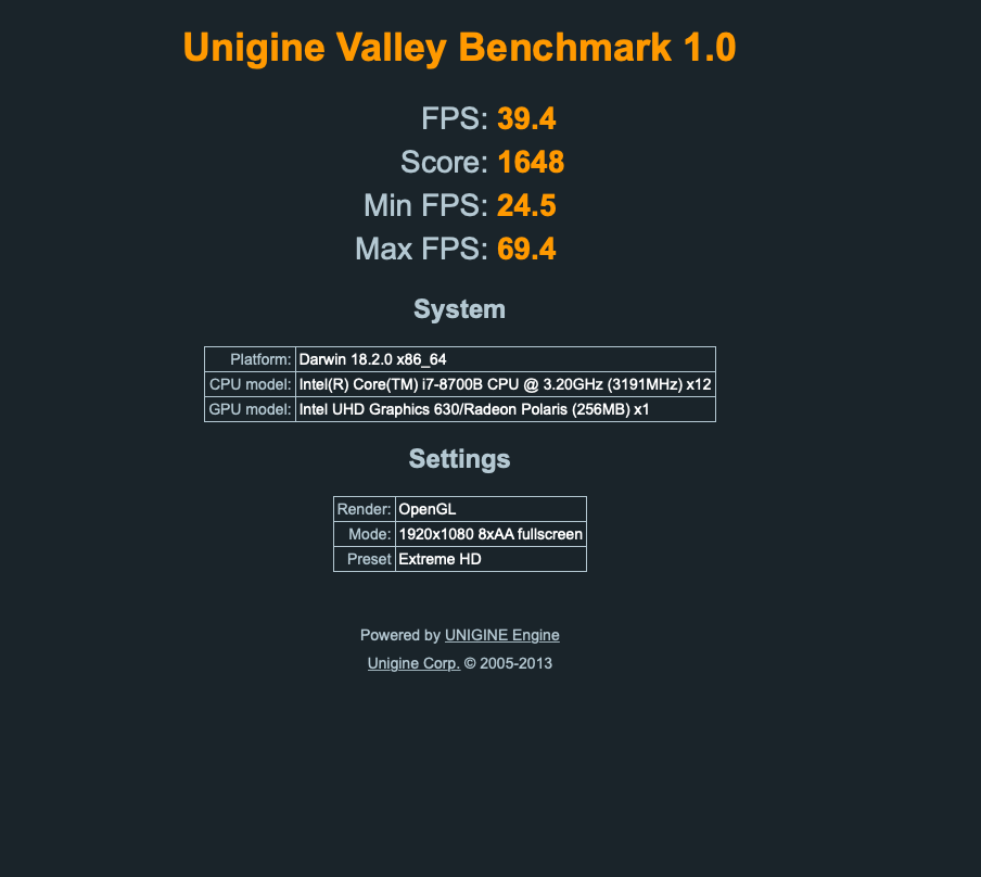

Unigine Valley Benchmark Results, RX 590 vs RX Vega 56 (Test 3 of 4)
Unigine Valley Setting for Test 3: High Quality, 2560x1440 Window, 4x Anti-aliasing

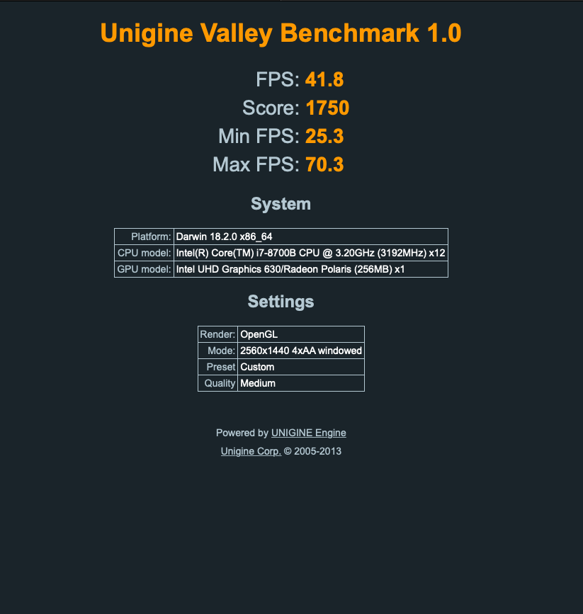

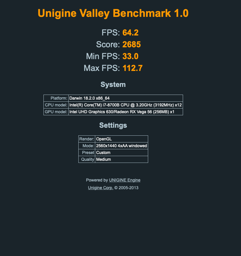

[doublepost=1544708513][/doublepost]Unigine Valley Benchmark Results, RX 590 vs RX Vega 56 (Test 4 of 4)
Unigine Valley Setting for Test 4: Medium Quality, 2560x1440 Window, 4x Anti-aliasing
