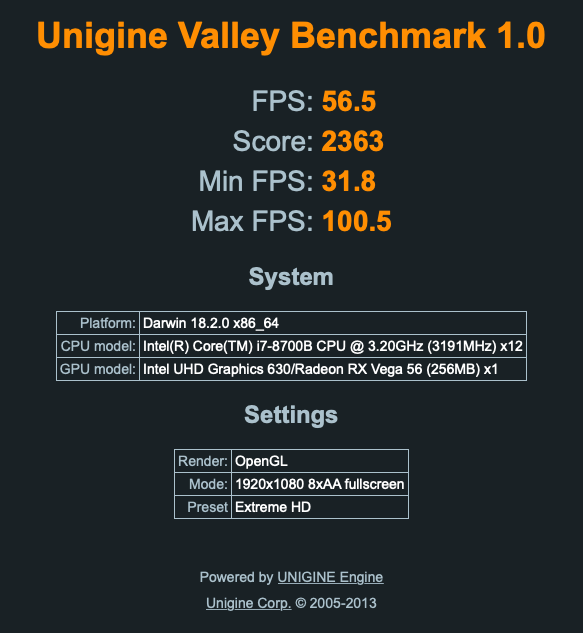

Thanks very much. Why do you think that you're getting the same fps as a 64? Which card is it?
It's a Sapphire Pulse RX Vega 56, with 8GB ram. Yes, it's strange that my 56 have nearly the same fps as a 64...
Perhaps the programs that KennetS had worked in the background have had some influence.

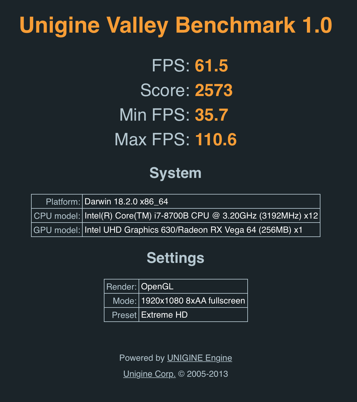

Unigine "Valley" benchmark at maximum "Extreme HD" settings gives this results:
So, happy camper here. 😀

It has been shown before that on paper the 64 looks much more powerful than the 56 but in real life it’s a different story.
There’s also cases where if you undervolt the 56 it will pretty much match the 64 is almost every sense.

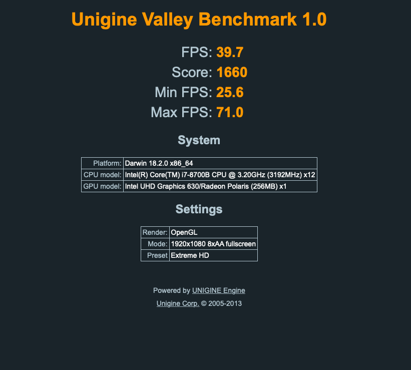

Further to posts #253 and #254, here is the result for an RX 590 on the same settings (see Mode and Preset in the photo) and a 32" screen.
So for average FPS:
RX 590: 40fps
Vega 56: 57fps
Vega 64: 61fps

My first test of the RX 590 (post #257) was full screen on a 32" monitor, native resolution 3840x2160, at a resolution of 1920x1080, 8x anti-aliasing.
Here are two more tests that might be useful if you're trying to figure out how to get the best out of the card. They are for 1920x1080 and 2560x1440 windows, 2x Anti-aliasing, quality High.

[doublepost=1544196008][/doublepost]Considering the Cinebench and Unigine Valley scores together, it appears that the Vega 56 will deliver about 50% better performance than an RX 590 at the highest settings. I don't know what to make of the Vega 64 scores, which are closer to the Vega 56 than I would have expected.

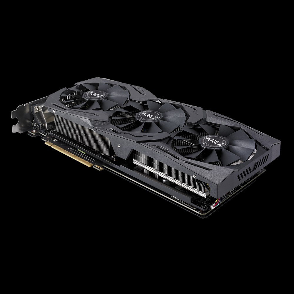

My new graphics card, an Asus Vega 56. Should arrive Wednesday.

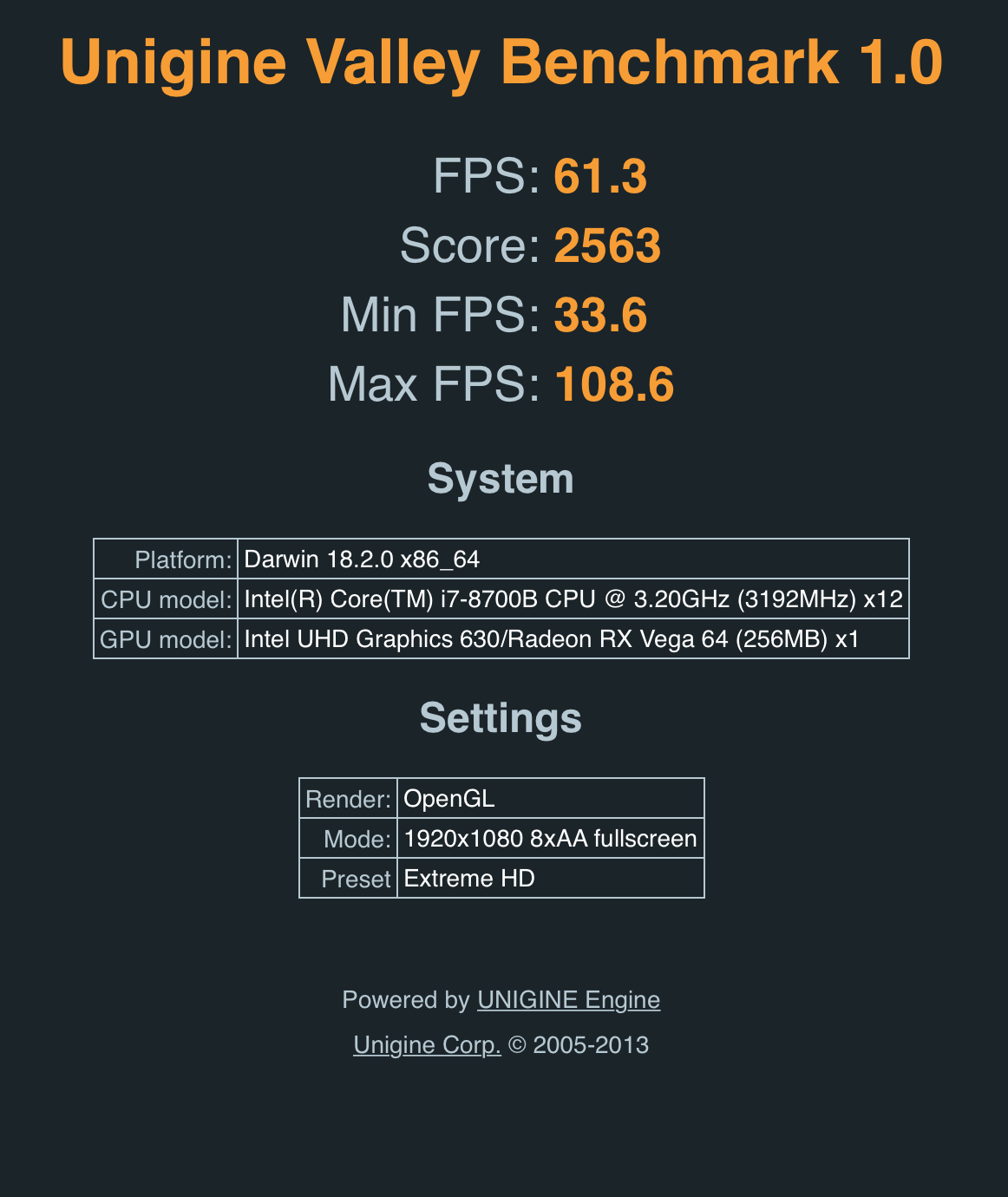

I ran one more Unigine Valley on Extreme HD settings after a fresh reboot and got slightly improved but quite similar results as before. From what I am reading, the Vega 64 at best benchmarks 10% above the Vega 56, which seems to be borne out by my and Poakwoods' results.
