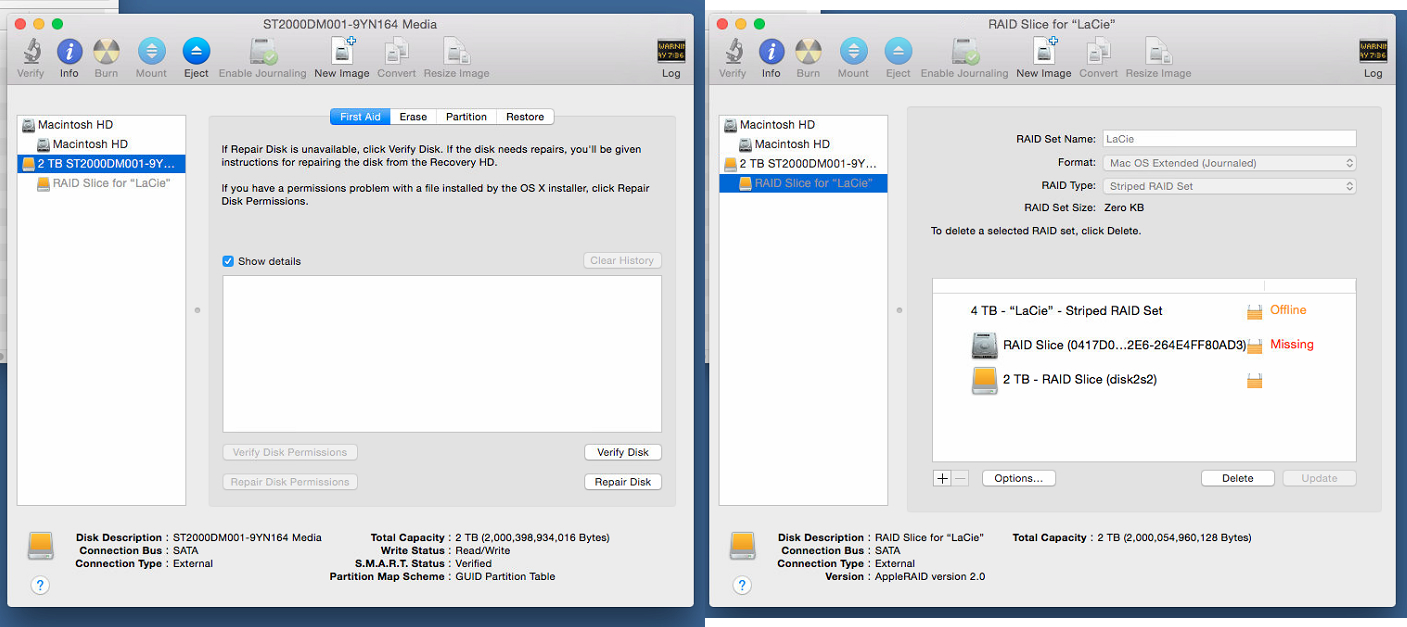

I ran into same issue. To gain access to drive, open disk utility and right-click on drive and select either "reveal drive in finder", or if that doesn't work, select "open drive", you can then select "get info" to check ownership, etc., try some of the other suggestions given here to get your drive to mount and show up in Finder. But in the meantime, you will have access to your Time Machine files.
Hello All, I've through many forums and this is the best one I found to describe my problem:
Only shows in Disk utility
Hard drives spins fine
I have verified and repaired many times
I have ejected many times
I have reset the computer many time
I have unplugged it and let it sit for days
I have changed the ports I use
The mount option is greyed out
Lacie Stripped Raid is "Offline"
Lacie Raid Slice is "Missing"
The repair and verify say "no errors" and "OK"
Any idea as to what is going on?
its a 4TB (2tb+2tb) HD using the thunderbolt port
Thanks for your time
is the hard drive partition greyed out too? or is it solid?
Volume Name
Partition Name
Could be the external enclosure, something with the chipset or power supply.
If you boot into the recovery partition does it allow you to mount in DU there?
The partition does seem to be greyed out as well. I'm not quite sure how to boot into the recovery partition...
