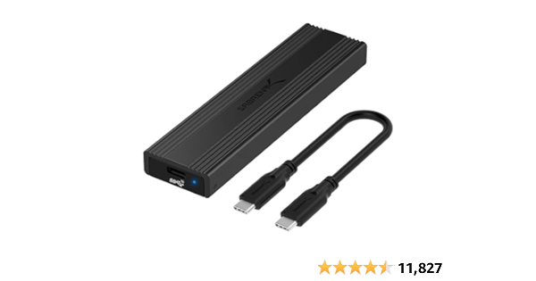

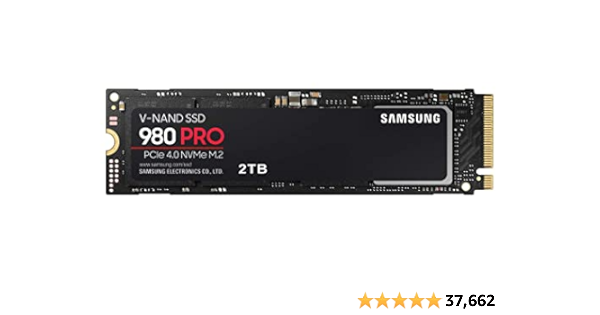

add ram brings you to 680. than add the useless setup from above for 280. gets you to 960 with a fairly good size ssd 2tb
this case
this ssd
that case and ssd would cost 220 not 280
so 680+220= 900
for a 16gb ram
2tb ssd
and 100 usd gift card.
