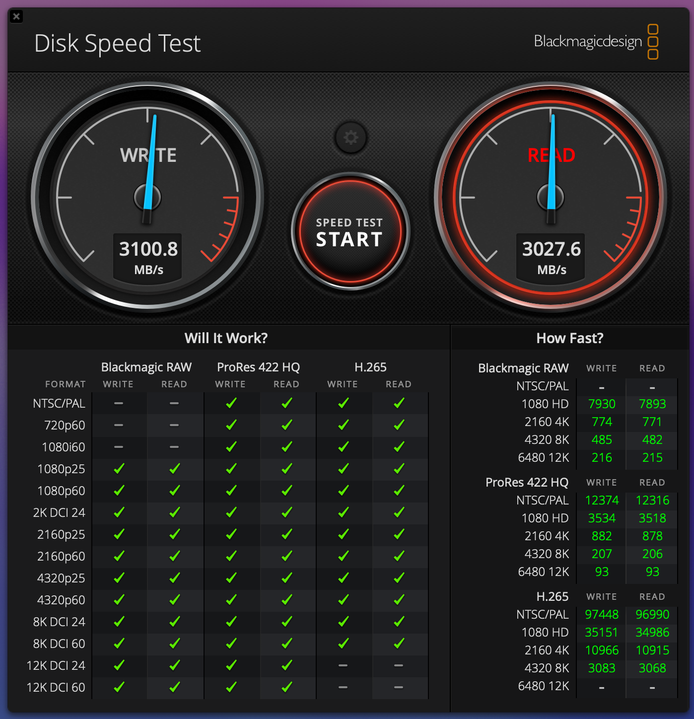

I have tried two separate 40Gbps SSD enclosures (a Ugreen and now an Orico), and the behavior is the same. The cable is a nice thick USB4 40Gbps cable, so there's no issue there.

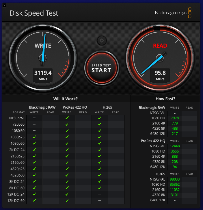

My Blackmagic speed test results are below. It'll report these speeds consistently.

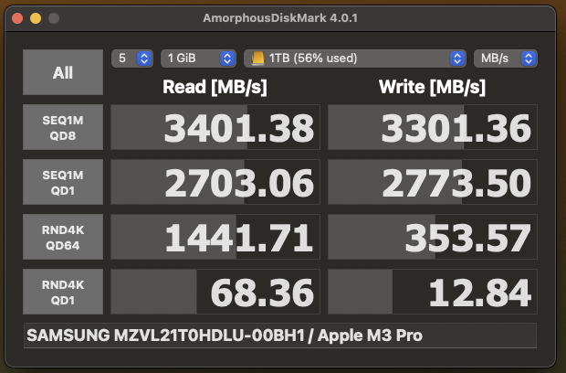

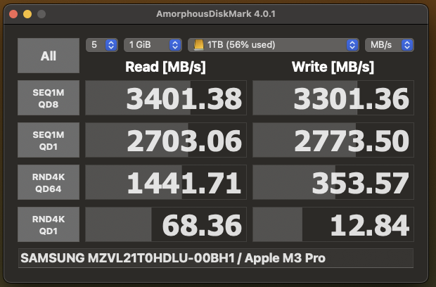

Paradoxically, AmorphousDiskMark gives me the speeds I would expect for a properly functioning external drive, but as I said, in real world performance it's miserable, games and files are taking forever to load etc.

P.S.I'd be curious if your AmorphousDiskMark results change if you increase the file size to the max (there are so many caches in the chain these day, it's hard to know what you are exercising with just 1GiB).

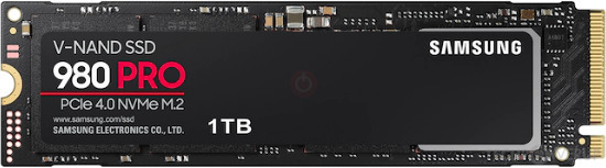

I think you might be unlucky here in that the Samsung 980+ have reported problems with TRIM under recent versions of macOS and the SK Hynix Gold had other reported problems:
I realize the above is for Hacintosh systems and boot drives but I believe the underlying issues are still applicable. Samsung apparently did release a firmware update to address the TRIM issue for 970 EVO but has not addressed the issue in any later drive. Your PM9A1 drive is apparently an OEM version of the Samsung 980 Pro. There does appear to be a firmware update for the SK Hynix Gold (aka P31) drive to should make it work well under macOS (all else being equal...):

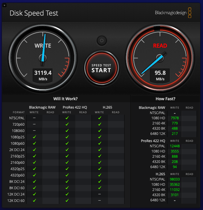

Update -- and this is really interesting. I have a Dell monitor with an integrated Thunderbolt 4 dock which I use as my primary external monitor. When I plug it into a standard 10Gbps USB-C port daisy-chained off the monitor/dock, BlackMagic shows more correct R/W numbers, in this case maxing out the 10Gbps link. Truly bizzare. This is with the same USB4 40Gbps cable and Orico enclosure. I'm really thinking macOS is trying to be too smart and manage the drive's power state etc when it's on the Thunderbolt/USB4 link.
In fact, under System Information, it does come up under Thunderbolt/USB4 when plugged directly into the MBP, but it comes up under USB when plugged into the monitor/dock which has a completely different arbitration method/service in macOS.
Yes agree this configuration drives a completely different set of drivers/pathways. Former tunnels PCIe through USB4 to make the SSD appear directly accessible to the system via NVMExpress while the latter connects host's USB controller to ASM2464PD through UASP and then the ASM2464PD talks to the SSD via NVMExpress.
Then seems likely some sort of macOS versus ASM2464PD issue possibly resolvable with updated firmware for the latter. That is ASM2464PD works fine when it serves those SSD up via UASP but not when it enables the more direct connection to those SSD over NVMExpress.
Hopefully not some sort of SNAFU across the entire macOS/Apple Silicon/ASM2464PD/Samsung chain...which would be a lot to work through...

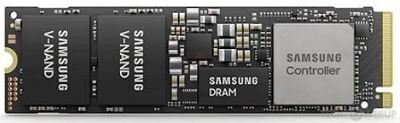

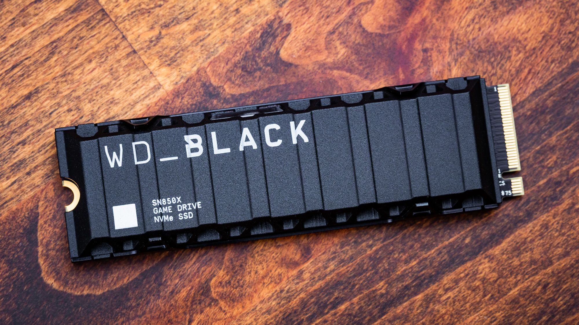

Those have generally worked though I would get the WD SN850/SN850X if available for an extra $30 if possible. The SN770 is a DRAM-less / Host Memory Bus (HMB) design that aren't ideal for use in external enclosures.
Not sure if Samsung has released updated firmware for the PM9A1 / 980 Pro and even if it does if it will address your issue (more than one person has reported issues with Samsung 980+ drives due to compataiblity issues around TRIM starting in Monterey and it appears Samsung is not going to fix it so those people had to switch to WD).
You should be able to find firmware for your Hynix P31 SSD though. You mentioned it was already updated and not sure if an even later firmware would address your issue but that is the one last thing I would try.

Yes I don't believe you'll be able to get firmware updates for the Samsung PM9A1 as a non-OEM purchaser. OEMs probably get not just the firmware but a toolkit that let's that tweak different firmware parameters for their particular needs. Anyway, you could try pushing a Samsung 980 Pro firmware onto that SSD as they appear identical:
though Samsung may block that from working for market segmentation reasons. Then even if it works it may not fix your issues as I've heard other people having trouble with recent Samsung (after the 970 EVO) even with their latest firmware.

I ended up picking up an SN850X, found a good sale and bought it for $15 more than a 1TB SN770, so definitely worth it in that regard. And of course, as soon as I formatted it and gave 'er a test:
Darned impressive numbers, maxing out the USB4 link for sure. Apple and macOS really just like the WD nvme controllers. Which brings me to what I've discovered is incompatible about the Samsung (and potentially the Hynix drive as well, though as we've discussed it's not confirmed whether I truly tested it with the latest firmware or not).

Yeah, no luck with the firmware, but what I have figured out is why it hates the Samsung drive especially. It all has to do with power state management...which macOS is not doing a great job with. It appears to be going into a low power state when not in use. Naturally, the writes "wake" the drive up, but then it returns to the low power state and the reads absolutely suffer.
AmorphousDiskMark loads the drive differently, and keeps it in the high power operating state. Blackmagic and regular use just don't put the drive in a high enough power / activity state for reads to perform where they should.
