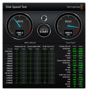

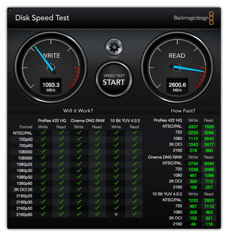

On Amazon (https://www.amazon.com/ask/questions/Tx2S7R4LITM50Z5/ref=ask_dp_dpmw_al_hza), I found a review of the owner of the same case as mine (Thunderbolt 3 - Orico TOM2T3-G40 transparent), which indicated the speed of work 1321MB/s 2602MB/s. He also tested with Mac mini M1 with Samsung 970EVO Plus
After upgrading Big Sur to the latest version, I again decided to measure the speed of my Samsung 970 EVO Plus 1TB in the ORICO box and received almost 1100MB/s when recording, instead of 800MB/s earlier. I don't even know what affected it. Although this is much less than expected, it is already better than 800MB/s 🙂
Can't confirm that. Same 850 MB/s as before, sadly (macOS 11.1).

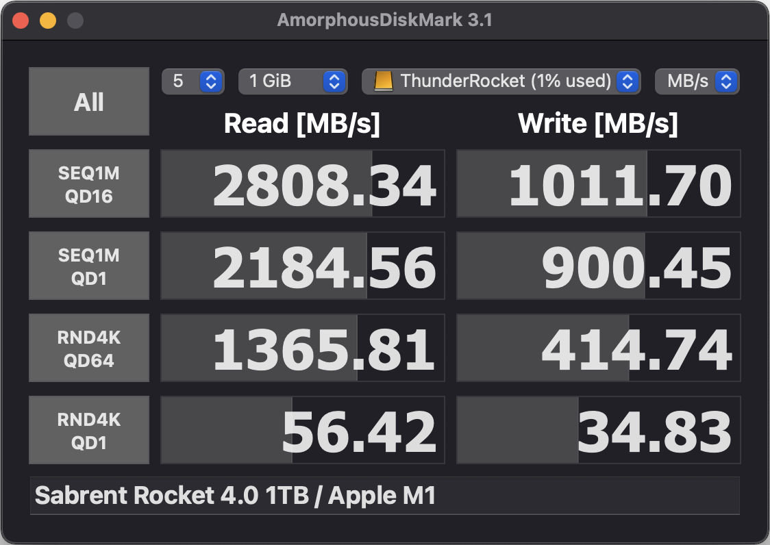

I tested the 1TB Sabrent Rocket 4th gen NVMe on my Orico TB3 aluminium enclosure.
On BlackMagic disk speed test I get:
2520 MB/s write, 2560 MB/s read
On AJA System Test Lite I get:
1742 MB/s write, 2561 MB/s read
Amorphous paints a very different picture:
Sabrent Rocket 4.0 1TB : Apple M1.png

Sometimes there's a slow down. Have all three apps open at once. Cycle through each test one at a time a few times in each app until the numbers are more reasonable.
Amorphous -> AJA -> Blackmagic -> Amorphous -> AJA -> Blackmagic -> ...
