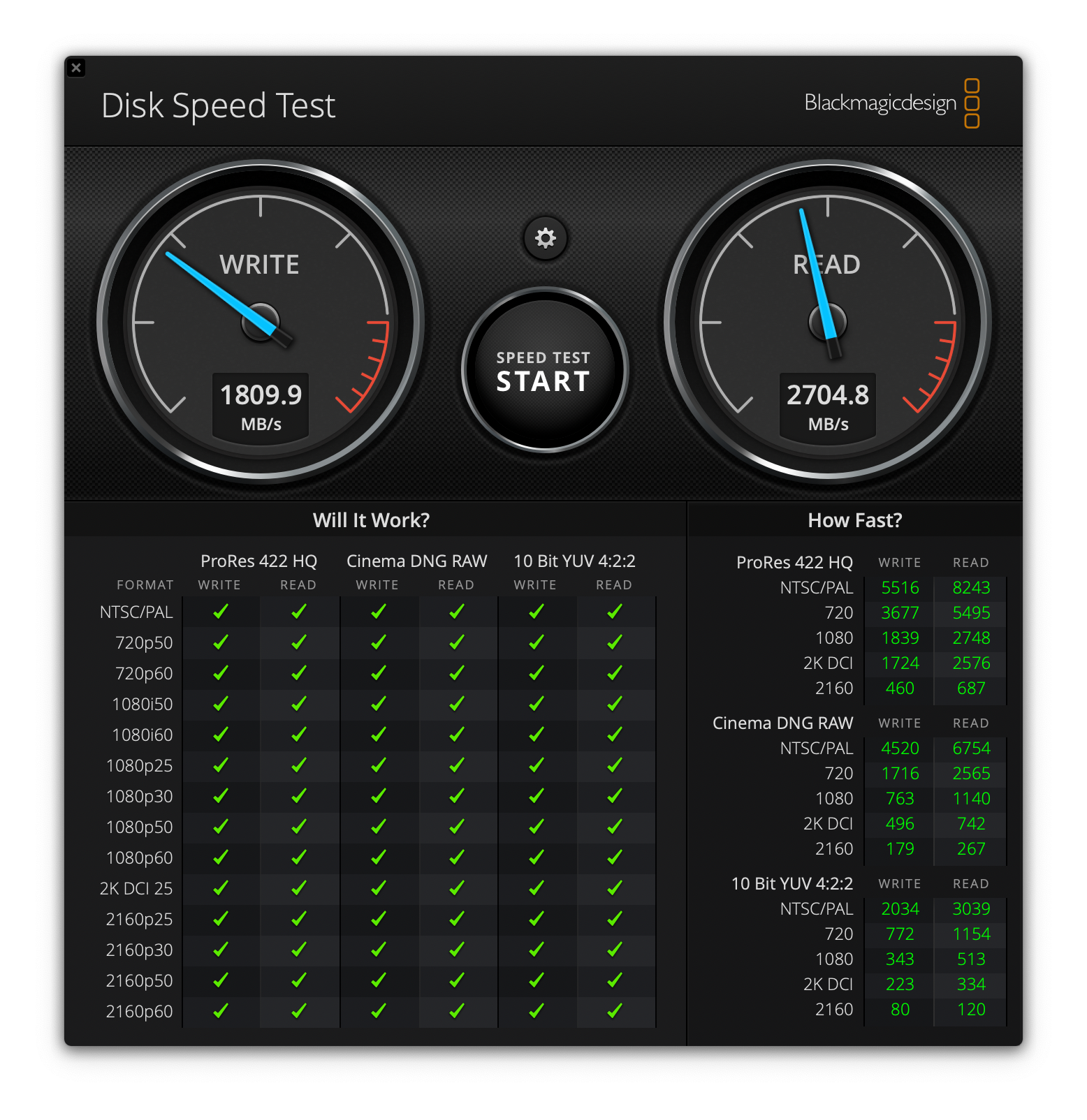

With the Orico M2V01 and a Sabrent 4 TB Rocket (SB-ROCKET-4TB), I get 1.700 - 1.800 MB/sec write and 2.700 - 2.800 MB/sec read on a 16" M1 Max. I confirm that Evo Plus drives (at least the 2 TB model) have a write speed problem with thunderbolt enclosures.

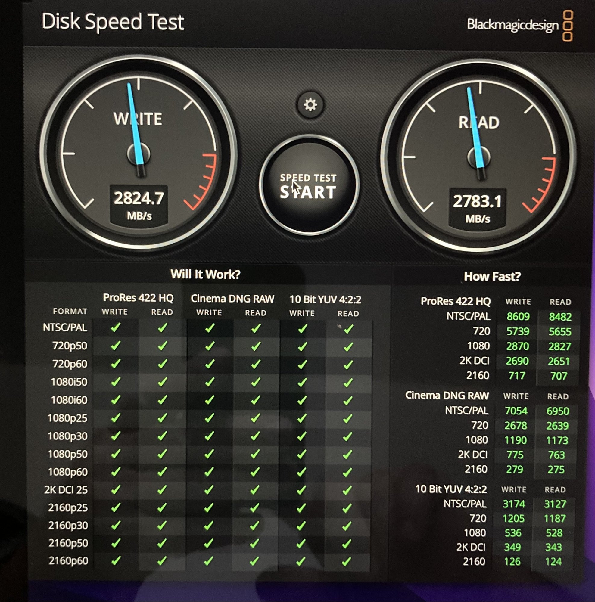

Looking at the 'Total Power' reading from iStat Menus, it seems like the Orico - 4TB Sabrent combo is using 3-4 Watts idle and around 24 Watts when copying a 100 GB folder.
Here is a test I did a few minutes ago for the Orico - 4TB Sabrent combo (16" M1 Max) :

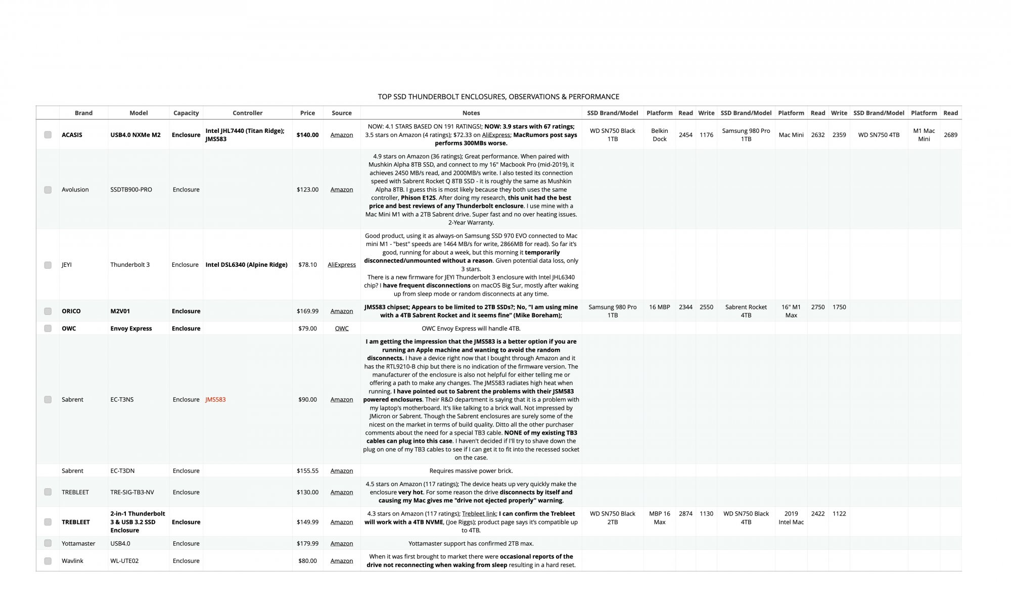

I have created a spreadsheet with all reported test speeds I could find with poster comments, pricing, etc. Bold-faced entries are the most favored enclosures. Your Rocket speed is undoubtedly the fastest writing speed ever reported on an M1-based Mac. If that is confirmed, that would be the best combination to get. 🙂
Reactions: MrAverigeUser

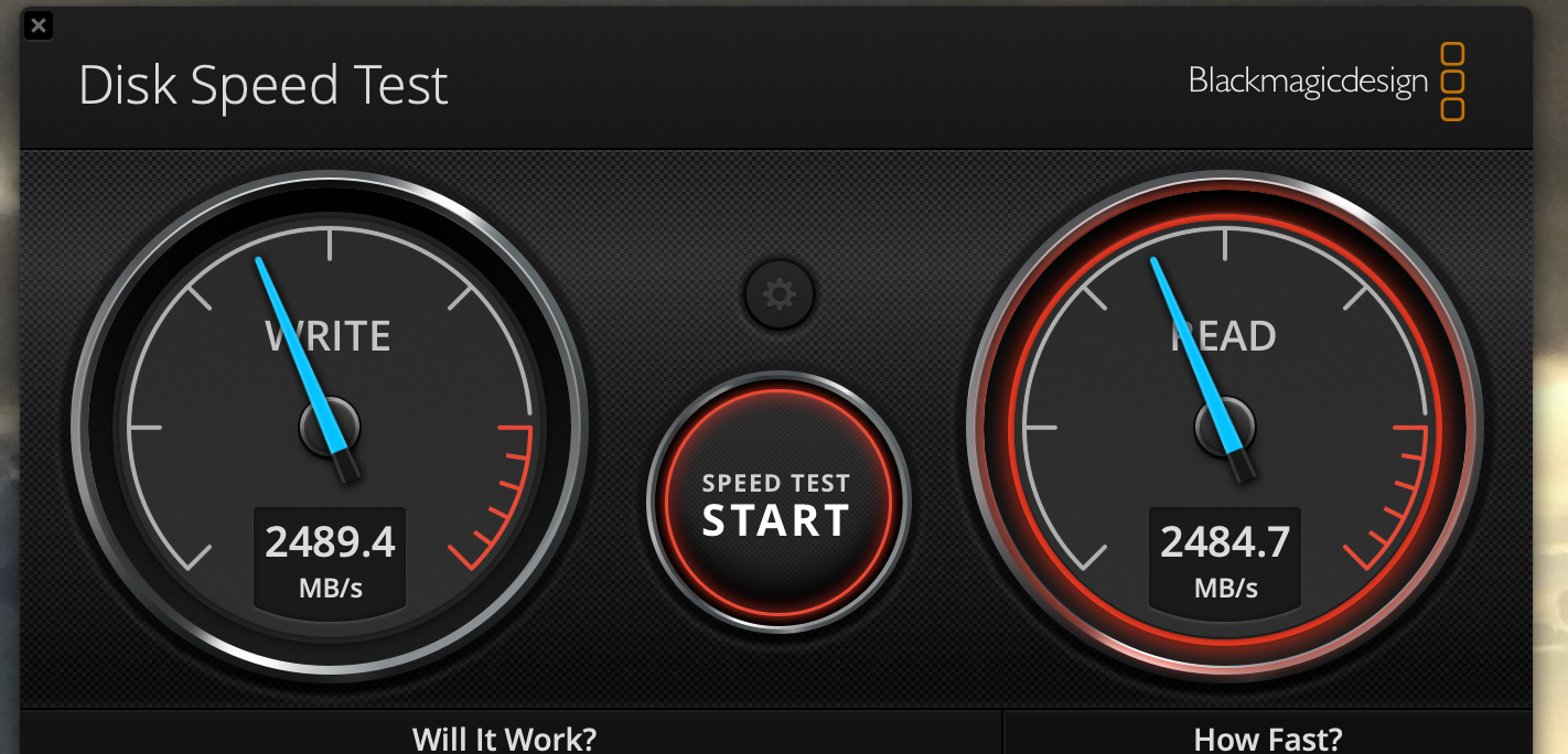

Samsung 980 EVO pros. Disk speeds aprox 2450MB/s read and write.

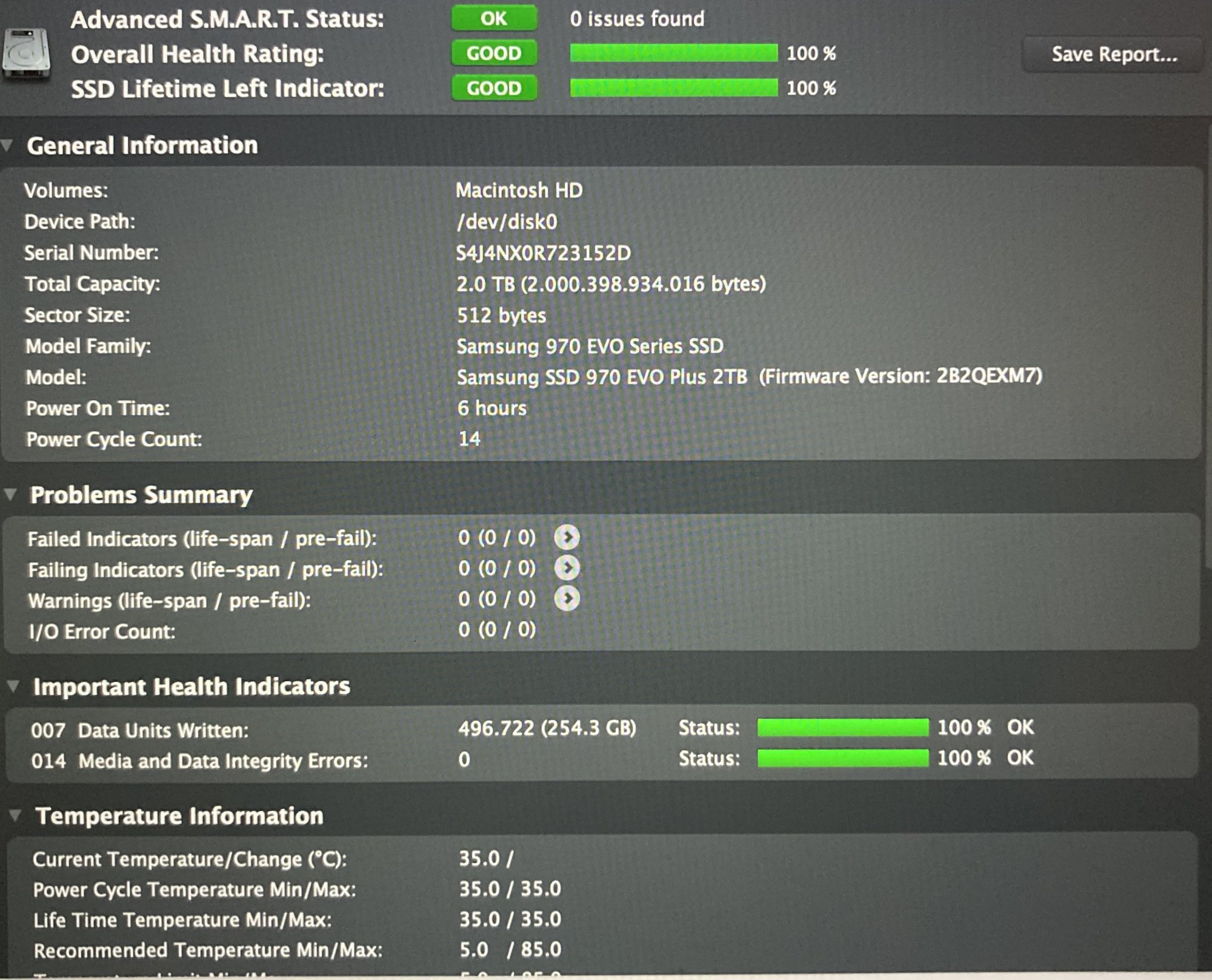

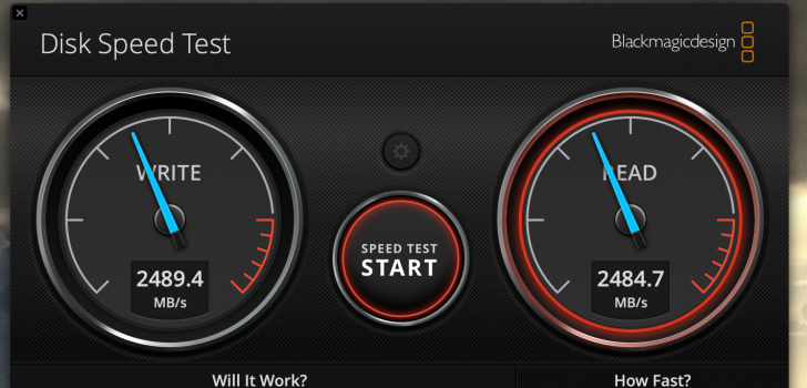

Below the Disk Speed Test results for the Samsung EVO plus 2 TB (produced in July 2021) inside an Orico TB3 enclosure (the SCM2T3-G40) connected to a 16" M1 Max. The write speed is slower than expected, and definitely slower than the Sabrent drives 2 and 4 TB I own.
Forgot to add : firmware version for the Samsung drive is 2B2QEXM7
