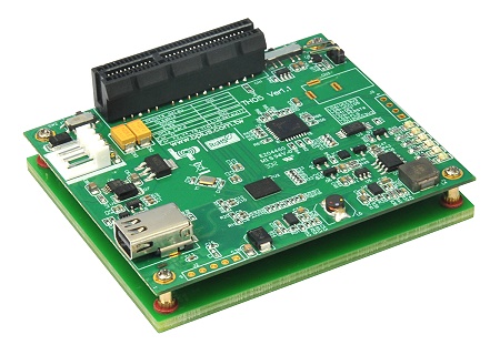

What is wrong with TH05? It is quite solid and cheap -
full kit costs just $180, with Thunderbolt cable included!
http://www.hwtools.net/Adapter/TH05.html

It is not a "noname Chinese knockoff" - BPlus is an official member of Thunderbolt group.
Attended Intel Thunderbolt Technology Plugfest this year. That means some reputation.
If Sonnet will cost $250 with cable, I would prefer Sonnet like you - because of nice Mac-style external design.
However, I cannot justify spending more. Probably because Sonnet solution is universal, it costs that much.
It was designed for other purposes - professional audio & video, not with eGPU in mind.
In their PCIe Card Thunderbolt Compatibility Chart, there is no mention of eGPU at all.
Meanwhile, TH05 was created specifically for eGPU enthusiasts.
Please take a look on this thread: http://forum.techinferno.com/diy-e-gpu-projects/2513-how-we-measure-rank-describe-our-systems-no-more-%401-2opt.html
oripash, prominent eGPU enthusiast, has tested both TH05 and Sonnet.
And while results are in favor of Sonnet (+12.3% performance) because of more advanced hardware design,
the current price difference does not justify it at all.

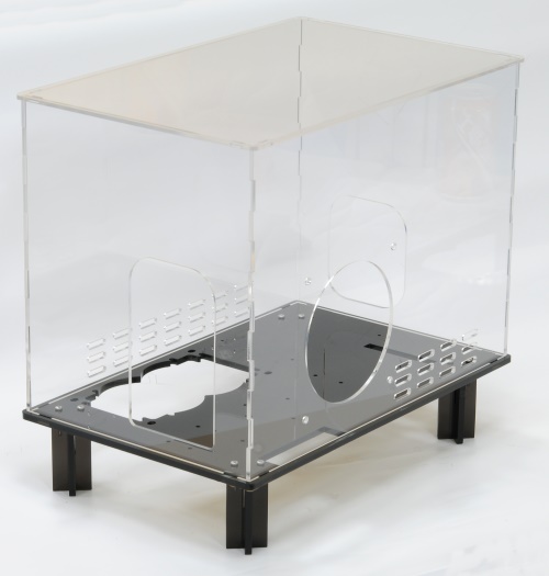

EDIT: Just discovered that it is possible to buy a nice crystal DIY box ($60) for this adapter:
It would be pretty funny to have that kind of transparent box, with all the graphics stuff on display, like that on your desk!

Not so much universal but a complete system solution. There is no power supply in the TH05. No case. No second Thunderbolt Port to daisy chain. It looks likely might have snagged the lowest end TB Controller ( PortRidge with 1 TB channel ) that is meant for dongles/end cap solutions.
This board is a subcomponent in a solution.
There is additional overhead with Sonnet because they have actually tested complete systems and worked on certification with card vendors. That takes time and money because selling a verified solution as opposed to a subcomponent.
The prices will probably drop as the 'copycats' flow into the TB market after others have developer a proven set of reliable designs and worked through all of the major issues.
That is a highly dubious assertion since it apparently artificially limits the PCI-e connection to x2. There is a x4 PCI-e connection on a standard TB controller. There are no other slots or connectors here so where is the other x2 PCI-e worth of bandwidth connected to here ?
Most GPUs want at least x8 of connectivity. Going from x4 to x2 is going in the opposite direction of optimization. What is being optimized here is inexpensive, not affinity to GPUs. "enthusiasts" is really "people on a limited budget".
