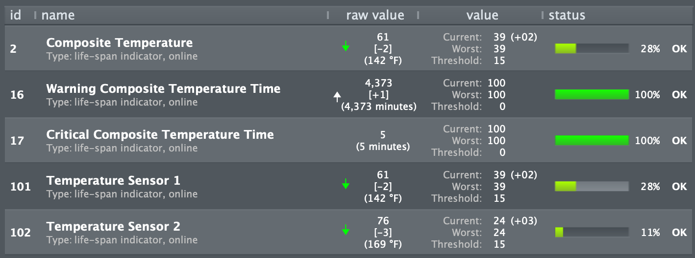

I have a Samsung 980 PRO 1TB PCIe 4.0 NVMe in an Acasis TBU401 Thunderbolt 4 enclosure (https://www.amazon.com/gp/product/B08P7L6SDD/ , https://www.acasis.com/blogs/shopping-guide/tbu401-vs-tbu405-what-s-the-difference-keep-updated).
Since I stream watch on my Mac Mini (which has a small 256GB drive), I run and offload my Chrome profiles off the drive along with a few other items and programs.
Unfortunately, it's always running hot. This is even with the top plate of the enclosure off so it can get more airflow. This is what it's at currently while running a light 480p stream, browsing Chrome, and just light stuff. I've had a few temp warnings before when there's load on it, so I have concerns.
I tried researching other enclosures but it seems like there's nothing really better out there. So what do you guys all have/do? Do you experience the same issue?
I think you probably made it worse by removing the top plate. It's almost certainly designed to run with the top plate on. Assuming it's metal, it carries heat away from the electronics so it can transfer to the surrounding air. The only way it would make sense to run with the case off is if you actively move air over the drive with an external fan.
My suggestion is put it back together. Warm temperatures won't harm it, even if they feel hot to you. 169 degrees F is well within the normal operating range for silicon.

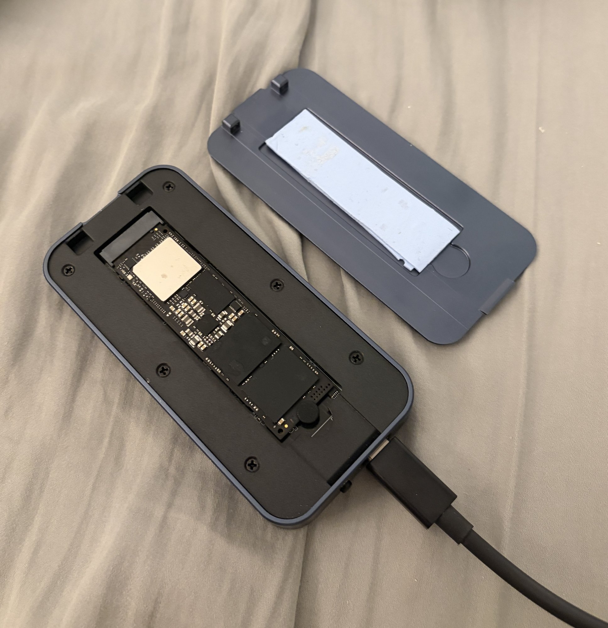

Im using the TB501 Pro (TB5/80gbps) with a built in fan. The fan is auto controlled and sits at 0rpm most of the time, but even when running full blast it is virtually silent. They also include a button so you can turn it on manually proactively when doing a large transfer. I have a Samsung 980 Pro in there, and when i do a large transfer or time machine backups it gets slightly warm but not hot.
I just did a stress test and with blackmagic disk reading and writing 5gb files the temp is steady at 48-49c. I also have two thermal pads stacked on it so it can better transfer the heat into the case.
