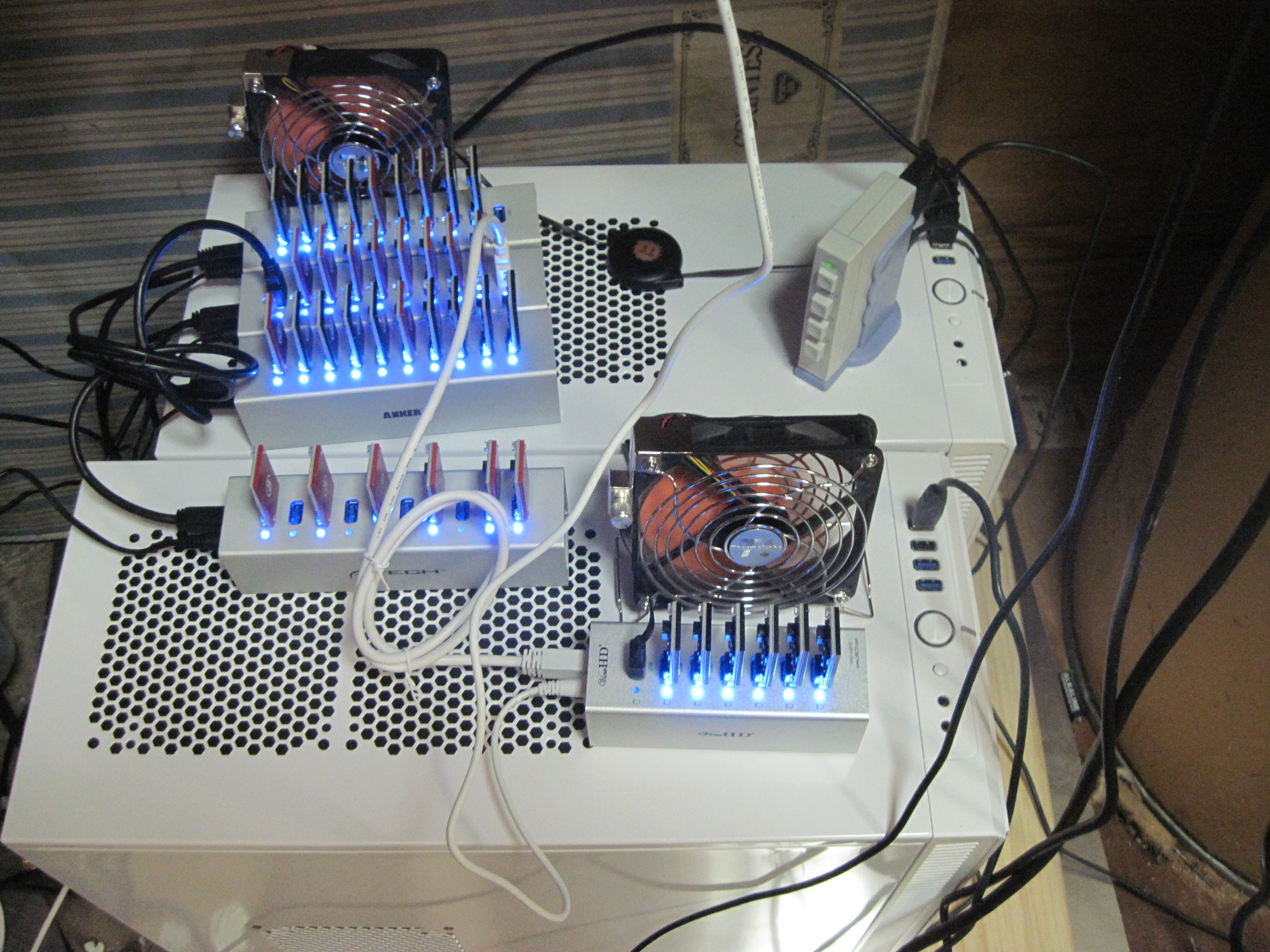

do this with this hub
http://www.amazon.com/gp/product/B00B59BFVI/ref=oh_details_o03_s00_i00?ie=UTF8&psc=1
this has the all aluminum case looks like an apple metal has a robust psu 12volts x 4amps has 7 ports.
I use it with a pc but it works with my minis.
it runs 6 usb asic miner sticks at .5 amps each

As for Phillipma's link to the hub, that looks interesting. Although your pic is kinda frightening with all those lights and fans. I can't quite tell what you have going on there! 🙂
