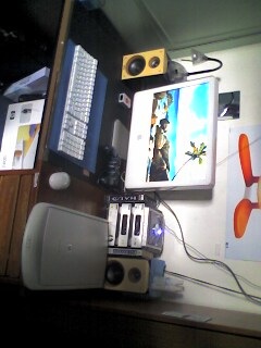

it works fine, had it up and running in minutes. got it after about a week, the quality of the picture is awesome, the box is tiny and its like having sky+ which is pretty nifty (although you can't watch something else while you record) i only have trouble getting channel 4 and the itv channels however they've worked fine the past couple of days.
anyway, heres my setup, 20 inch is quality.
