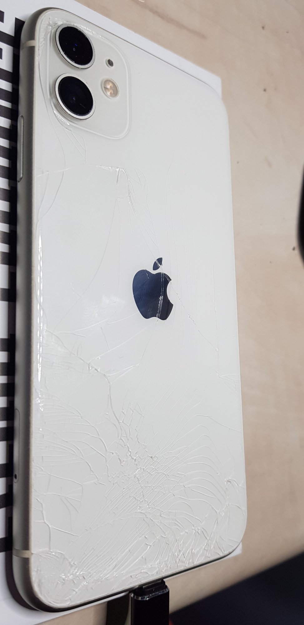

Hi, I've buyed totally crushed iPhone 11.

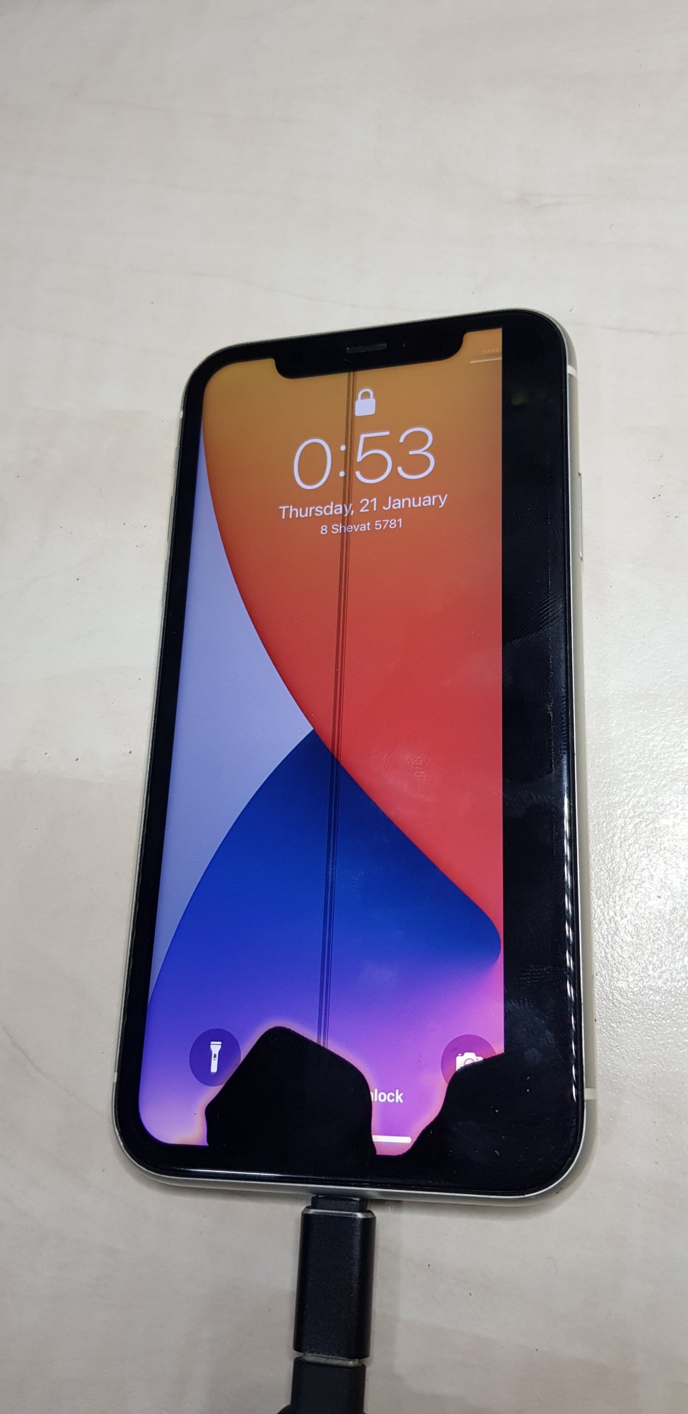

The Face ID is not working, but when I try to set-up him, the camera works fine a few seconds but without the "Green lines" and after some seconds I've got "Face ID is Not Available"
I'm hoping that the Face ID back to work in the moment that i replace the display, what can you say about is there any chance to replace the display without the Face ID and it will back to work?

If you send the phone to Apple for repair, it will work as expected. If our try fixing yourself, it probably won't work.
If the faceID module is damaged (likely), I think Apple has to swap it out and reprogram it to match with the A13 chip.

The Face ID component has to match the logic board on your phone. You can't just swap Face ID component from one phone and put it in another phone.

Yep. There are plenty of Rossmann rants on these kinds of things. It's also a topic of debate within the Right To Repair movement. Specifically with a security sensor system like TouchID or FaceID I can see the argument to some extend to avoid situations with a modified sensor that sends a preprogrammed signal all the time, so when the user re-registers their face it would actually unlock on any signal. And it binds the cryptography to the key signatures generated by the hardware of the Secure Enclave. At the same time however it is partially a nuisance on the repair front that could be avoided without a significant dip in security by using other tricks instead. - That's for the security sensors specifically. Other tricks Apple have pulled to fight repair have been just indefensible.

As @Apple_Robert has stated, the FaceID module is paired to the logic board and can only be repaired by Apple.
Echoing the words above, there's not much of an option on these newer iPhones as to whether to have it repaired by Apple or non-AASP repair. Apple is the only one that can recreate the link between the parts. Same thing went for the Touch ID in later home-button iPhones.
