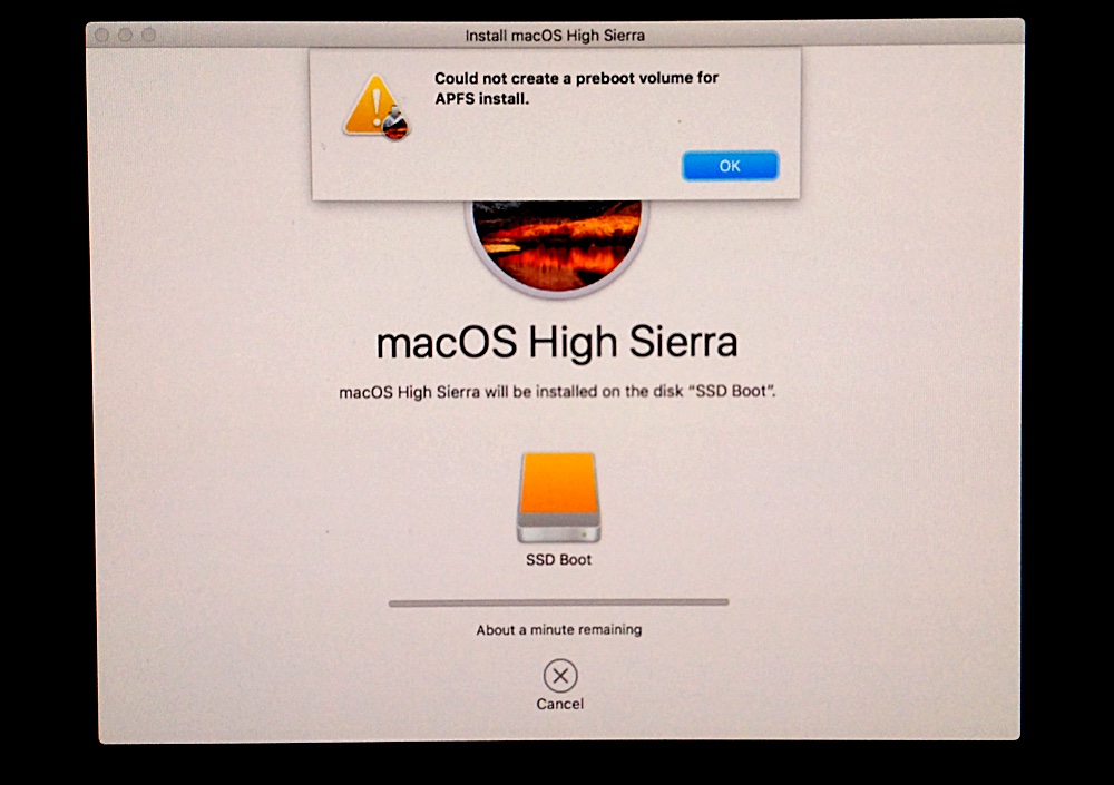

Well this is looking like great fun. I managed to get into recovery mode and erase everything before doing a clean install. 1 minute before the end a message pops up saying a reboot volume could not be created on my drive and that was it. No install. At the moment I'm having to wait for 3 hours and hope that the Time Machine restore goes smoothly.
Yikes. What is your firmware version now? Seems like you are having an EFI issue.
[doublepost=1506547088][/doublepost]And you know, not that I'm too keen on this since I want to obliterate HFS+ from existence, but you could install on HFS+ vs APFS. This reminded me of that.
I'm not sure at the moment, but I know I ran the firmware update before installing the GM version of High Sierra. The Time Machine restore has failed for some reason, so at the moment I am far from impressed by High Sierra. It's attempting another OS install, but if that doesn't work I guess I'll have to pull out the old SATA drive with Sierra and hope for the best.
Is your PCIe SSD in APFS format? If yes, may be you can try HFS+ and let the installer auto convert it to APFS. If not, try the other way around.
Yes it was already recognised as APFS, but everything I tried was hitting a brick wall. It wouldn't let me repair the drive, because it said it was in use and couldn't be unmounted. If I partitioned it one half was healthy and the other apparently not. I tried the HFS+ trick as well, but no luck.
Eventually I tried to restart and it wouldn't let me choose that drive or any other, including Time Machine, so I got it to shut down. When it started up a warning sign appeared and then it booted into recovery mode after an extended period. Once there I was suddenly able to repair the drive, erase it and repair it again, so everything now checked out as being OK. I'm not going through a clean install again and hoping it will work this time. 11 minutes remaining...
[doublepost=1506552758][/doublepost]Update: It appears to have worked and I now have a completely clean install. I could have tried importing data from Time Machine, but I've decided to start from scratch and only install what I really need. I think I'll leave the rest for tomorrow at this point.
