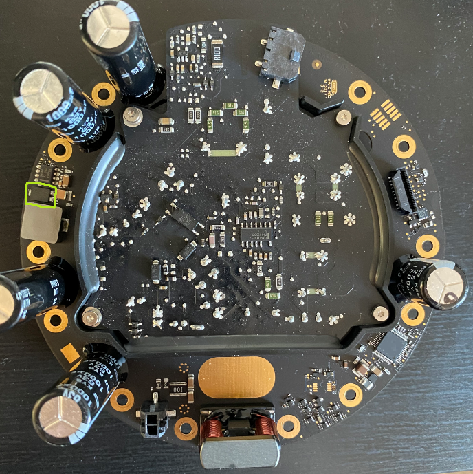

Is your Homepod also getting warm on the outside, if yes and you are good with a soldering iron or hot air station you might be able to repair it.
I was able to salvage two of mine half a year ago.
The catch diode of the buck converter died, shorting the switch node to GND.
After I replaced the diode, everything is working again.

Picture of the diode

Good chance it's the same problem. Mine also got warm on the right side of the power connector, left side on the picture above.
There is no link for the fix, I did it myself.
Looked up some youtube videos how to open it without destruction(ifixit teardown) and then used a thermal cam and multimeter to search for the short.
Trickiest part is to get through the adhesive on the top of the case, where ifixit used the saw.
This is the diode, marked green on the picture above:

Neither, both just completely stopped working overnight. No sound, blinking or WIFI connection, even after power cycling.
The side of the Homepod getting warm was a result of the malfunctioning diode and not the cause.
I just came across this video looks like this guy replaced the same diode you are talking about.
This kinda gives me hope.
Yes, exactly.
When your HomePod just completely stops working and then getting warm on the side, I bet in 99% of the cases this Diode died, which luckily, apart from opening the Homepod without destroying it like in the video, is a rather easy fix.
For all the other, less specific, problems like blinking buttons, random restart, no bluetooth/wifi I suppose the repair will be more difficult if not impossible. My guess would be in most of these cases either a IC/CPU is damaged, or a solder ball broke as result of thermal stress or vibration from the subwoofer.

When your unit failed, was it stuck in a boot loop? Flashing volume lights? Or was it fully dead like it wasn’t even plugged in? The first two (flashing volume lights and/or boot loop) were logic board issues in the units I repaired (swapped logic boards around)
You mentioned one side being warm.. you mean one side of the top touch surface being warmer that the other, or one side of the fabric mesh being warmer? That diode you talked about is on the amplifier board and is closer to the bottom of the HomePod.

Hello, I have repaired six homepods that stopped because of the Diode. Now people are trying to change the Diode without taking care of one thing !!
The fail is because this diode heats up a lot and is melting the thin layer of the pcb protection and grounding with the circuit copper underneath it.
Your board did the same, but when it heats up and grounds, more heat is produced and it gets really stuck on the board.
A couple of videos on the net shows repairs desoldering the diode with a heat gun, BIG MISTAKE in my opinion
If you look at the picture closely, between this diode and the IC above it in the picture, there is a tiny tiny capacitor.
90% of the people trying to desolder the diode with a heatgun, desolder this tiny capacitor and do not see it removed.
It is the size of the dot on your keyboard keys
without this capacitor, the homepod won't turn on, or when you plug it and tap rapidally on the touch pad, the circle lights for a fraction of a second, ONCE
If the homepod shows + and - lights flashing from time to time, and doesn't reset, means that the motherboard EPROM was not updated fully, and the startup program was interrupted when it was updating.
It is like when updating a BIOS , and you pulled the plug in the middle of the programing.
The motherboard program must be re-written, and I presume it could only be done at factory, or someone could pump it from a good motherboard with proper material, and re-write the program on the bad one
tiny capacitor at the tip of the red arrow in picture
If you don’t use a heat gun how do you get it off?
tiny bead of flux on it, soldering iron with an angled tip as large as the diode, and iron at hottest setting.
First the bakalite casing will split by heat. Then at a certain moment, the whole diode gives up

Yes, exactly.
