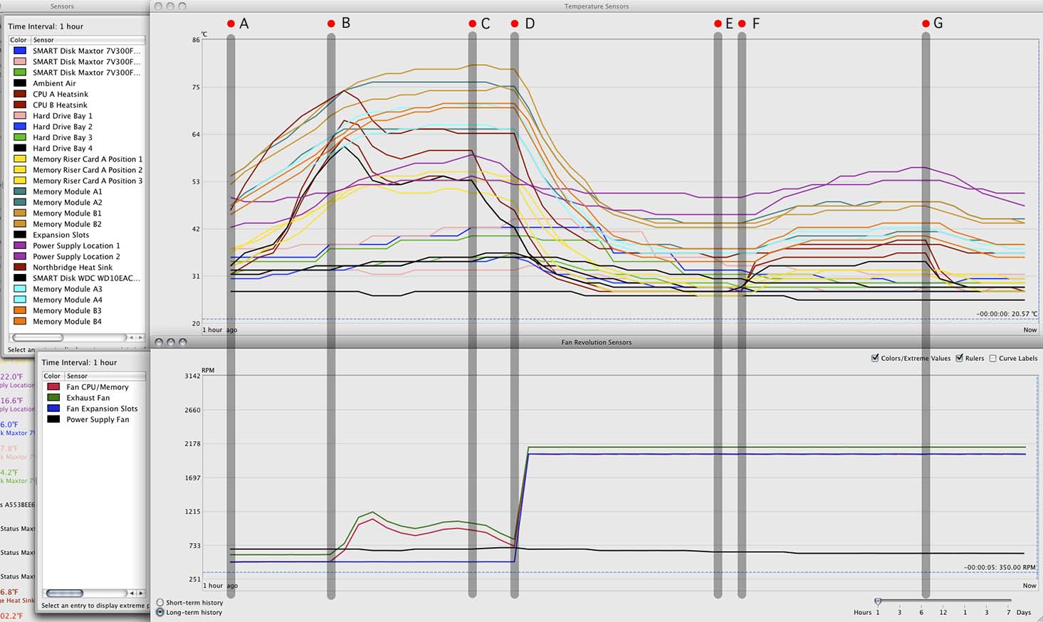

Fan control allows for adjustment depending on room temps, load cases etc, you adjusting it by hand is a waste of time.
Its FAR superior to smcFanControl, and I have both installed on my MBP and just Fan Control on my MP.
MBP: 1000RPM up until 40C, then increases its way up to 6000RPM at 70C or over. Safari/MSN/Email load, the temps sit around 45-50C and 1800-2200RPM, would you bother doing that with smc? If you do then you have more free time than I do!
MP: It would be (when it works - currently 1200 up to 40C) 500RPM up until 40C then increase up to their relative maximums at 90C.
At 100% load it sits at 65-75C core temp and 1200-1500RPM for intake/exhaust and 1800-2000 for CPU fan.
smcFancontrol IMO is redundant app now, I just use it to display the temp and fan speeds on my MBP.
It won't go above your personal temperature, as if it increases the fan speeds increase, it levels out when it finds a equilibrium and every day this equilibrium is different!

As for the app, yes it is still buggy! (My Mac Pro 2009 version that is, the MBP version is perfect) Because im not a proficient coder! Someone who knows exactly what they are doing would have fixed it by now. I don't have access to all the temp sensor codes for the HDs, GPU, PSU etc. And yes, that is the app I use on my Macbook Pro, and does the job perfectly. There is a extended version which does left and right separately but i found it pointless.
The version im trying to edit for my MP is a version that was first intended for the iMac, and i've changed it to three zones, PSU, PCI(HDs) and CPU.

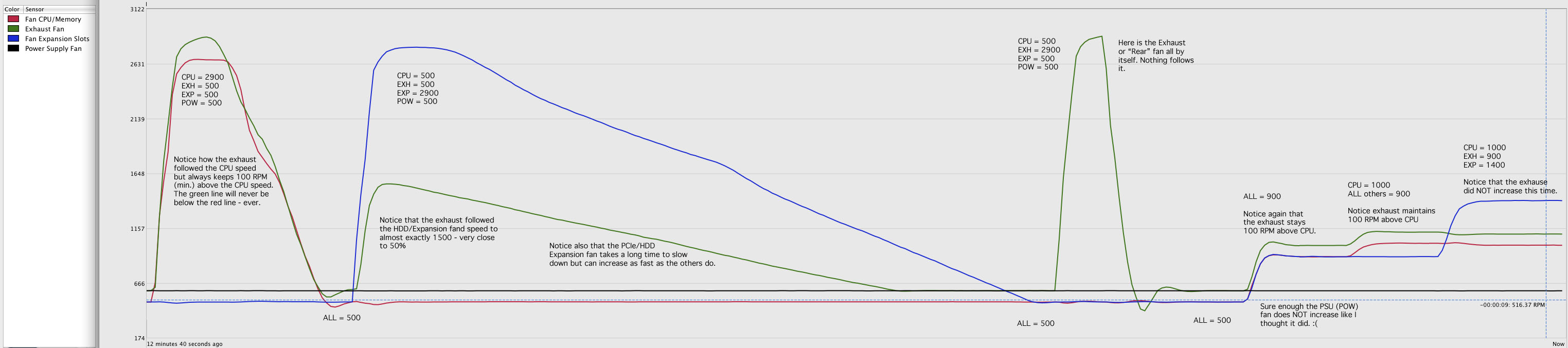

The intake and exhaust are linked and the CPU fan is 142.5% of those speeds, so I just increase the F2Mn and the thing adjust accordingly to what I suppose apple thinks is a equal flow. Not going to argue with that! smcFanControl does the same thing so its not a 'bug'.
If the CPU increases in temp after 40C then yes, the fans start to increase. When the temps drop then the fan decreases to my set minimum. So they are never working harder or making more noise than is necessary!
For example now, ambient temps are up 4C from earlier, CPU intake/exhaust are up 200RPM and main CPU is up 350RPM. CPU core temps are up only 2C, thanks to the increase in fan speeds.
And yes that is how it works, except it does it better than that. It works out the *exact* fan speed to correlate with that temperature along the line, eventually it gets to a equilibrium. Drops in temps, decreases the speeds.
If you want it to increase quicker, you set the min temp and max temp start values for me 45C is minimum up to max at 80C, so it works out the RPM per degree and works it out from there.

  • Apple's defaults are applied and a render using 100% on all 8-cores is started.
    No drive activity is initiated and none besides a 2 MB file project load occurs. The PCI Video card is also not stressed AT ALL and is operating under similar conditions to that of doing nothing but displaying the default desktop.
  • CPU heatsinks become 65c and 72c and Apple decides to increase the CPU fan 250 RPM (not an interval of 1000).
    The heat continues to rise and they up it another 500 RPM. And then another 250 RPM increase before they decide things are cooler.
    Well, the CPU Heatsinks are cooler yes. But almost everything else RAM, PSU, HDDs and PCI cards are not affected and still on the rise.
  • The render finishes and the CPU speeds return to typical idle rates.
    Notice how pretty much everything except RAM and CPU is remaining at the same temp and the HDDs are even continuing to increase temperature. The system will run hot like this at idle for about an hour before we see any noticeable temperature reductions from the other sensors. If another render is preformed in the interim some temps will actually go up higher and stay there while the rest of the system runs hot.
    This isn't the 1st time I've done this. If I let it go with a few more periodic renders the HDDs will be at 60C ~ 65c and never ever cool to below 50c. The Max operating temperature for these drives is 55c. 🙁 Apple's default drive that came with the system profiles the same and with the same MOT - very bad.
    Also while there is no sensor located at the inner-most end of the PCIe boards (that I know of) I bet that because of the CPU's recent activities that this area of all connected cards is cooking right about now.
  • The Internal S.M.A.R.T. sensor in HDD1 is reporting 46c and a bell in my system starts ringing. Ding! 😀
    My defaults for periodic rendering in springtime are applied manually using smcFanControl and immediately the system starts to come back within a sane temperature range for trouble-free, long-life, operation. YAY!
  • Things will still get a little cooler but this is about it. Good enough. So I load back up my 3D application (Lightwave 3D v9.6), and proceed to load back in the same scene and objects I did previously at point A above.
  • I begin rendering just as I did a few seconds after point A.
    However this time heat is being drawn AWAY from the CUPs and out of the system fast enough that my HDDs continue to cool down! Sweet! The CPUs reach about 45c max durring the render. And the 1 minute frames also render 3 to 5 seconds faster than they would if Apple were allowed to mess it up again with 70c ~ 75c CPU temperatures. This is tested and proven.
  • The render is finished. The PSU sensors are now detecting the highest heat in the system at 57c. The curve rate for their thermal exchange is different than Apple's method but are overall cooler than Apple's too. Too bad they won't allow me to control those as well. I think I've just proven I know how and am better suited to control the fans than Apple is!
    After the render the system soon returns to an idle temperature suitable for whatever my next task is. If that's video editing then I have a preset for video editing in springtime and will select that next if the "Periodic Render in Spring" is too loud or not needed.
Finally I ask these questions: How many watts do fans consume? 2 Watts? 5 maybe at full tilt? How much are fans to replace? $10? $15? How much are HDDs to replace? How about motherboards? Or video cards?
