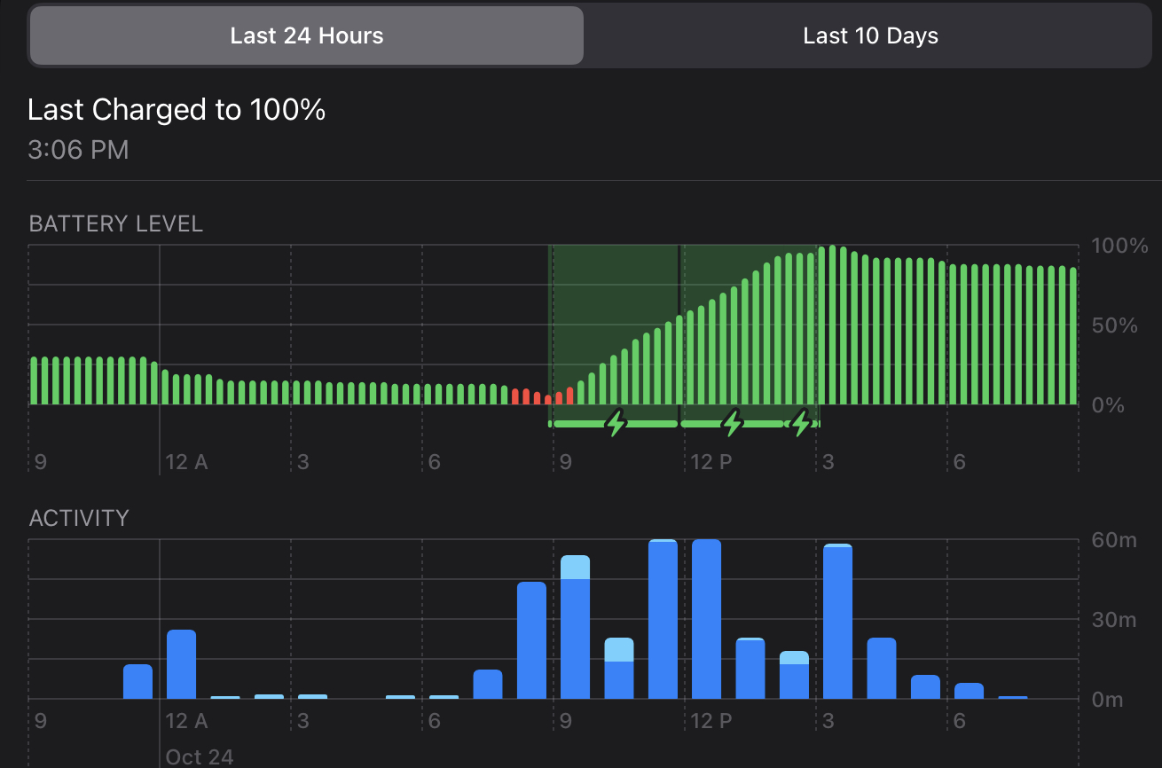

Screenshot of my battery being charged today. I wonder if it’s time to make Use of my AppleCare+. Could something actually be wrong?

Try a different cable first (the Apple one would be good) before you even bother setting up an AC+ appointment.

I've been charging it from completely dead since 7am. It's been 2 hours and 5 minutes so far and it's at 69%. This is without me using the iPad at all.

I was doing a baseline test with what I had been using previously, which was the supplied 20W Apple charger and my same Anker Cable. As you suspected, it was completely full in 3 hours almost exactly. I wanted to see how much of a difference not using the iPad while charging made.
Based on this, I'm going to say my hardware and charging equipment is all probably fine. I guess it really was just the fact that I was actively using the iPad is what made it charge so slow. I'm fine with that, just glad to know something does not seem to be "wrong" with any of my stuff.
Also, I do have a magic keyboard so that could also factor into it charging a bit slower while in use.
