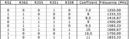

So I dusted off my 2 Mac Minis to see if they could cut it with a little over clocking.. How? Well, you've all seen you can move the resistors around.. I tried and failed to re attach them once removed but found a work around.... A PENCIL! Yup.. the graphite is enough to short the pads and confiure the multiplier, plus, you can rub the thing clean with a normal rubber (this is an american site? eraser, then) and re do them until you find a stable config! Brilliant!
Any Who.. The 1.25ghz is VERY happy at 1.5ghz and the 1.42ghz gets by at 1.75ghz but is much happier at 1.67ghz...

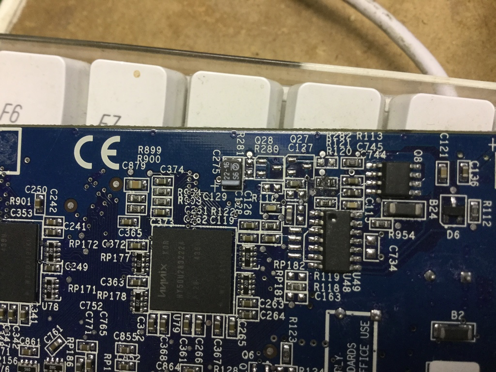

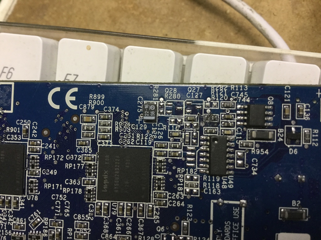

while not directly related to over clocking. I had a Radeon 9600 G5 card where R121 in the pic, a (I think) 3KΩ SMD resistor had fallen off and due to being part of the voltage regulation caused the card to artefact. i was quite annoyed about this as it was decent Core image Card that can also be easily fitted to G4s. so it sat around for a while then i stumbled across this thread and decided Screw it lets try Bridging the gap using a soft graphite stick and rub it in good and well it worked! card works lovely (currently in my PowerMac G5 Linux box replacing a R9200 i had in it) (FYI I do have a 1.42Ghz Mac mini thats currently looking at me in fear 🙂 )
thats my repair Job heh
and here you can see it running 🙂
That's brilliant! the mighty pencil not only overclocks, but it FIXES too! Ha!
My two Mini's were a 1.25 (now at 1.5) and a 1.42 that runs stable, but very heavy on the fan at 1.75. The 1.42 did actually boot and run at 1.83, but fell over a bit to often...
It's worth mentioning I slapped on some replacement heat transfer compound.. I think it's the key to the 1.25@1.5 being so happy.. that, and it was an early 1.25 so had the same heat sink as the 1.42 came with.. I've read that the later 1.2s had a smaller heat sink.

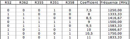

I've got the resistor bridge chart for the various speeds from a site that I kept losing and isn't in english, but they seem correct, if anyone wants me to post them up here?
Back to the internet... a 6 month old browser doesn't scare me.. as long as it's stable and I don't do anything stupid I think I'll be ok.
So do we think this flash plugin I linked removes some kind of processor cap, then? Does anyone know for sure? Or did anyone ever watch the missing video about it? It definitely improves my video playback and just getting youtube to fully buffer under flash is brilliant as TenfourFox was just sluggish on my system.
thanks 🙂 it would be Nice if you could post your jumper chart as i have only found one that goes past 1.58Ghz, and its really low res so its hard to make it out (I can if i look very closely but if you have a better one on hand that be nice 🙂 ) also this is my 500th post woo (if this was the old forum software i would be able to get an avatar now heh)

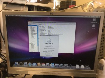

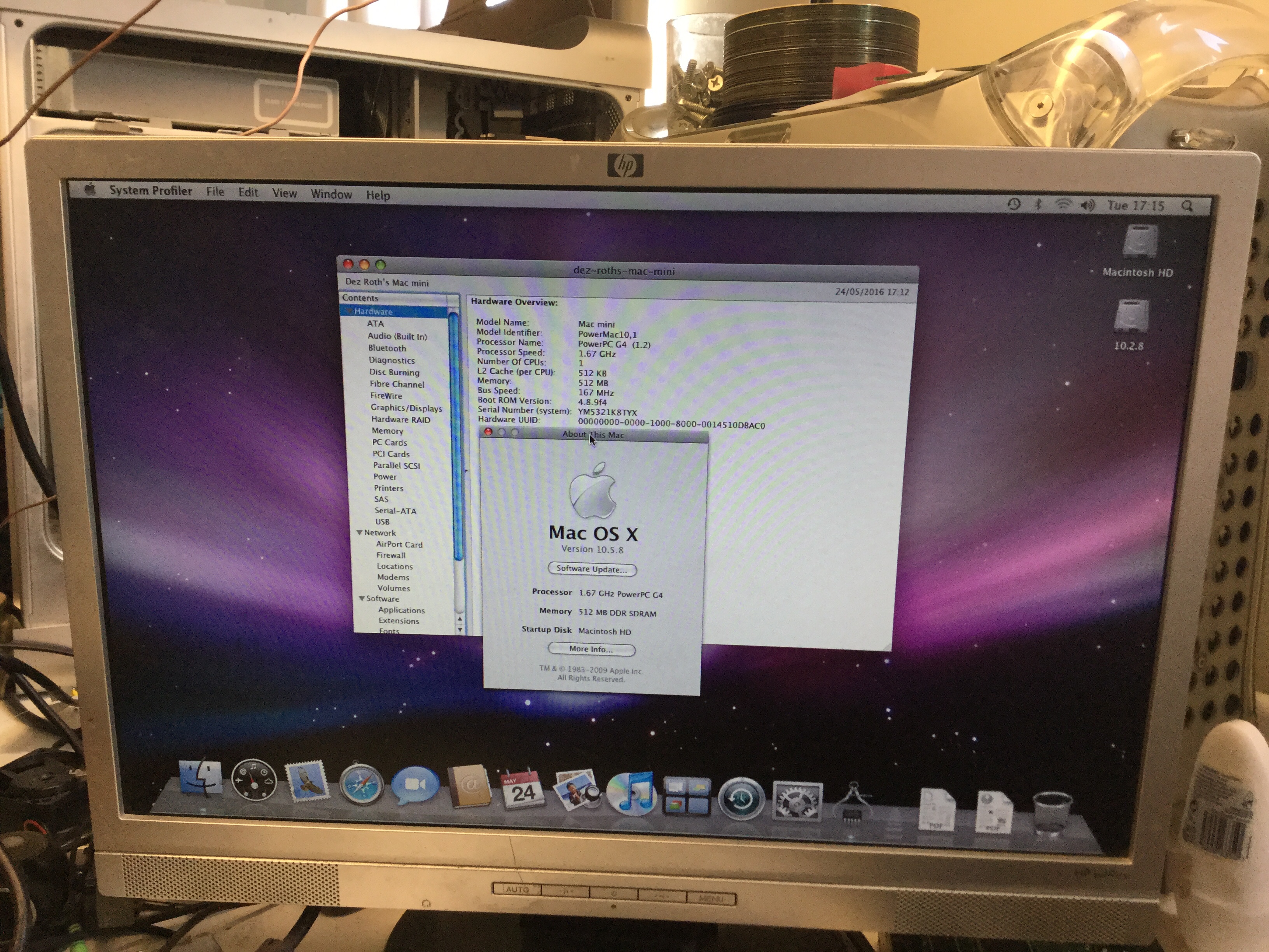

Just wanna say I had a crack at over clocking my Mac mini G4 using this way. got it stable at 1.67Ghz (1.75 boots but is unstable) overall I am quite chuffed it works (ideally conductive ink would work best if you cant solder the pads but i dont have any of that) I really need to get a 1GB RAM stick for it 🙂

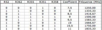

[doublepost=1464692056][/doublepost]Here are the higher speed settings.. This graph is a bit backward, 0 means resistor and 1 means no bridge.. also, note, the order of the columns doesn't match the order of the resistors.
Also, incase you haven't read it else where, R52 is next to the processor, under the heat sink.. it DOES have to come off to remove R52.. but if you're clocking up that high, you should at least renew the transfer paste anyway..

I have several mini's that have run fine for years at 1.75GHz. A few of them would run for a while at 1.82, but they'd have issues eventually. I never messed with the voltage, just the pll jumpers.
Sorry for bumping this back from the dead, but I'm onto this, and it seemed to make more sense to bring back this thread than to make a new one.
I have a bunch of stock 1.5 GHz Mac mini G4s, and I'm willing to try to get one of them to reach 1.82 GHz, the maximum clock found in Reflex88's table, the thread starter. But I also want to make it stable. Viable, perhaps. There may be a fault in the following reasoning, but I figure the most likely reason 1.82 GHz is less stable is because of heat.
