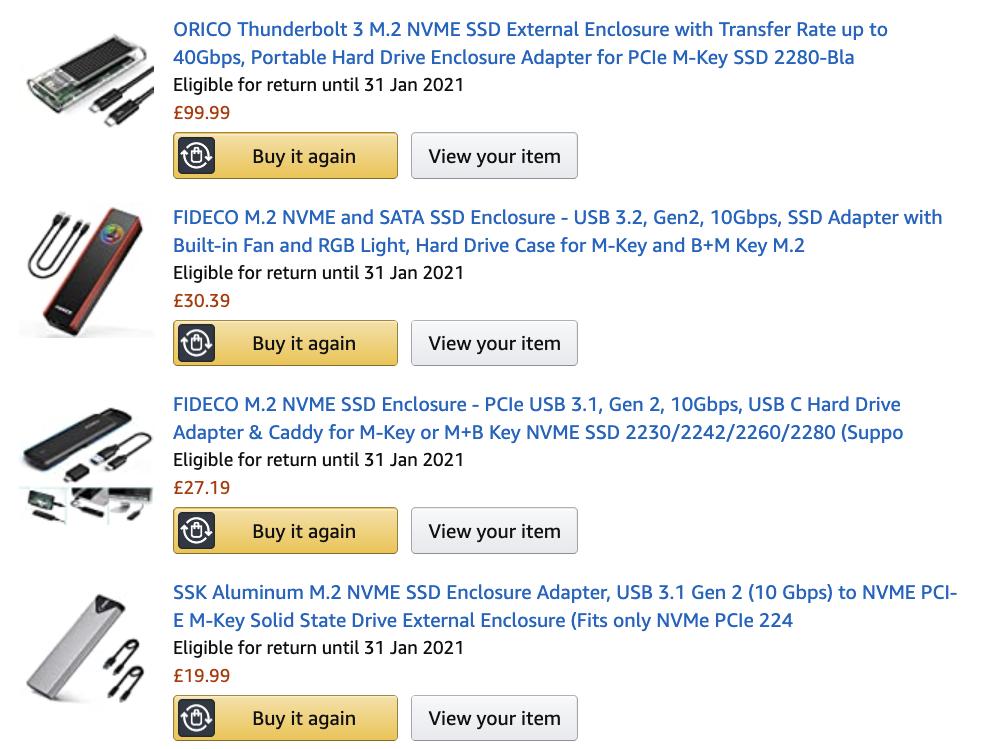

I bought the Orico TB3 40 Gbit/s which is giving me max speed I tested so happy with that...and at half price.
I did a rough test with a bunch of enclosures...
  • Love
Reactions: norwaypianoman
