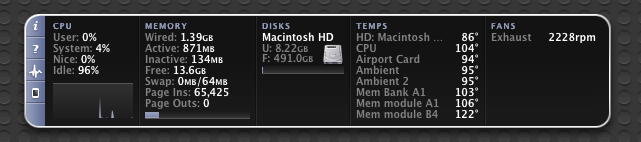

Upped the fan speed to 2229 rpm only, room ambient temp around 77 degrees and my temps are...
What are is your room ambient temps ? Higher they are, the higher the computer temps.

I am about 51c(124F) on the CPU at 1800 rpm with amb temp of 80F. This is about as low as I ever see it. Gets in about 85C under some load. Watching Netflix. Do not remember fan speed, but you can easily hear it.
The ambient room temp at the time my average processor temp got to 205F was about 65F. I currently have the fan set at a min. of 2500rpm and have not seen temps go above 160F since. While surfing the net and doing minor things its around 113F. However once I see its at 160F I kick it up to 3500rpm and cool her down, so dont really know if it would have gone higher or not. I am really liking the SMCFanControl software.
