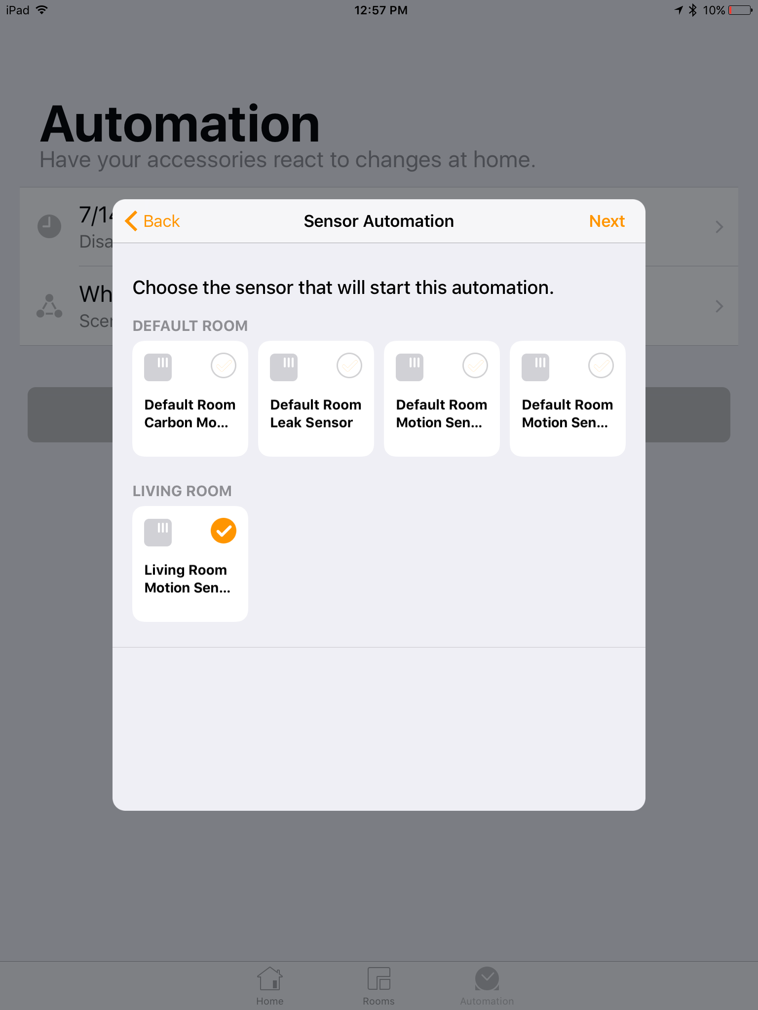

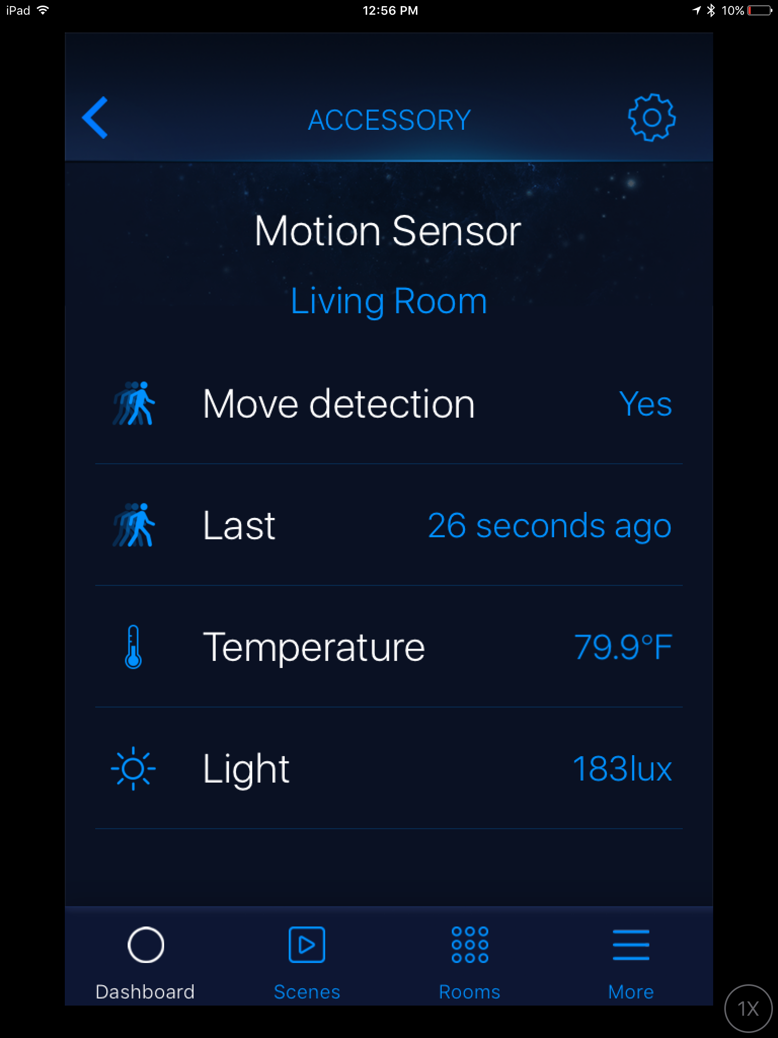

You know what, I thought it's available but you may be right:
Only Motion Sensor (motion) can be used as a trigger in Automation.

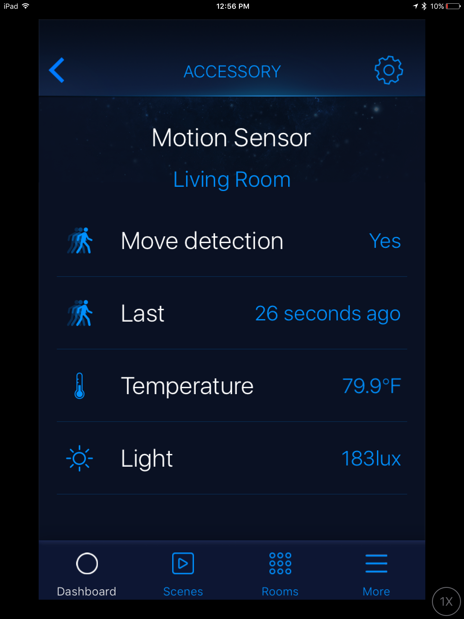

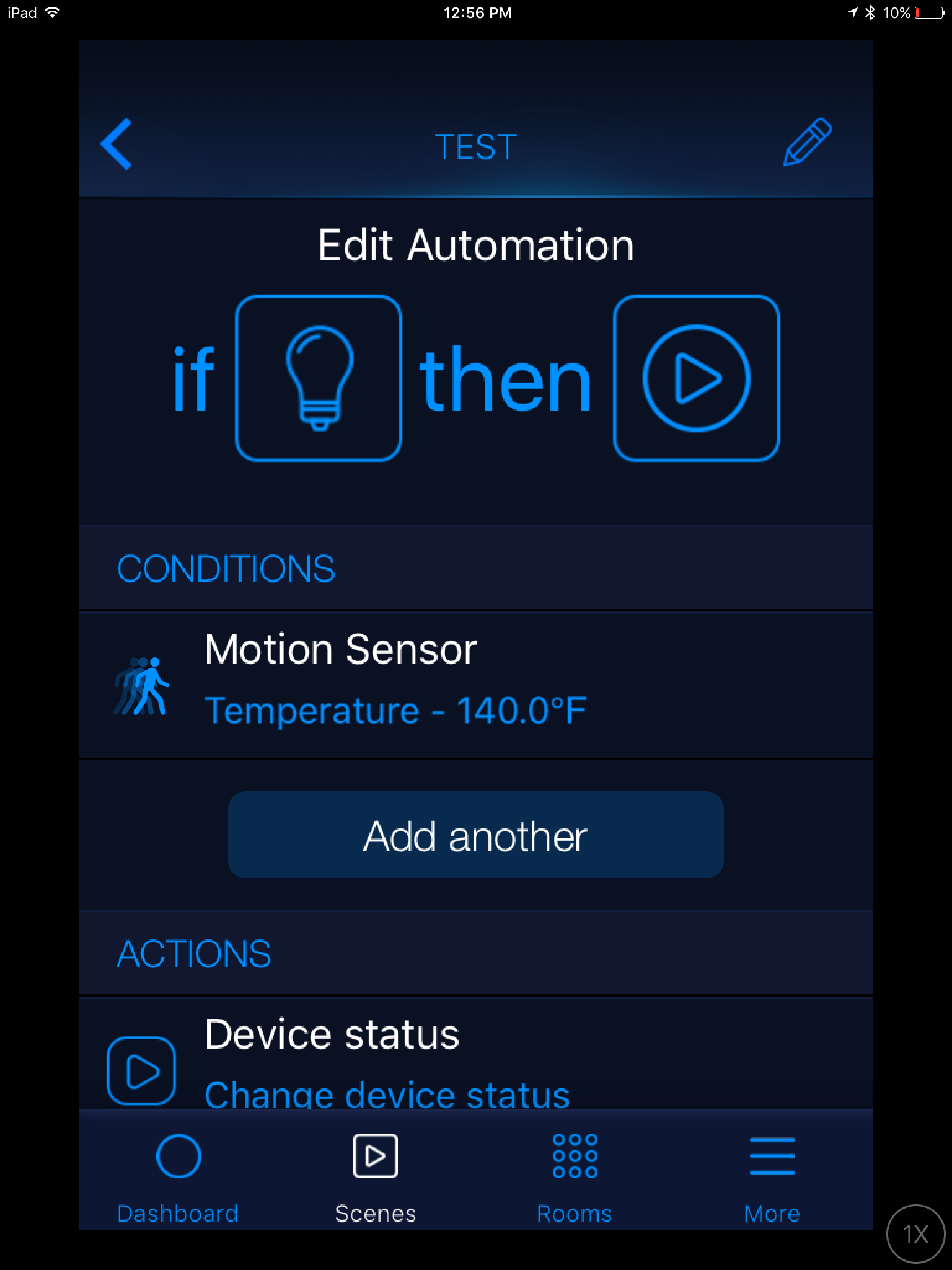

However, more automation options are available in their own app (sorry for stretched iPad screenshots):
Temperature can also be set as a trigger for some other actions.
