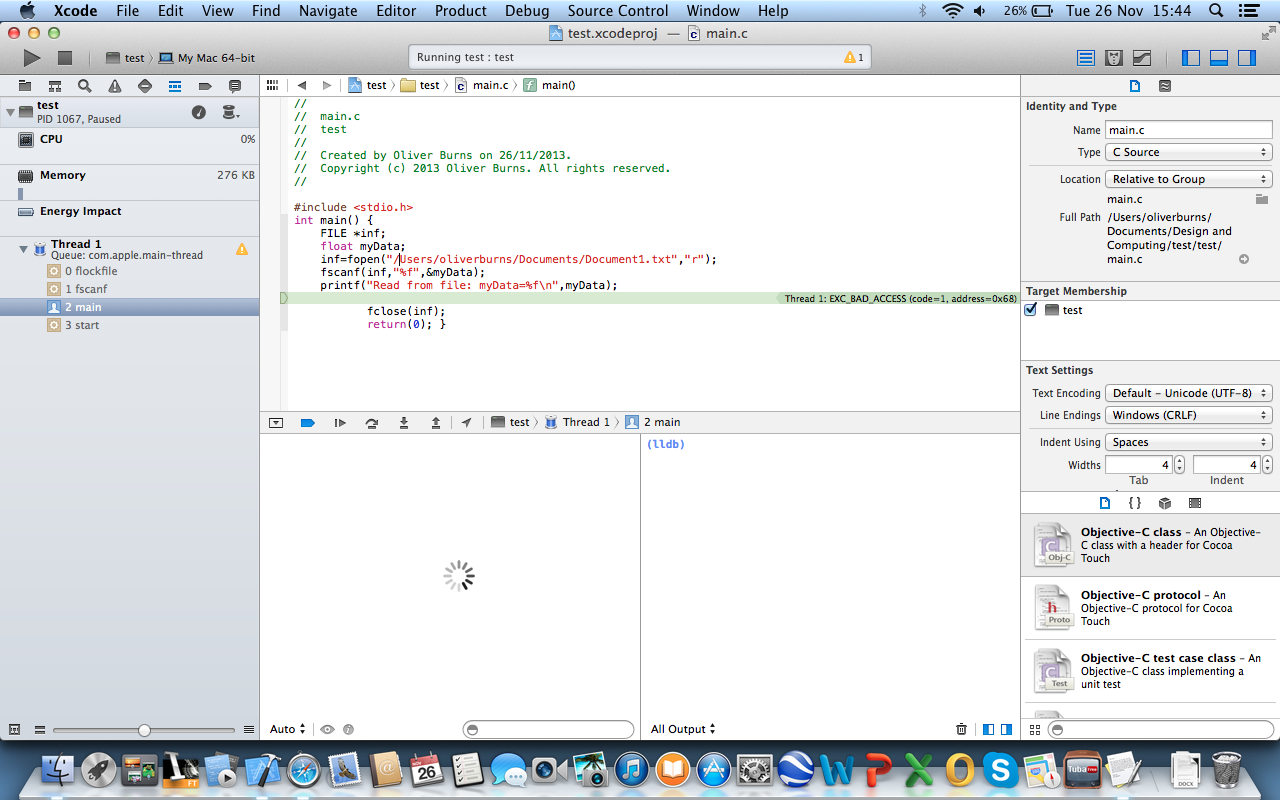

I'm an engineering student who needs to be able to program on my Mac. I can get the basic functions of C to work but the function 'fopen()' doesn't seem to work. File access is very fundamental to what I need to do. This is the output I get for the above code when I run it;
(lldb)
Can anyone tell me where I am going wrong? The file exists and there is text in it.

See screenshot attached, this is what I get. I haven't converted it from Windows so that shouldn't be the problem.
Thanks.

You need to check whether inf == NULL. That's what's going to happen if the file couldn't be opened, and then fread will crash.
And you just _might_ have got a warning from the compiler telling you that passing myData to fread isn't a good idea. Can you figure out yourself why that is?

The only way you are going to get that error is if 'inf' is NULL, which it will be if the file doesn't exist at the given path or failed to open for some other reason.
You need to check if 'inf' is NULL before attempting to use it, you can use perror which will print the reason for it not opening, then abort like this for example.

In addition to a check for fopen() returning NULL, you must also check that fscanf() returns 1 here.
If a float value isn't converted by fscanf(), then the myData variable is uninitialized, and attempts to print it can fail. The returned value from fscanf() tells you how many items were actually converted, or EOF if the input has been exhausted.
