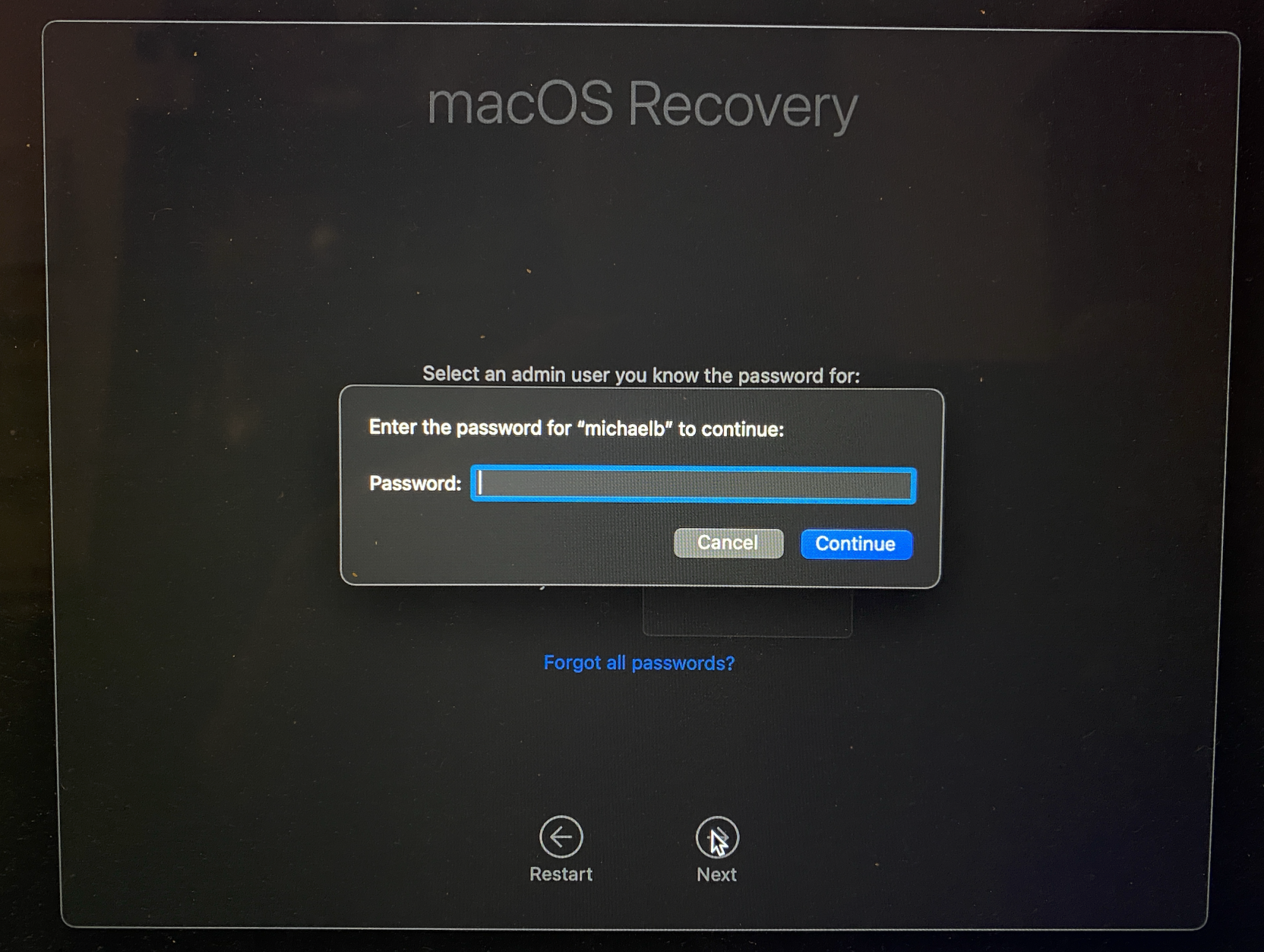

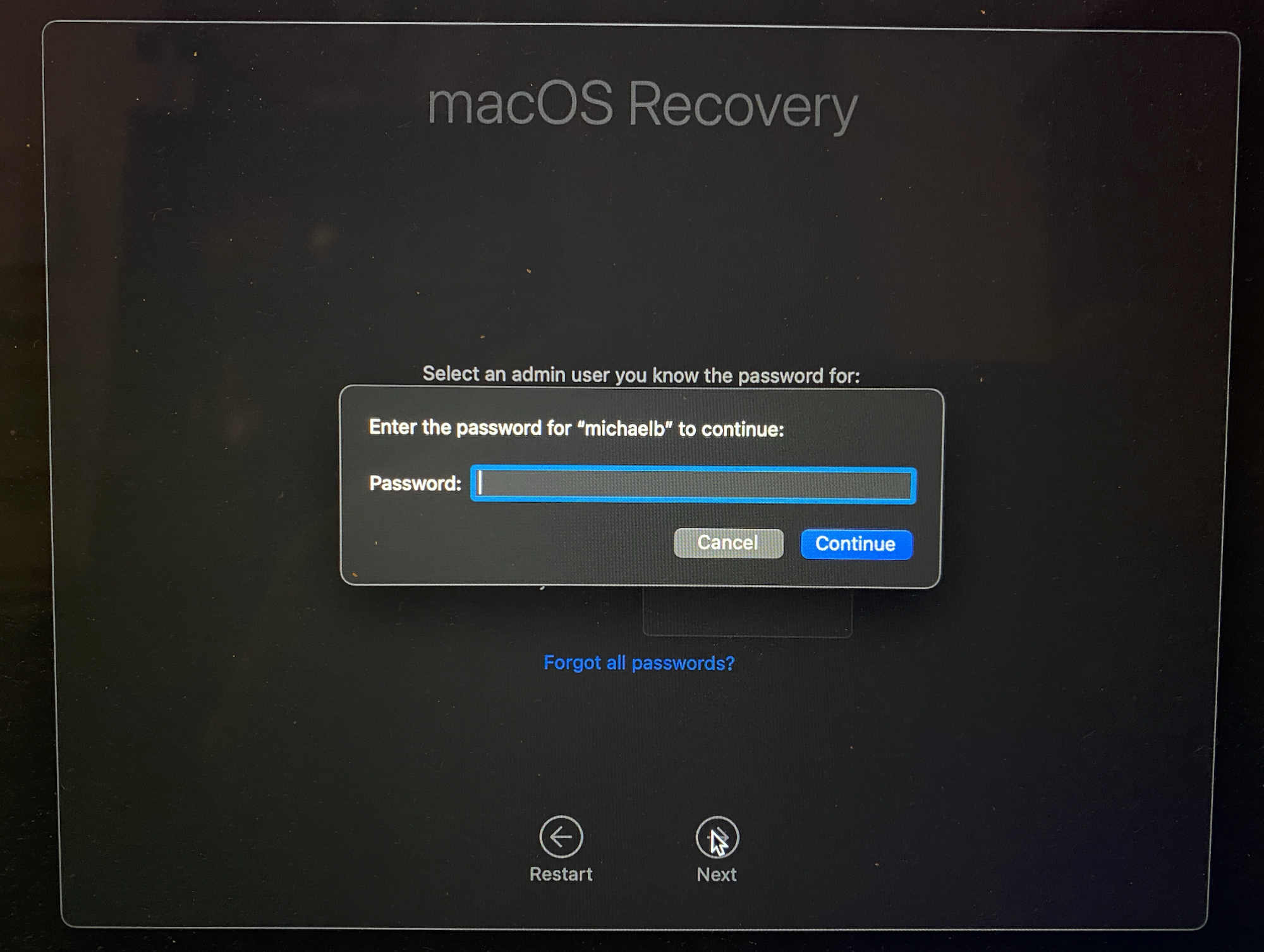

I don't believe this is correct. If it was correct it would be an unbelievably crass blunder by Apple, which would have hit the headlines long ago.
My M1 MacBook Air does NOT have Filevault enabled.
When I boot up to Recovery I get to this screen before I can do anything at all, including Disk Utility or Terminal:
Does anyone else in this thread actually have an M1 Mac? Is yours different?

I turned off FV on my M1 and booted into Recovery, and my M1 shows the same screen.
Damn, I dont have this... how is this possible...
I will try to record a video and upload it
No video - I tried it again and can confirm.
FileVault OFF - no Recovery password required...
FileVault ON - Recovery password required...
M1 MBP, BigSur 11.1
You should unless there is something very wrong with your machine setup.
I confirm my machine is M1 MBP, BS 11.1, with FileVault OFF - I boot into Recovery without password
Only in case of FileVault ON I get to the screen like yours.. identical
Can anyone else try and confirm?

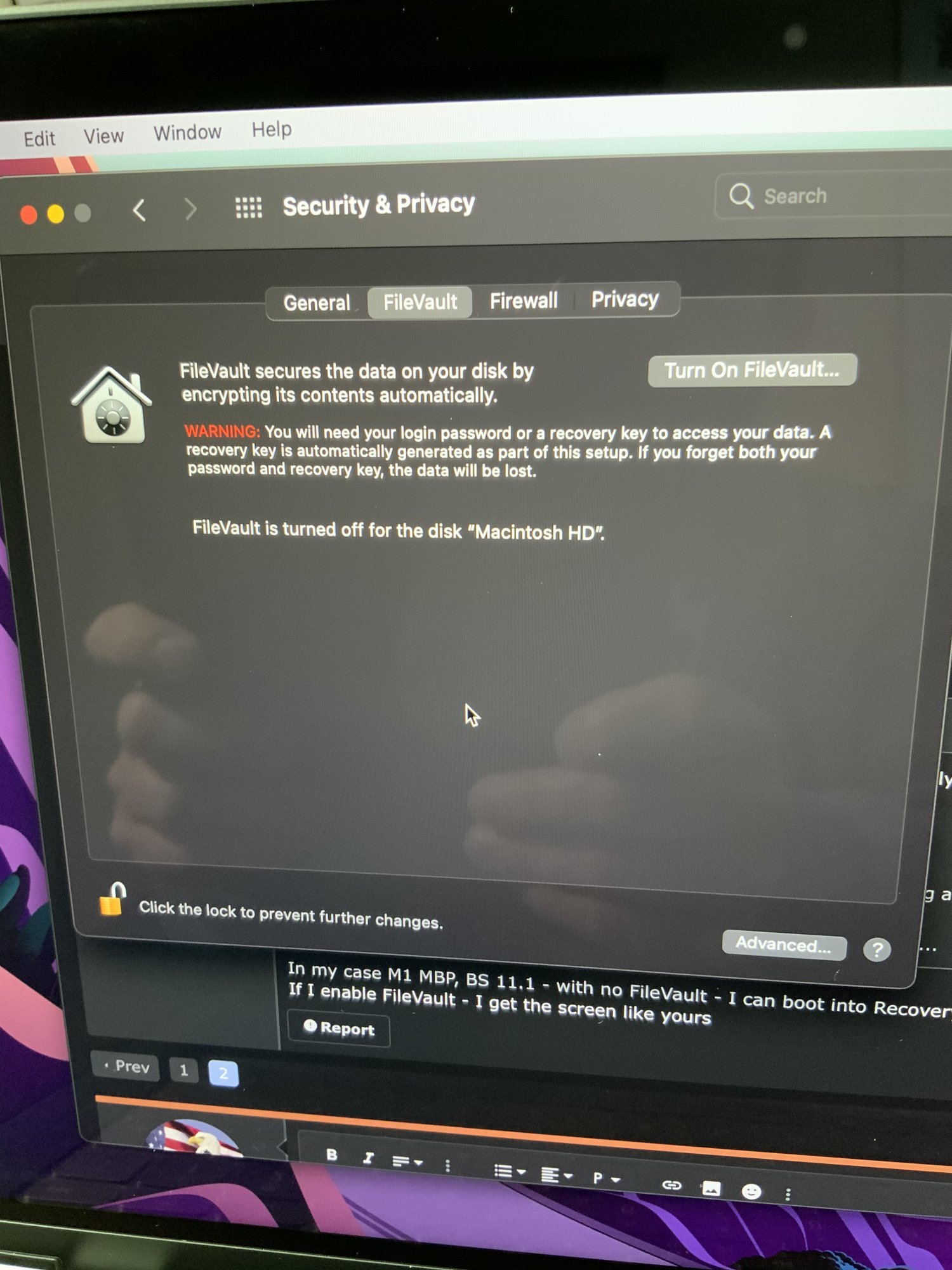

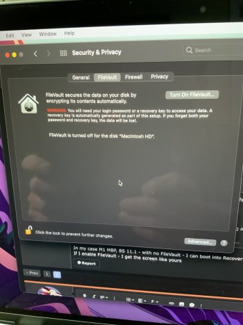

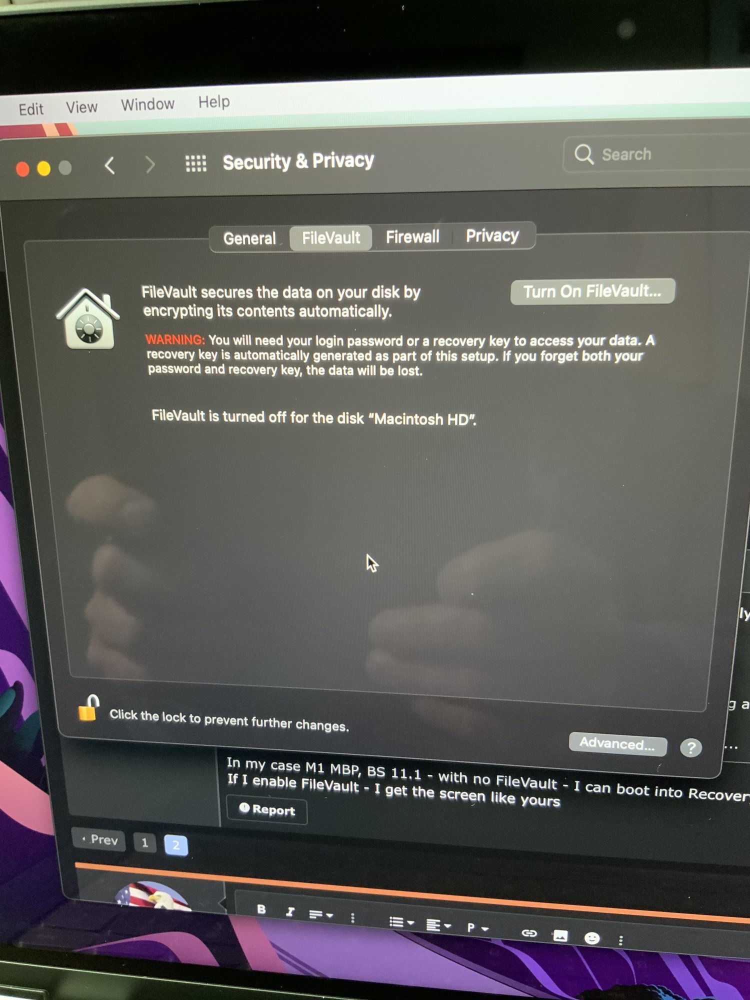

In my case M1 MBP, BS 11.1 - with no FileVault - I can boot into Recovery without password.
If I enable FileVault - I get the screen like yours

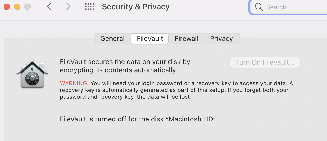

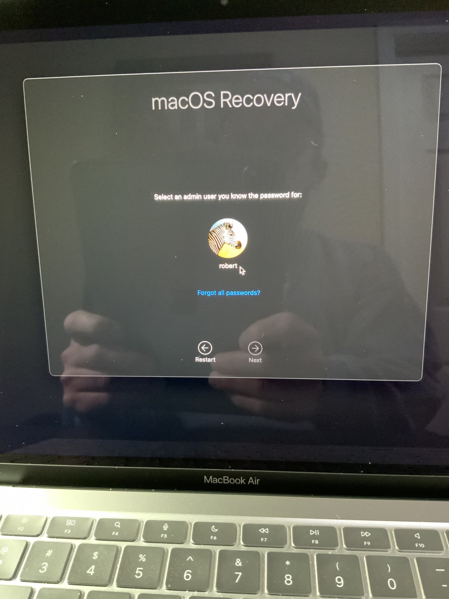

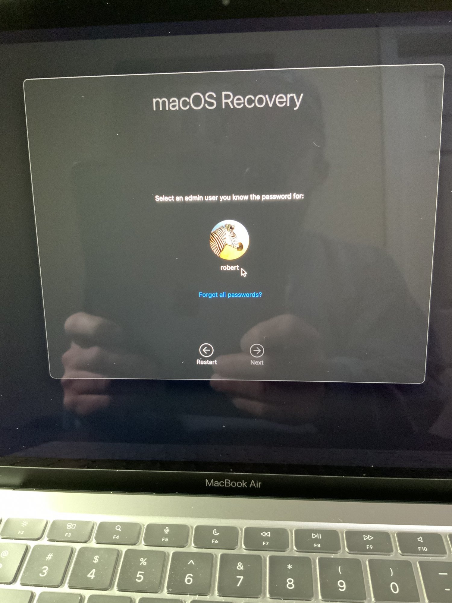

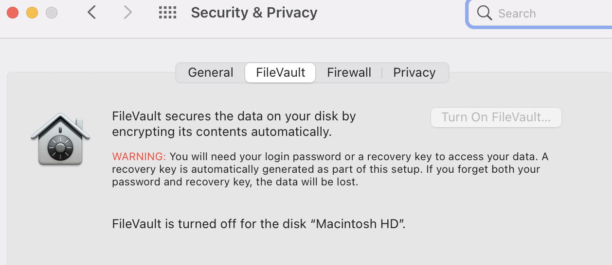

Even with FV off, it still says a password is required to access data. Granted, that is primarily referring to the regular boot process but, it also applies to entering Recovery mode, as far as I am aware. Does your screen show the same? After holding down the power button until you get the loading options cog wheel and clicking continue, you should see picture 2 in Recovery Console. Those two pictures were taken just now.
Same explanation here:
But still - when I reboot into Recovery with FV off - it asks no password from me.
Video is on the way I am uploading soon...
BTW, my setup is regular. Clean install of 11.1, with restoring some apps from TimeMachine, nothing else touched.
