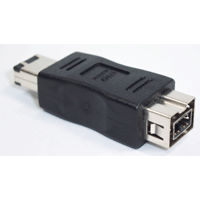

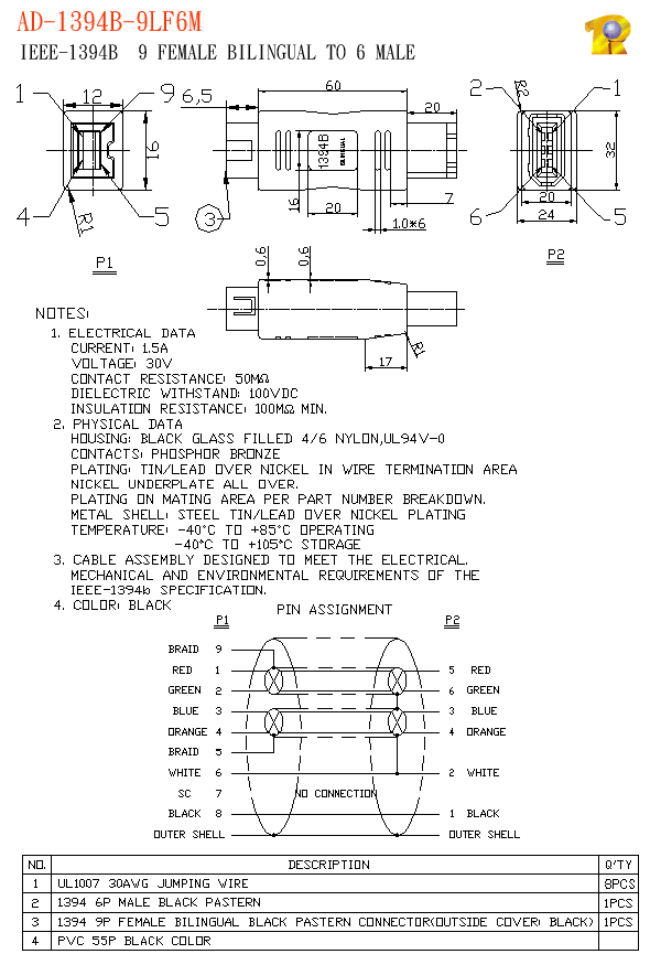

I know about the cables which have Firewire 400 and 800 connectors on each end, but as a photographer student I want to carry as little as possible around (lenses and stuff makes it heavy enough), and a single Firewire 800 cable + an adapter would be a better solution than two cables.
I did actually find an adapter suitable for my needs: a 6-pin male (400) to 9 pin female (800) adapter costing $ 6.44.
As I live outside of the USA however I suspect that shipping will be very expensive. They use UPS, and won't even tell you shipping costs before you actually order the item. Popping the item into a small padded envelope, then sending it with USPS would only cost 2-3 Dollars in my experience. They won't even reply to my email when I've asked about the total cost.
So my question is: has anyone seen the same type of adapter for sale other places?
Well, a quick Google search led to one right off the bat from a company in Apple's Macintosh Product Guide called Synchrotech. If you look at the bottom of the following page at the black one it meets your specs and they call it a "CAB-FW8-9-6-CONV FireWire 800 IEEE1394b 9pin (female) to 6pin (male) Converter Plug". It can been seen and ordered at FW 400 M to FW800 F Adapter for $11.00 and though we don't know where you are, they show worldwide shipping.
I know I sure would not be dealing with a place like you mentioned that won't even give you costs when there are other places like this. BTW- if you want to check out more search results, just Google "male firewire 400 to female firewire 800 adapter". Another listing for a shorty adapter cable (19") that meets your specs is 19" Adapter cable but it is $18.50.
I'm in Norway, and yes -that's exactly what I'm looking for.
But again there's the issue of shipping costs. In this case they let me calculate the costs before ordering, but I almost fell off my chair when they ask $44 for sending it to me (FedEx is their only option).
$ 55 for an adapter which probably costs no more than $ 0.50 to produce in China, and would cost a couple of bucks to have sent to me is unreasonable to say the least.
That short cable you mentioned is a good idea, though I would prefer the much more compact adapter. I'll give Google another shot, hoping to find some company which doesn't overcharge shipping and unnecessarily uses only expensive courier services to deliver. It's a pity nobody at eBay sells them.
