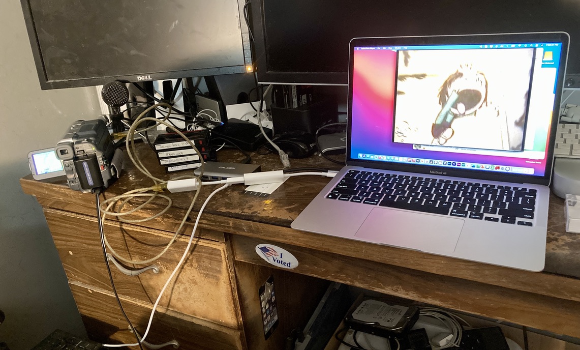

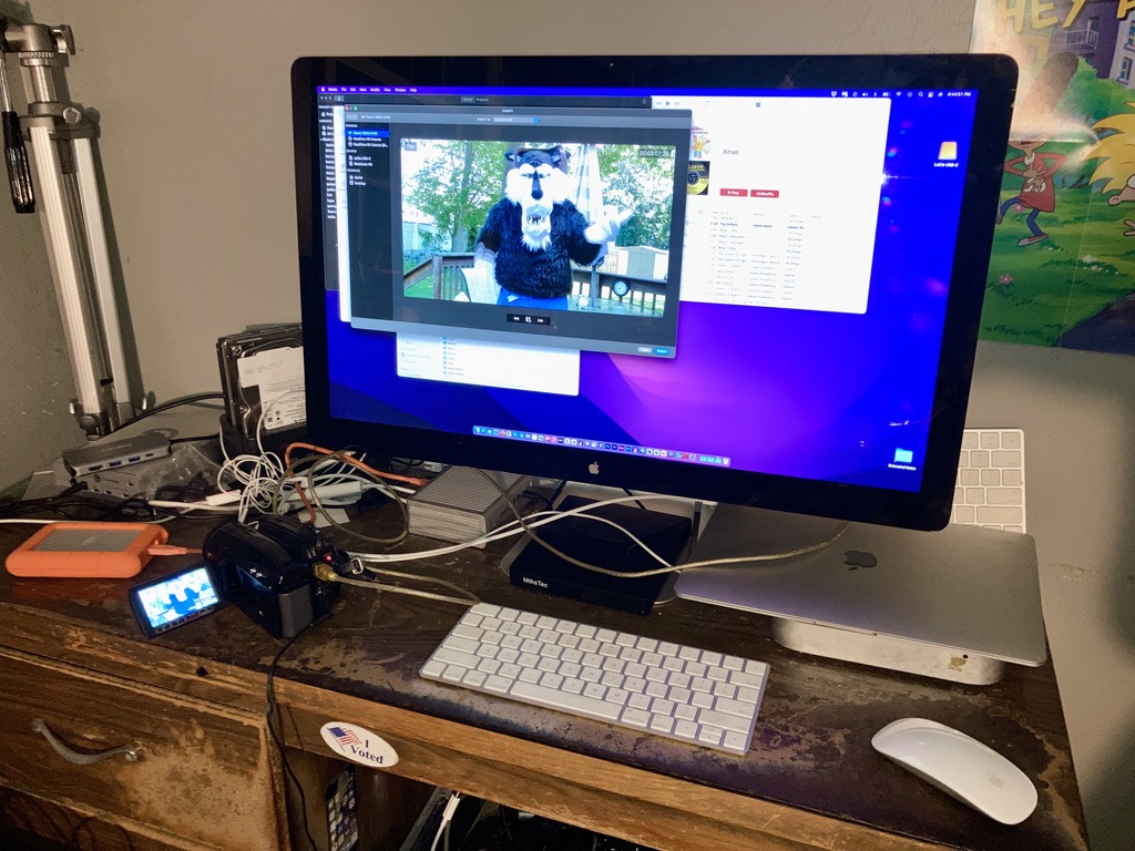

With the latest Monterey 12.4 update, my video camera is now being recognized by my iMac! Time to transfer the rest of my movies before another bug arises.
