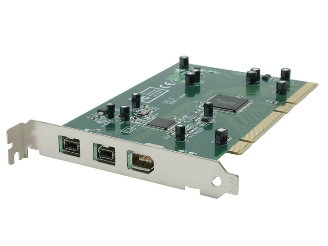

Go buy a 3 port FW3200 PCI card when they come out to put in your existing desktops and/or wait until a newer machine comes with 1 FW3200 slot built-in.
Here is a FW800 3 port:
Cost: $42.99
http://www.newegg.com/Product/Product.aspx?Item=N82E16815158016
