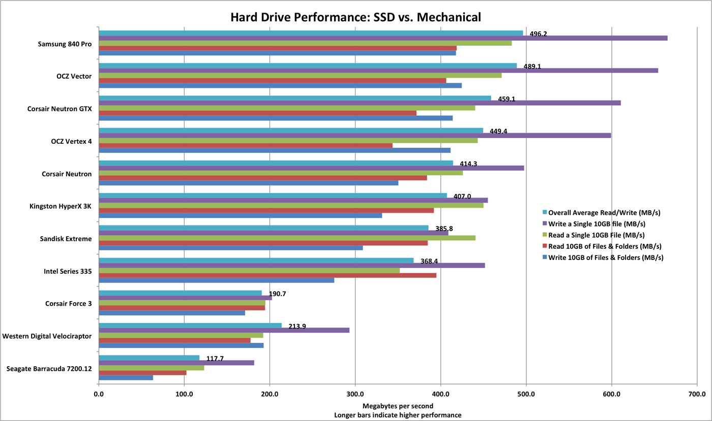

The Extreme is a good performer, but the 840 Pro is still among the very fastest of SSDs available right now, typically fighting it out with OCZ Vector for the top spot
http://www.pcworld.com/article/2020...ssds-plus-reviews-of-7-new-drives.html?page=2
