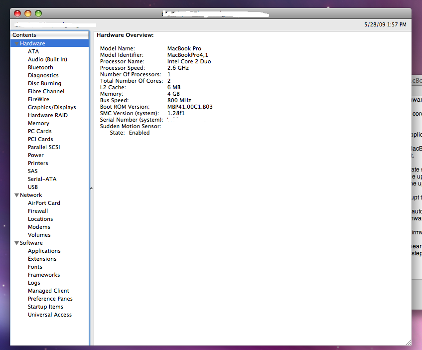

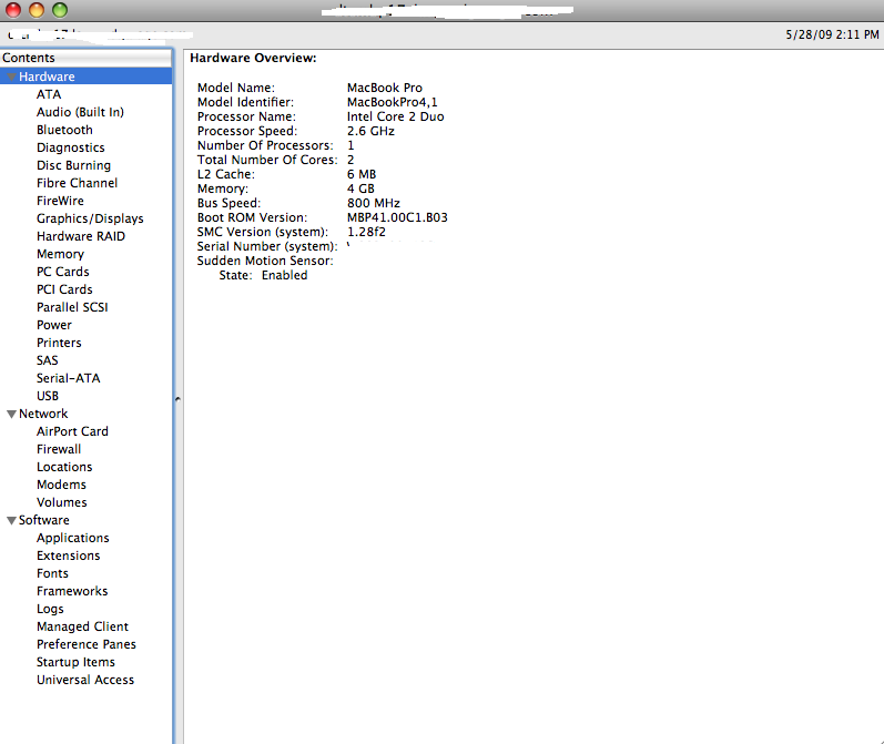

I just updated my MBP 17 (Penryn 2.6GHZ, HD Screen)
The firmware update too 5 seconds.
There was no progress bar along the bottom of the screen like previous updates.
See my attached screen shots for the changes under "SMC Version"
it went from "1.28f1" to "1.28f2" post update.
