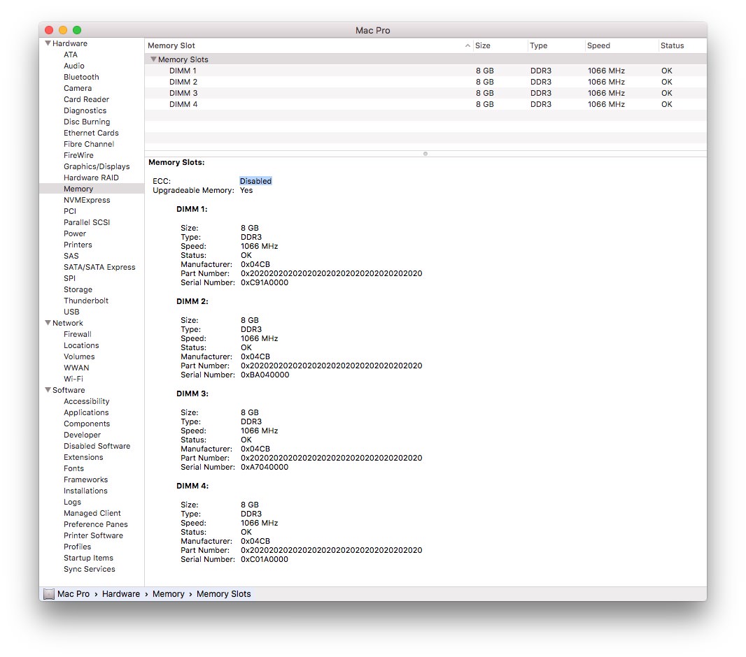

ECC is not a must on cMP. In fact, the system won't say anything but work as usual, apart from ECC disabled.
Normal PC DDR 3 RAM works, which is a cheaper option. Anyway, I won't recommend anyone do this. I did it just because I am too lazy to get the correct RAM. And I have no mission critical stuff on this computer.

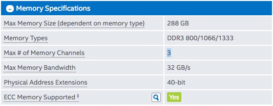

However, you better know that the X5660 only has 3 memory channels.
No matter how good the cMP is, it can't change the CPU's spec. In fact, as the others points out. It's been discussed many times already, the 3rd and 4th slots share the same channel.

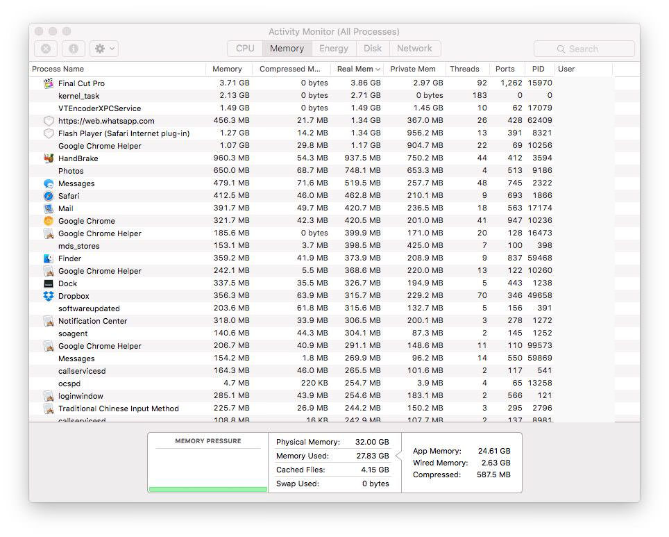

If you use all 4 slots, by running benchmark, the memory performance can easily drop 30% or more (much much bigger hit than 1333 CL 9 drop to 1066 CL 7). However, in real world, for most of the applications, you can't feel it.
If you want to maximize the memory speed, you should not go for 4x4G, but may be pay a bit more to go for 3x8G. Or if you believe that 12G is good enough for you, 3x4G is also an option. I mainly use my machine for video editing, photoshop, media server, web surfing etc, with 2 profiles constantly logged in. The memory used usually at or above 24G.
If you want best performance, 24G should be a better option for you. Technically, your RAM will run much slower at 4x4G config, and your Mac can easily running out of RAM if only 12G available (that means, big performance hit).
