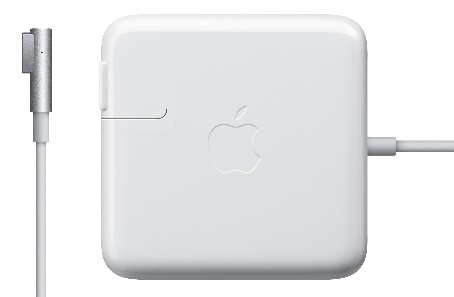

Apple today released a pair of firmware updates for 2007 and 2008 models of the MacBook and MacBook Pro, addressing an issue with the machines not charging properly when used with the new "L-shaped" MagSafe power adapters.
This firmware update addresses an issue with certain MacBook and MacBook Pro models from 2007-2008 that prevents them from charging with new power adapters.
According to a support document on the issue, the following models are affected:

Lately with my Aug 08 MBP, I have to really make sure the amber light is on when it's plugged in. It's almost like it's not being seated correctly, although usually just a wiggle turns the light on. When the light's off, it isn't charging.

Same thing with me. What it most likely is would be something stuck in there... since its magnetic it attracts all kinds of things. Also very hard to clean out..

Actually this sounds like the beginning of the end of your adapter. The straight on adapters do not last long, they begin to fray inside the plastic casing and eventually they short and melt the plastic casing usually at the end that plugs into the laptop, but I also had one fray at the power brick end. Do not leave it plugged in to your laptop when you are not home or are sleeping, it can start a fire. I have not had any of the straight on adapters last more than 18 months before this started to happen, and I have "babied" the adapter to try to prevent this. If you look around online you will see this is a common problem with these adapters.

That's not necessarily a symptom of castastophic failure. I have a brand new magsafe power adapter that does the exact same thing. it's typically due to some dirt in the connector on the computer or the pins on the connector on the computer aren't returning fully (they're spring loaded).

A PRAM reset actually resolves this issue, I guess Apple retailers did not get that memo. A benefit of being an independent Apple service provider.

This fixes a different problem. In fact, I replaced my T-style magsafe adapter after it exhibited the symptoms you mentioned. Are you sure when the LED is out that it's still not actually charging by looking at the indicator at the top of the screen? When I replaced the adapter, then I had this NEW issue.
Anyway, the problem is that the SMC wouldn't recognize the adapter and the only way to fix it was to remove the battery or reset the SMC.
