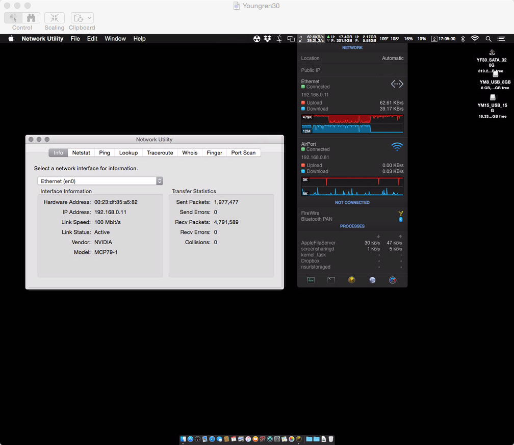

Right now I have a 100' CAT 5 cable coming down from the switch connected directly to the Mini. As I clean the garage up that'll be changed as I route wires into permanent positions. For right now it works.
As you can see, 10/100 right now.

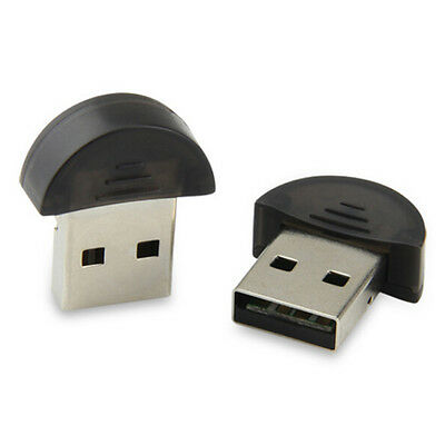

I have a Belkin FT8012 in my Quad. Originally, I bought it for my QS in order to get BT on the Quicksilver. My Quad does have the Airport/BT combo but it's been jumpy since I got it and it does not connect to more than one device. So, I use the Belkin from the QS in it.
The thing about the Belkin adapters is that no drivers are needed. The system sees it as native BT.
I have a FT8001 on the way for the Mini, if the eBay seller will get around to actually shipping it. $10.

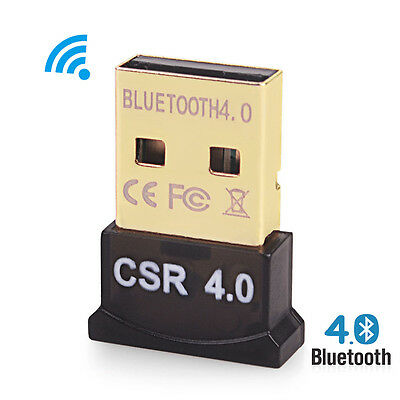

I have 3 of these, and they work great on Mac and Windows. It won't work in Snow Leopard, but it works perfectly in El Capitan, High Sierra, Mojave and Catalina. I imagine it will work in Yosemite also. It's only a $2 gamble. It will give you much more modern and capable Bluetooth. 4.0 and up is also pretty secure.

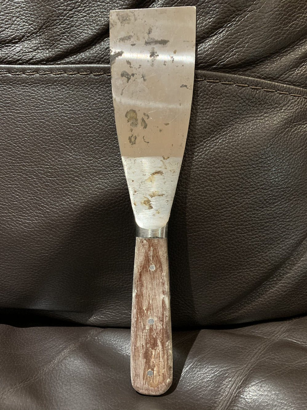

The official Apple opening tool was a thin but flexible metal paint scraper. So I bought myself one of those from the local DIY store about 2 weeks after buying my 2009 mini new so I could install the RAM upgrade. Best £7 I ever spent, and it has a lovely teak handle on it too!

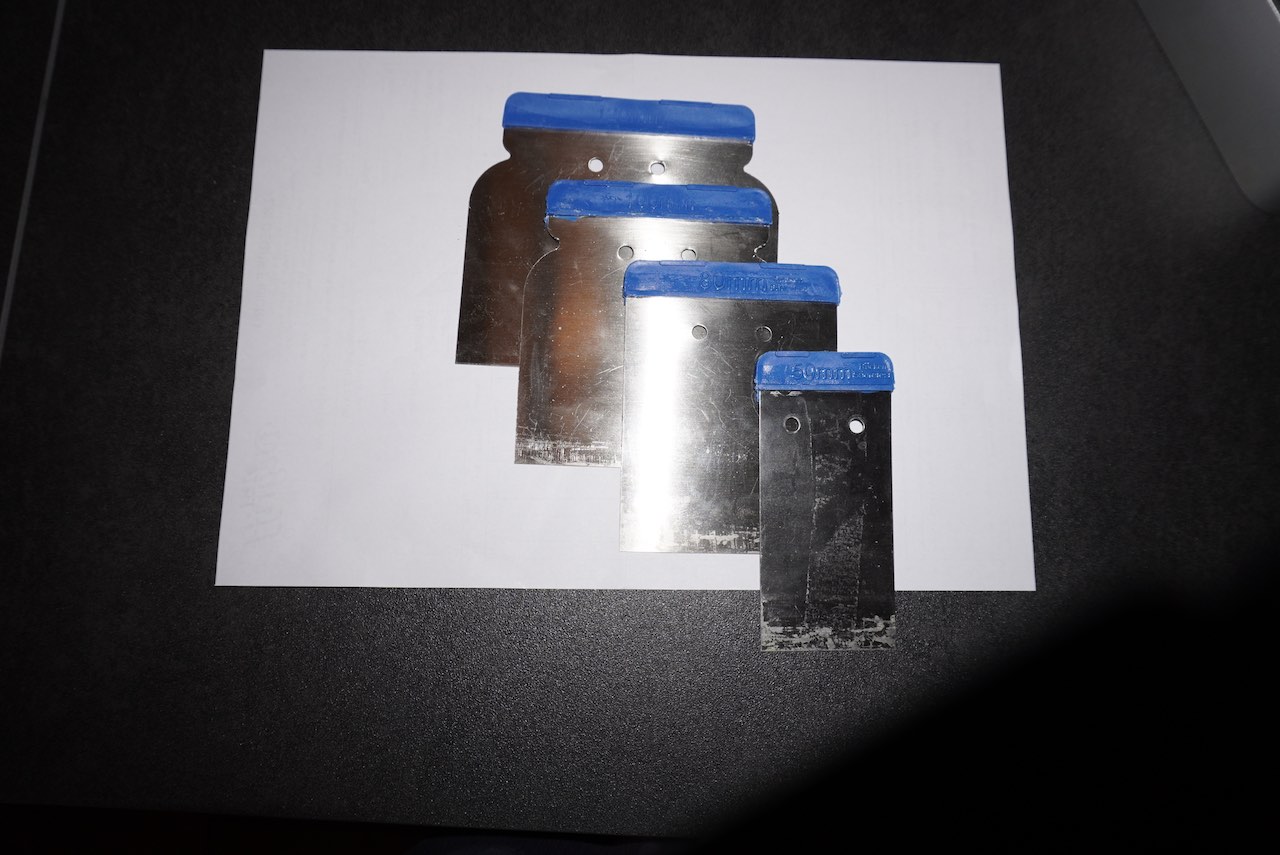

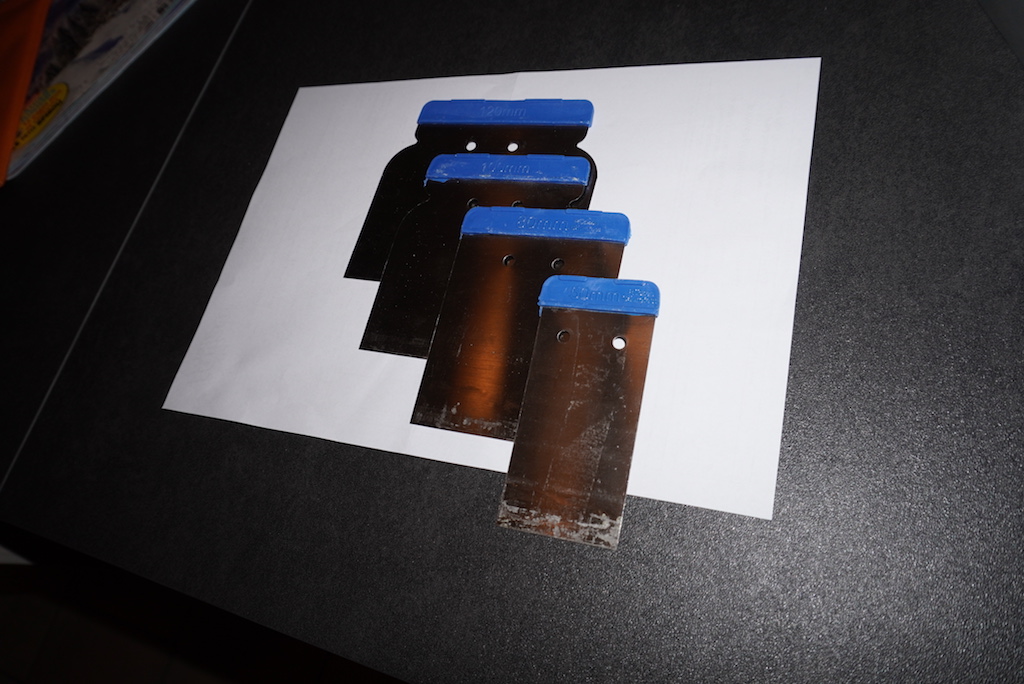

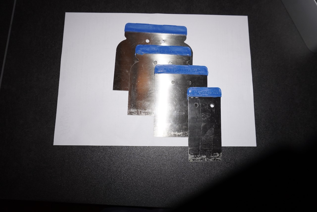

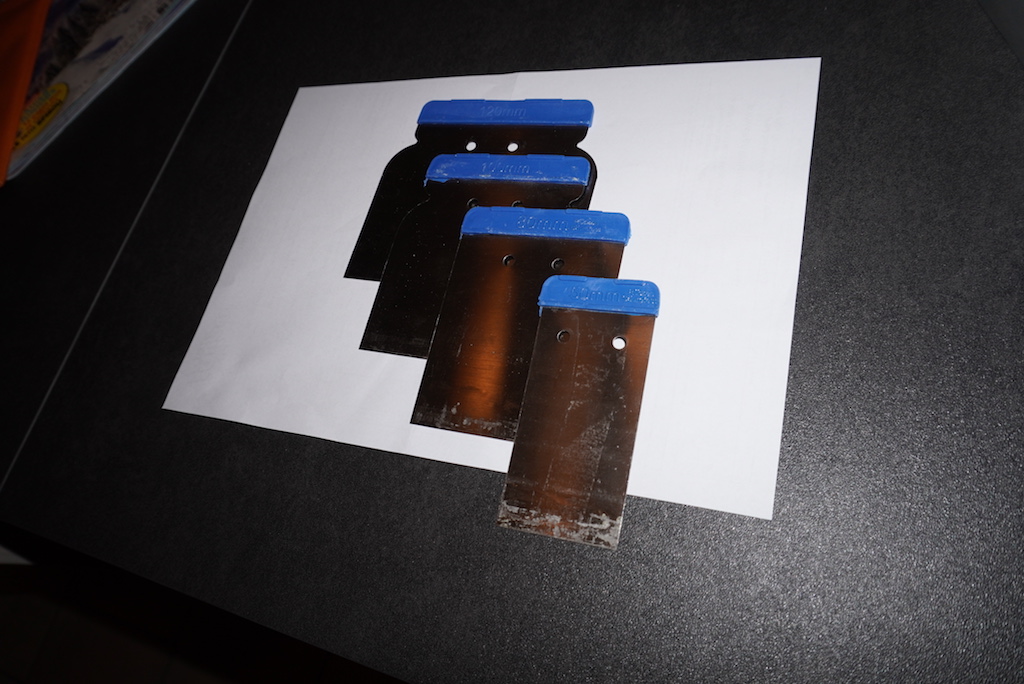

Below is what I found in a French 'Dollar-Saver' type store. They are thinner steel so better than most paint-stripper tools I've ever seen. They slide perfectly between the gaps in the Mac Mini casing. Not sure what their principal use was, possibly for spreading adhesive on tiling etc. They came in a pack of 4, with width of 120mm/100mm/80mm and 50mm as shown below:
Cost was 3,50euros (a little less than $US4). The 120mm is the perfect width to depress all of the clips inwards on one side, then the 100mm on the adjacent side which then should fully release the first side & strip. Or the 100mm and 50mm used in combination on one side works a treat too.

If you look around I'm sure you can find cheaper and better than the iFixit tool itself.
Those are what I used for mine. Got mine from a pound shop and they are filler spreaders I bought recently when I was patching and decorating around the place. You can get plastic ones, which are like wide spudgers but I would not recommend them for this job. While flexible and fairly easy to insert, they are actually a tad too thin and flexible to hold the clips back while you try to ease the base out. It was actually more effort than using a wallpaper stripper and I did feel as if the blades were going to snap at any time. However, with a bit of care they will do the job and are cheap although pound shops in the UK all have wallpaper strippers somewhere.

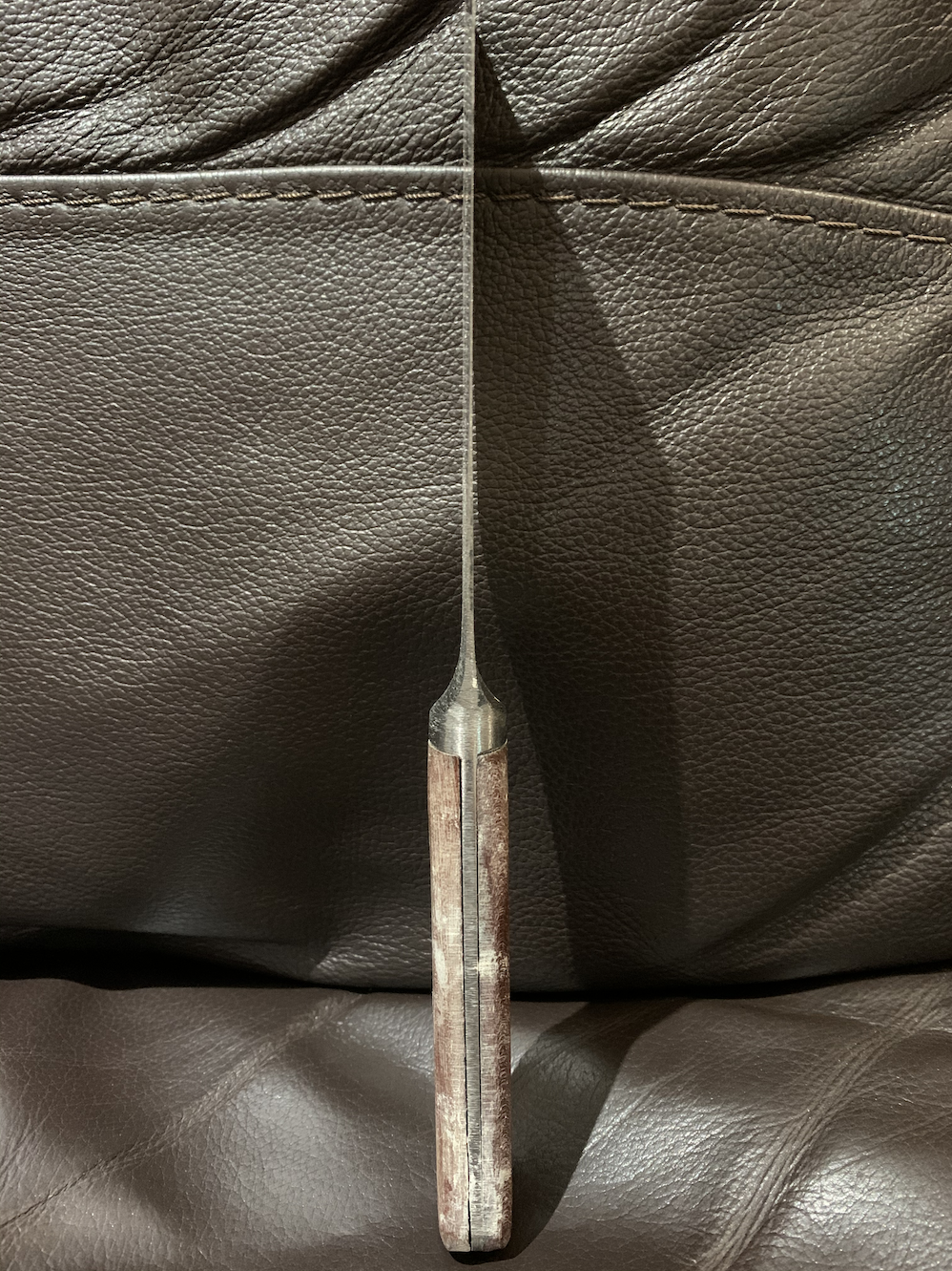

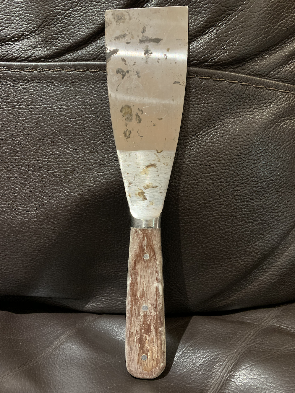

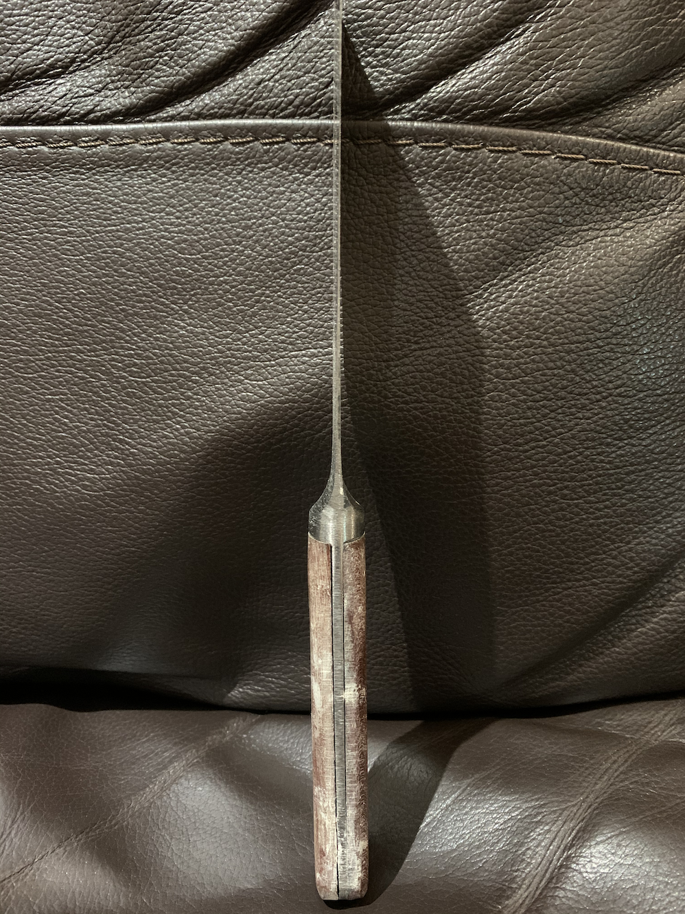

My B&Q (DIY store) acquired Mac mini opening tool, c. 2009. Thin, flexible and about 2.5" wide.
Since used in it's intended role as a paint scraper!

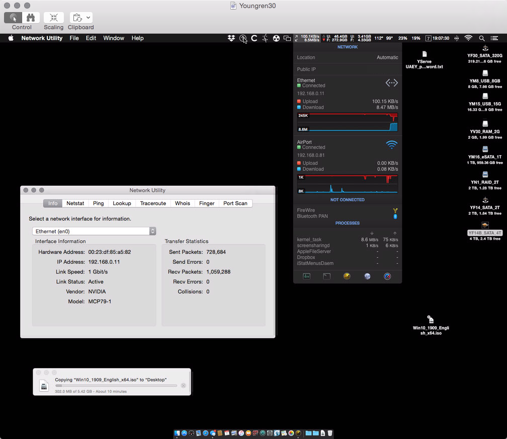

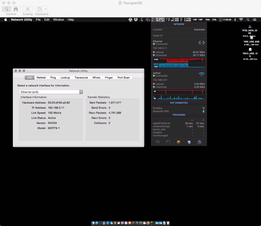

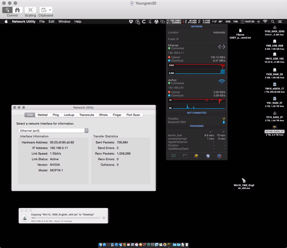

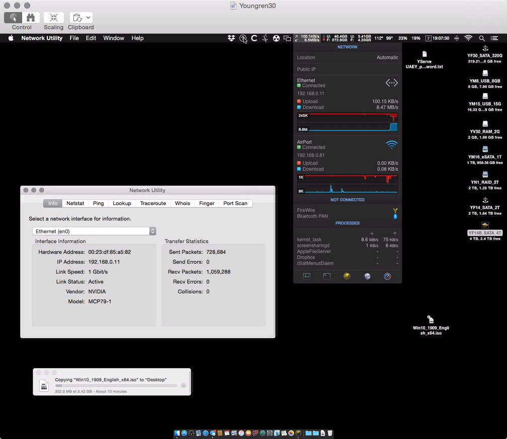

Today, the Gigabit switch arrived. I didn't get a pic, but physically it's the same Netgear box as the 10/100, just Gigabit.
As you can see…the Mini is now pulling Gigabit down the Powerline module.
Are you certain? I see that it's linked at 1Gbps but the download shows 8.47MB/sec which could be achieved with a 100Mbps connection. It's possible there is something else restricting the transfer speed but I do not see it transferring at anything exceeding 100Mbps. Or am I missing something?
