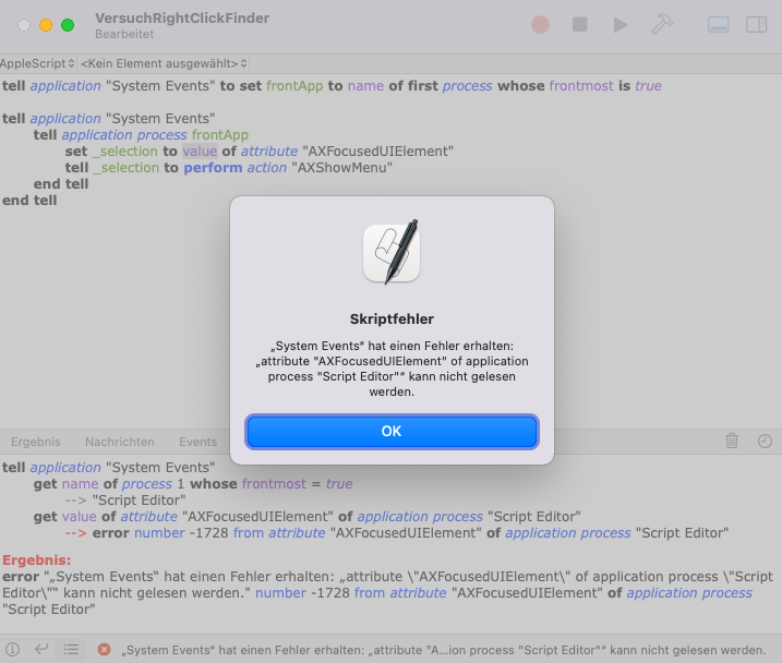

I would like to create a hotkey for "context menu" alias the "right click on mouse".
Somebody wrote a script for that:
https://forum.keyboardmaestro.com/t/click-mouse/15450
I have no experience with AppleScript. But I copied this into AppleScript. When I'm running it an error message pops up
1644688402184-png.357679
I'm sorry to show this in german. But it means: "System Events" has received an error. (...)"Script Editor" can not be read.
Is there anybody who can help me with that?

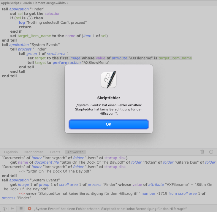

tell application "Finder" set sel to get the selection if (sel is {}) then log "Nothing selected! Can't proceed" return end if set target_item_name to the name of (item 1 of sel) end tell tell application "System Events" tell process "Finder" tell group 1 of scroll area 1 set target to the first image whose value of attribute "AXFilename" is target_item_name tell target to perform action "AXShowMenu" end tell end tell end tell
will bring up the context menu for the currently selected file on the desktop.
EDIT: action AXShowMenu shows the right-click menu
Thanx to @Slartibart
I get this
Sorry for including some german again. Error says
""System Events" received an error. Script Editor has no authorization for helpacces."
Do I have to change anything in system preferences?
