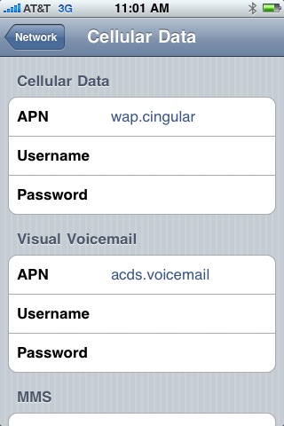

For those that have had their Visual Voicemail stop working after installing the IPPC that gives you tethering and MMS options here is the fix -
settings>general>netwrok>Cellular Data Network>Visual Voicemail>
Current with modded IPPC = wap.cingular - change this to acds.voicemail, then restart phone.
APN needs to be set to acds.voicemail

Mine still works and it's set to wap.cingular...
yep, this has been mixed for everyone - some works, some doesnt. Mine did not and found this setting and changed it and it started working again. Not sure if it depends on the market you are in or not, but for those that it stopped working for - try this and cross your fingers.

If it doesn't work, what happens? Will it tell you that theres a problem, or that you can't listen to any new voice mails? Because I haven't got any new voice mails since last night, but I can still listen to my old ones...
This is what I'm wondering as well.
Haha, yep. It doesn't work with wap.cingular. I changed it to the new one and restarted and it worked. Good find. I would've kept using it without it working and I wouldn't have known.
It doesnt not tell you or alert you that it does not work, it simply will not pull down new messages. You can dial your number and get your VM but it will not pull them down to the Visual Voicemail - does that help answer your questions?
Anyways - make these changes changes and reboot and you visual vm will work again 🙂

Sweet. It fixed mine, and I didn't even have to restart my phone.
