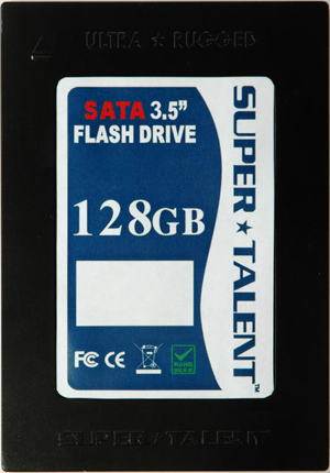

Interesting news article I just stumbled upon; there already is a solid state harddisk of 128Gb. Read/write speeds are a bit slow but it's quite some capacity and fast access times. Also a very long lifetime (over 100 years!). I wonder how much it costs...
Super Talent shows off new SATAs in capacities up to 128GB
It looks as though solid state drives (SSDs) are coming out in full force this year. We've already seen new offerings from Adtron, SanDisk, Ritek and Intel. Today, we hear that Super Talent is beefing up its line of SSDs with new SATA offerings.
Super Talent is offering its SSDs in 1.8", 2.5" and 3.5" form factors. The 1.8", 2.5" and 3.5" drives will be available in capacities of up to 32GB, 64GB and 128GB respectively.
"This new generation of SSD drives delivers all the benefits of Flash based storage -- rugged reliability, low power consumption and fast access speed," said Super Talent marketing director Joe James. "But we’ve engineered these drives to offer twice the data throughput at half the cost per gigabyte compared to the first SSD drives we introduced a year-ago."
According to Super Talent, the drives have an access time of less than 0.1ms, read/write speeds of 28MB/sec, MTBF of 1,000,000 hours and a write/erase endurance of 100,000 cycles.
Super Talent was contacted for pricing information, but none is available at the moment. We will keep you posted as more information rolls in.
source: http://www.dailytech.com/Super+Talent+Announces+New+SATA+SSDs/article6475.htm
