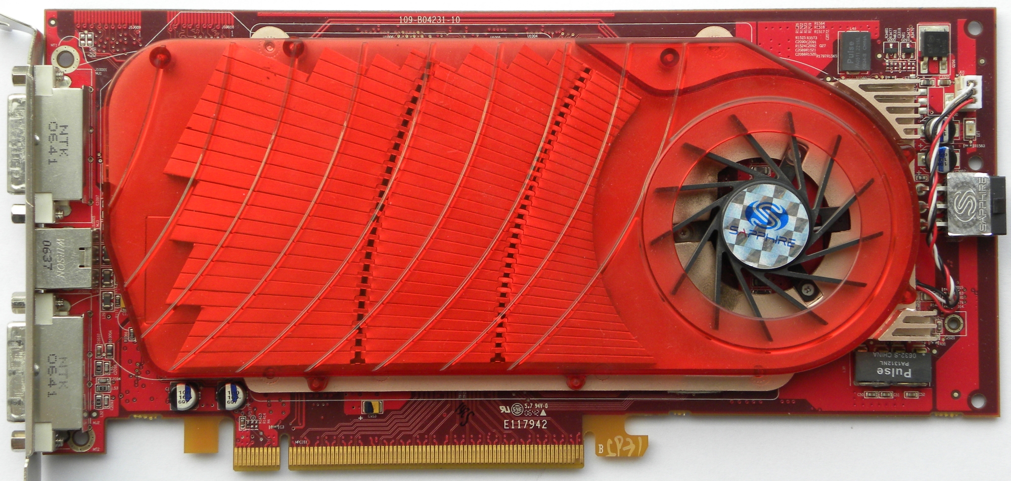

Well, I figured that if my '03 G5 is going to have a deliciously excellent Radeon 9700 Pro, I may as well go ahead and give my dual-core the same treatment, as I've wanted to do for a long while now. So, I went ahead and bought one of these:
A PC Radeon X1900 GT Revision 2, with the (as far as I can tell) improved cooling system over rev. 1. Everything else is technologically identical to what was sold for PowerPC.
A long and arduous story short, it has been flashed with the retail ATI Radeon X1900 GT for G5 BIOS available at The Mac Elite, and now works like an absolute charm, even on 10.4.11. Leopard, Linux, and BSD I have not yet tried.
The only real (minor) caveat I've come across are (mostly) green pixels scattered all over the display, plus occasional thin horizontal bars seen below:
However, these were present with the original PC BIOS, which rules out the possibility of a bad flash. Beside that, the card arrived chock full of dust and debris (plus the original paste / pads) which I have not yet refurbished out, so my intuition says that this could be a sort of thermal issue as a result, or maybe some dust bunny interfering with the circuitry in some way. It is also a rather heavy card; maybe there is too much uneven weight on the PCIe slot, even with the bracket firmly seated?
At worst case though, the performance gained from this card over the stock 6600 is worth having to live with these small graphical oddities, case in point Web scrolling being even smoother over said 6600, and fluid 1080p HD YouTube playback being just ALMOST possible in TenFourFox.
All in all, even though I haven't seen anybody showcasing this particular card to work with a G5, I can safely confirm here that the Radeon X1900 GT Rev. 2 works exactly as the original, and is a great upgrade over any of the OEM cards sold with the PCIe G5s. 🙂

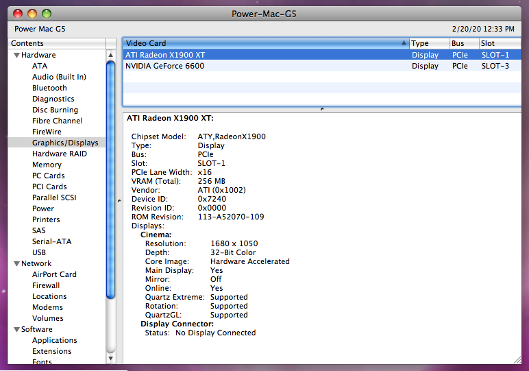

On a slightly more interesting note...
For some reason, Leopard seems to think the X1900 GT is an X1900 XT. Not only that, after QuartzGL and the rest are enabled via AuroraAccelerator, QuartzGL turns up in System Profiler as "Supported", which is not something I believe I have seen before on other cards.
Very interesting.
the artifacting/locking up is because your card is either failing or is being clocked out of spec (or both)
its nothing to do with OS X's drivers (especially if the artifacting was present before flashing)
(it shows up as a X1900 XT in OS X because it shares/uses the same framebuffer personality as the X1900 XT found in the first generation Mac Pro, note its actual name is "ATY,RadeonX1900" its System profiler thats sticking the ATI Radeon X1900 XT there)
if you want something even weirder, 7240 comes back as the Device ID of an X1950 XT, (actual X1900 G5's are like this too) so go figure that one out...

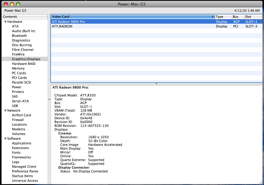

Being that I've got an MDD now, I bought a cheapo 9800 Pro for the G5, as the 9700 can just go into the G4 as an upgrade over its 9600.
So I'm trying to flash it in 10.5.8, and true to form, Graphiccelerator won't even open, and neither will ATI Multi Flasher. It's the same behavior in both safe mode and normal mode.
What a useless utility.
Now this is interesting.
I decided to take a look at the system log after failing to launch Graphiccelerator. Turns out that it's complaining about a problem with JavaVM.framework every time it opens, then closes.
I remember installing Java 6 and 7 on this OS, so I just download the switcher scripts, and run the Java 5 switcher. It doesn't work, which it has been seen to sometimes exhibit.
So then I just get ahold of a fresh JavaVM.framework from another machine's install, replace the folder, and sure enough, Graphiccelerator starts up.
So then, one flash & reboot later:
However, that still doesn't explain its failure to open when I tried flashing the X1900. That was attempted in Tiger, which I remember had an untouched vanilla JavaVM.framework. Granted, it would have been nice if the application was coded to at least tell the less-inclined user to check the system log if any errors are encountered.
That said, I do not remember checking its system log when I tried / failed, so that's potentially up for debate.
On the upside, I suppose we can walk away from all this now knowing that Graphiccelerator is NOT compatible with Java 6 and 7. It's one or the other.
Which is a good thing, because now nobody else has to go through this trial like I did in order to put two and two together.
