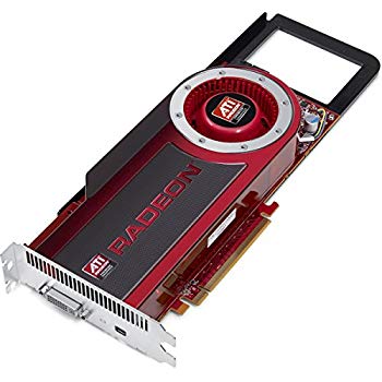

If your graphics card looks like this , you've got it made in the shade . Notice the card support at the end - it's unique to Macs . Also one DVI and one mini DP port .
That's the one. You folks at Macrumors are thorough. I have it connected to a LaCie 324 by HTML. Thanks for the info.
