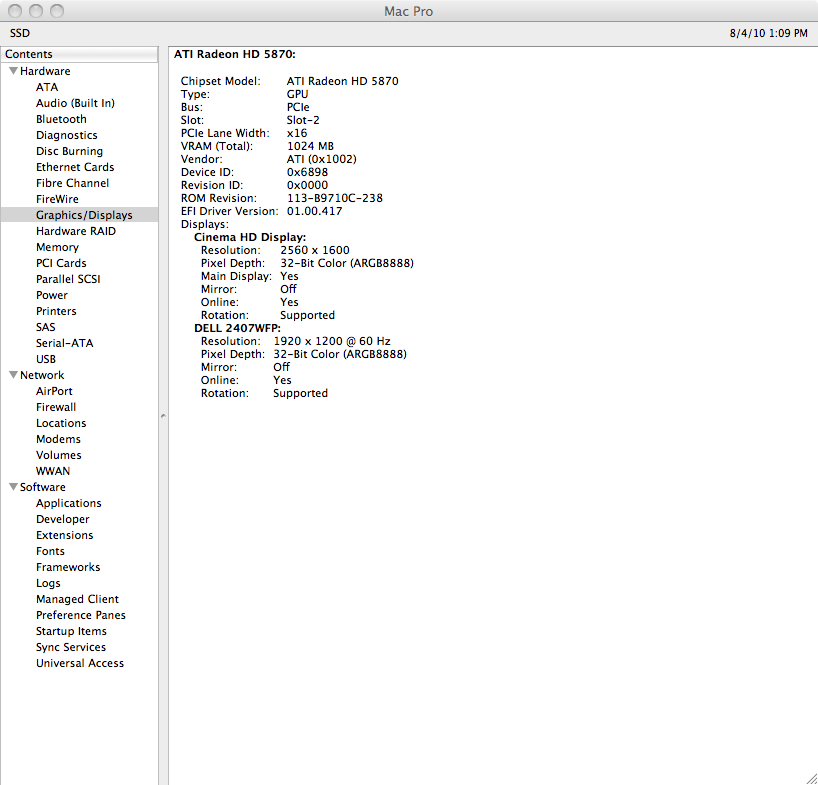

First 5870 working in Mac Pro '09 !!!
WHile I napped, Netkas wrote .
Now working !!!!

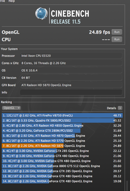

Oddly, same monitor EDID trick doesn't bring boot screen but card fires at desktop !!!
Unfortunately, the OpenGl View scores look awful, but that is due to them re-calibrating the scale.
I will do 4870 and GTX285 with new one and post later.
Meanwhile, I present the 1st Mac Pro with WORKING 5870 !!!
Congratulations to Netkas and Apple/ATI !!!

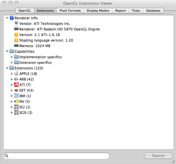

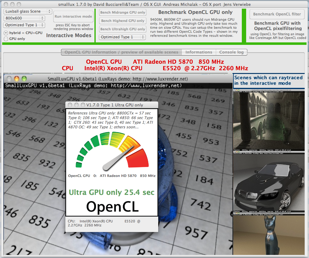

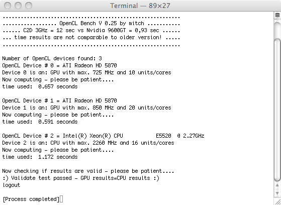

OpenCl score...NICE
Nearly half of the 5770 time...as it should be.
Gonna drop a 4870 1 Gig in now for comparison.

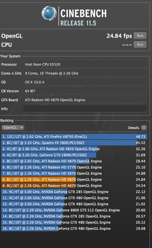

4870 1 Gig Scores to compare with

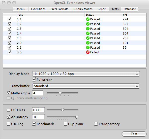

Oddly, the "new" OpenGl Viewer test shows 5870 barely faster.
Cinebench can hardly tell a difference.
But the OpenCl SmallLuxGPU can tell a HUGE difference.
I'll try these with GTX285 soon. Heck, I'll even toss in the GTX480 for kicks.
Any requests?
Don't know how to compare these now...the OpenGl benchmark seems less and less able to differentiate between cards. Not sure what they have done to it.
COD4? HL2? Doom 3?
Don't know how else to bench these cards.

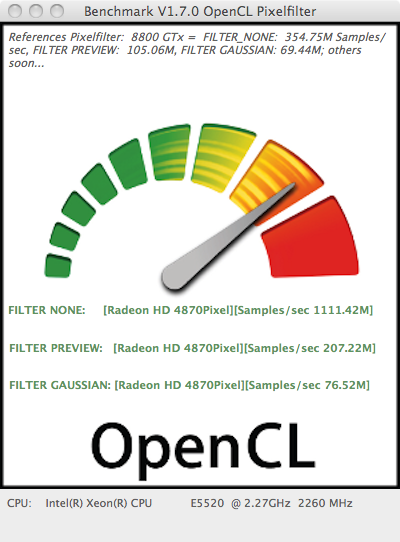

Any requests?
COD4? HL2? Doom 3?
Sorry ....Not quite ::D
HD 5770 Sapphire_Reference :
OpenCL :8,6 sec: Midrange GPU
OpenCL :34,9 sec: Ultra GPU
Cinebench_OpenGL :22,4 fr.
OEV: 200 fr.

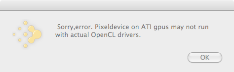

OpenCL bench (pixel_filtering) crashed as well (not supported)
OS 10X 10.6.4 Q9550ES@2,2 GHz@1,0V@GB EP45-DS4P-MacBios 0.8
