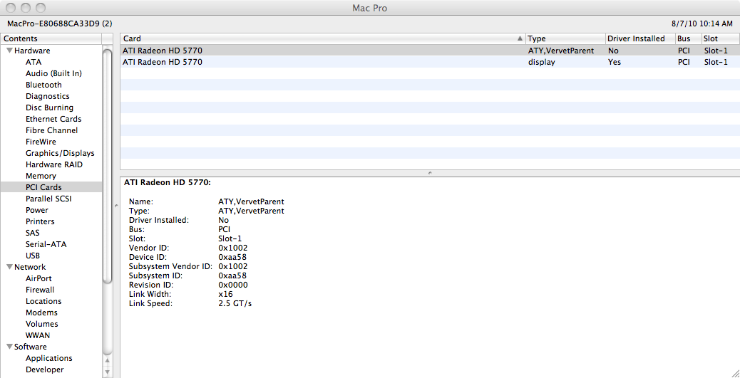

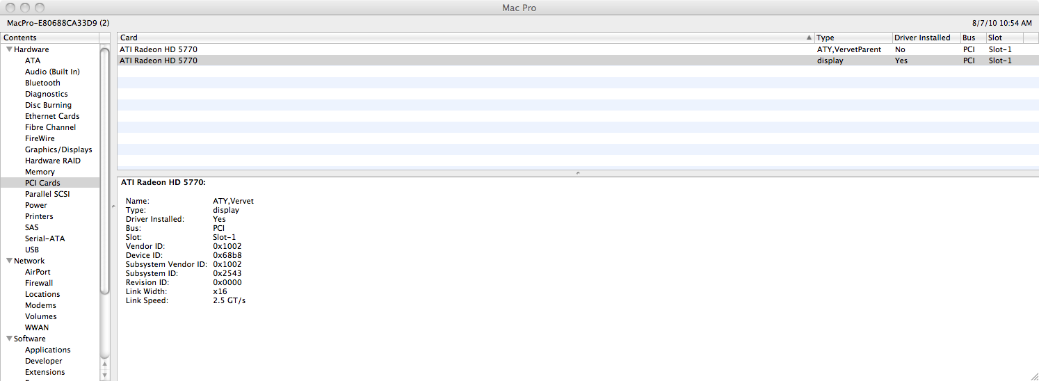

have you guys checked the link speed? Is it 5.0 GT/s?
looks like a "no" so far.
Will try with 5870 shortly and update.
in fact, on the sshot, you selected onboard audio device. :)
Yes, well, i thought people should know what speed the Unused Onboard Audio device operates at. Could be crucial info for the Unused Audio Device crowd.
