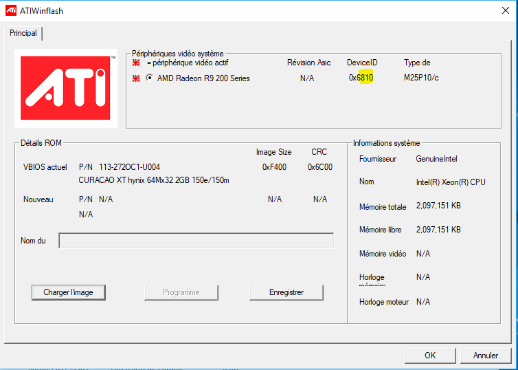

So I put the card in the mac pro booted Windows 10, I extracted the original BIOS and the Device ID using ATi Winflash (see deviceid.png)
I erased a usb key, downloaded the bundle from netkas forum (http://forum.netkas.org/index.php/topic,5619.0.html)
extracted it to the usb key, copied the original SapphireR9270XToxic.rom I saved from ATi Winflash to the key.
Then I went to my mybook pro inserted the key and executed the script
./makerom.sh --efifile=7950mac.efi --romfile=efiromheader.rom --originalrom=SapphireR9270XToxic.rom --devid=6810
this generated the SapphireR9270XToxic.rom.efi.rom without any error
So i took the usb key back to my pc and flashed my card using ATI Winflash with the SapphireR9270XToxic.rom.efi.rom

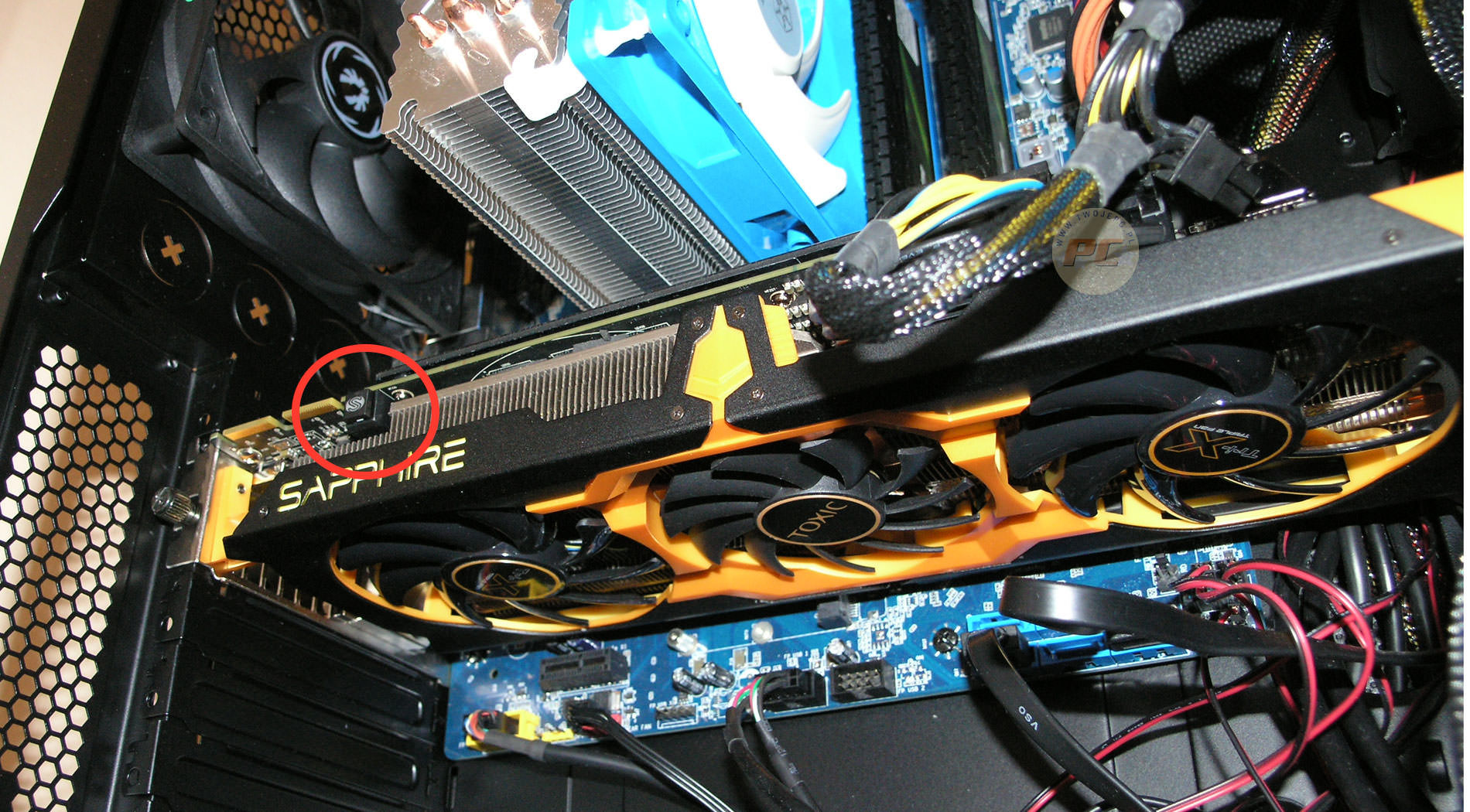

This should be the ROM switch. You can check your manual, or simply try press it and see if it will boot from another ROM.
Hi Yes , tested and working
I put the mac rom when switch is off and the original UEFI Bios when it's on
So when it's on Windows Work perfectly and When it's off it is for the mac boot
So know I've to concentrate to have a working mac rom

I forget now but you should check the "Product I.D." I think it is 679a and use that in the Netkas script.
Try this in the netkas script ( use the 7950macefi )
/makerom.sh --efifile=7950mac.efi --romfile=efiromheader_7950.rom --originalrom=cardname.rom --devid=679a
BOOM! We now have a flashable 270x PC GPU, with all the ports working. Funny thing is, Fl0r!an gave the pro tip about a year ago, but the OP either failed or didn't give proper feedback.
