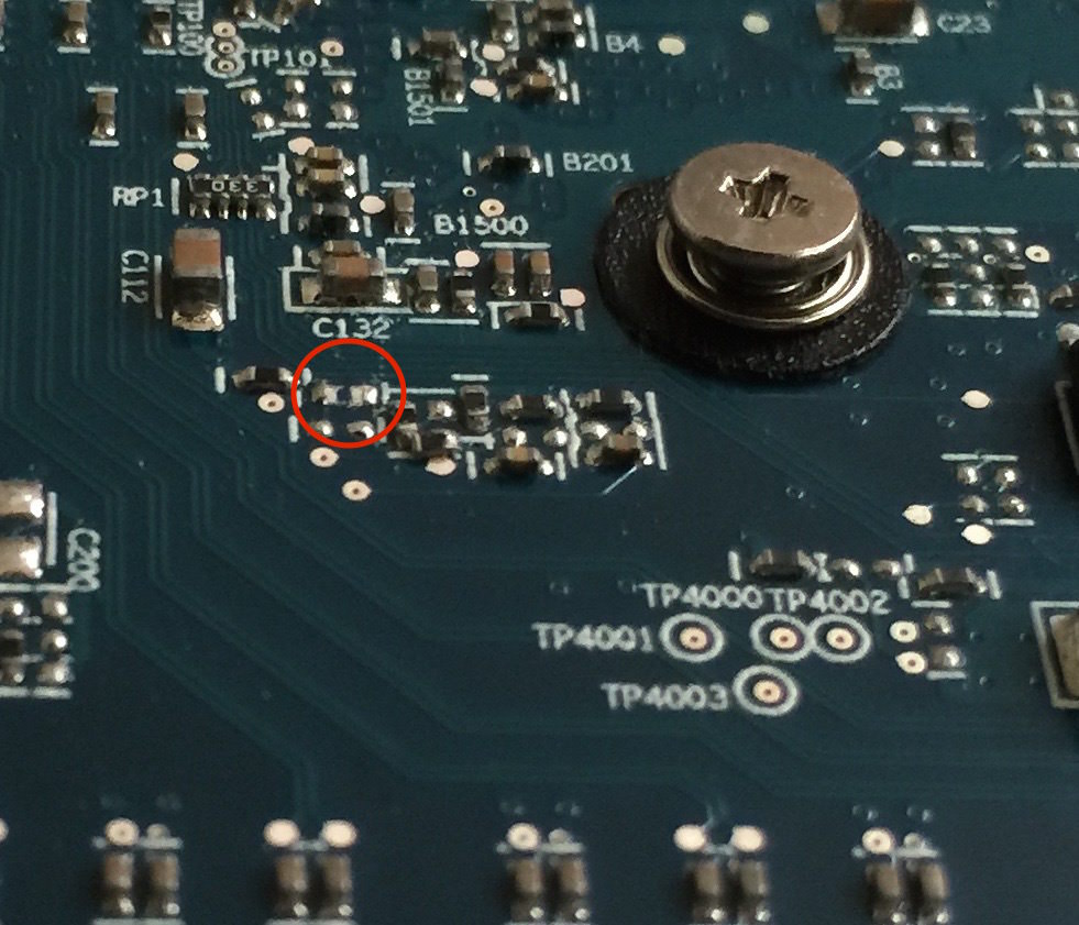

Removed R17 - it's more like I destroyed it. Still at 2.5 speed. Weird?
I read here and there (Netkas) that some people remove R17 and then use a graphite pencil to make contact between its two connections. Whilst removing a resistor cuts a circuit, putting graphite does the exact opposite... What's right, what's wrong?

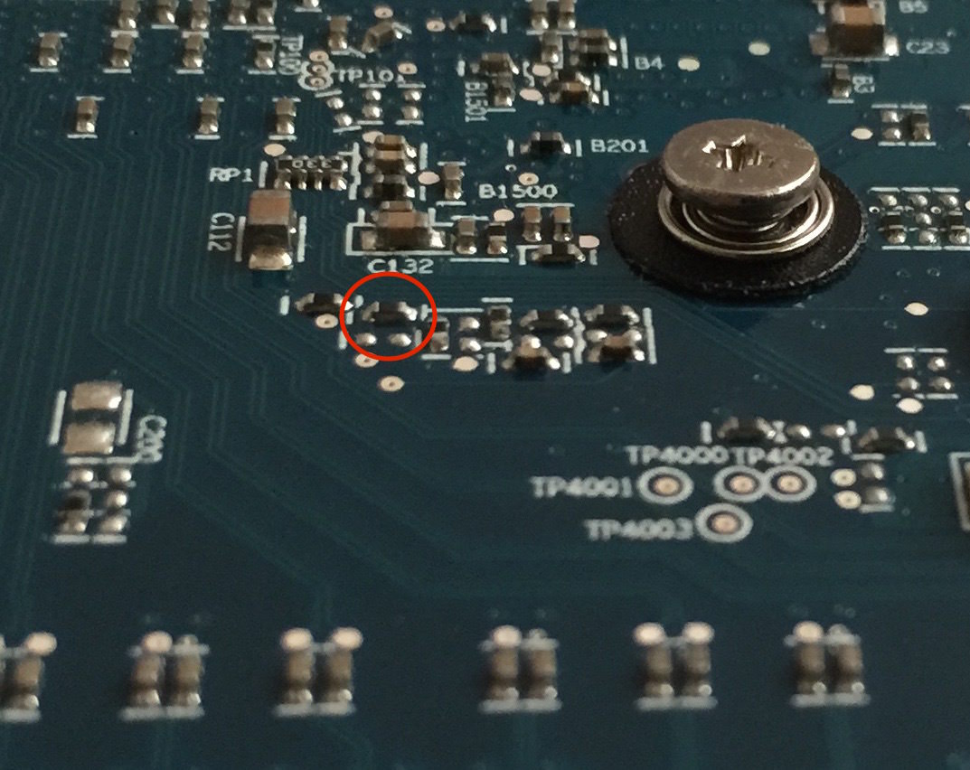

Update: PCIe 2.0 mod completed (R17 removed)
I simply use a tiny screw drive and apply some force back and forth few times, then the R17 pops out in 30s. The process is simple and much easier than I expect. There is no R17 marking on this card. However, it's at the exact same location as the reference HD7950. The only caution is that DO NOT apply too much force. The join is not that strong, if you use too much force, when the R17 pops out, you may unable to control the screw drive and damage some other components.
This is the actual screw drive I used.
No R17 marking, but exactly the same location and layout as the reference HD7950.
The R17 pops out and fly away, I have no idea where it is now.

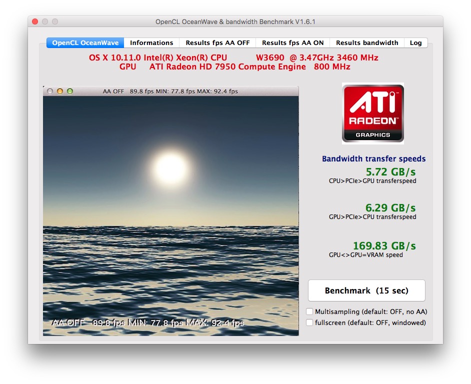

OceanWave confirm that the card is now running at 5.0 GT/s range.
